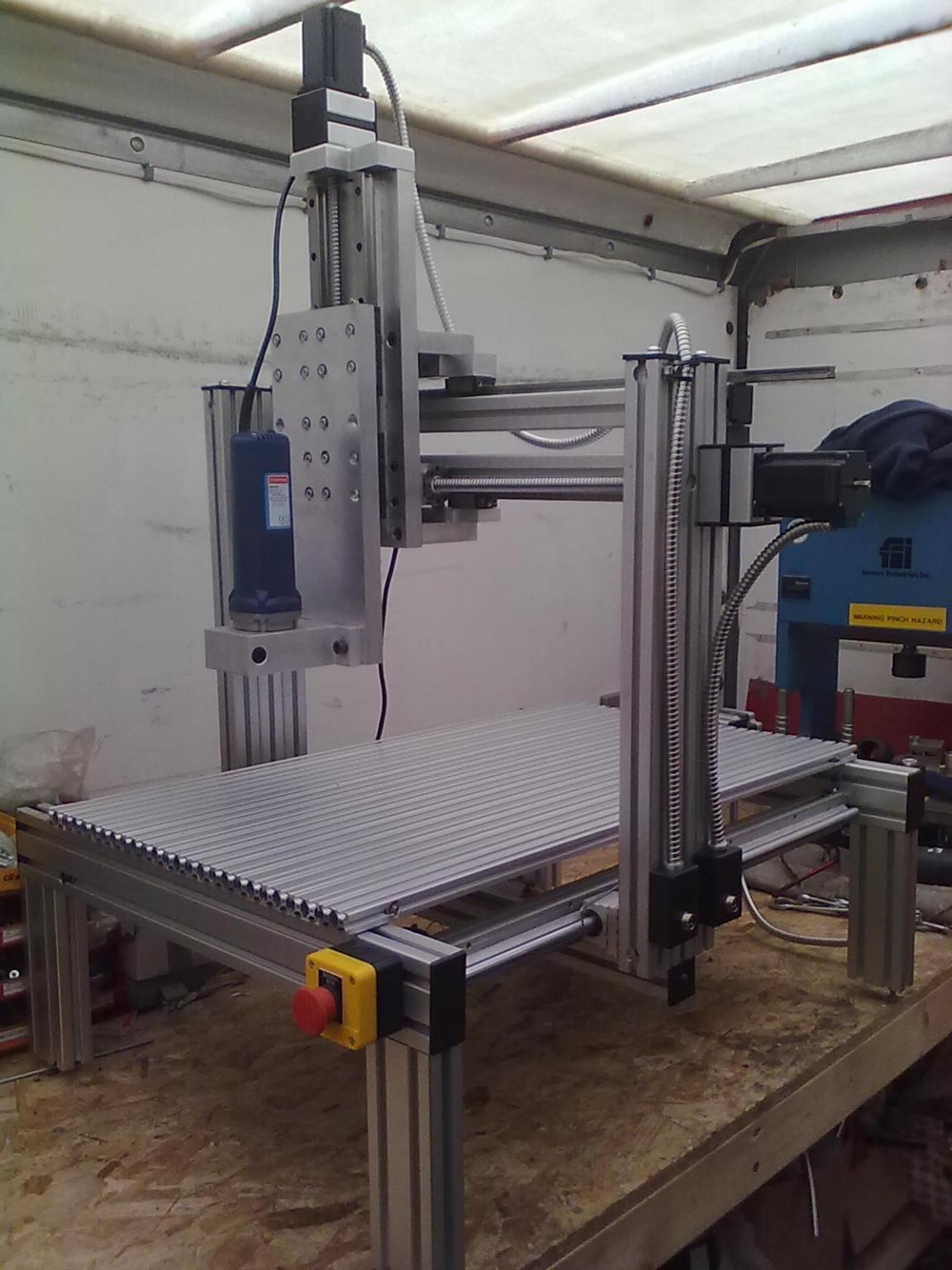

    like many people i started buying things for my futuer router without knowing what i needed i ended up with a mix & mach of the wrong stuff classic mistake i now know! i only wish i had you guys to guide me in the first place. Its now over 1 year on with very little time on my hands i have settled on the x3 zapp motors x2 zapp drivers & the routout board on the Z but with the Z motor in sereis
    im useing x1 of the 50V psu for the X & Y axis & the 24V for the rout out board
    i have also got a 4th axis i want to use with a rout out board
    eventually i want another 2 zapp drivers for the Z & 4th axis & use the other 50V psu for the Z & 4th axis but i have to make do for now
    my router it is 800x600x200
    it has 600mm thk railson the Y 400 thk rails on the Z & fully supported rails on the X
    also has 16mm ballscrews on each axis & t nut table
    regards to the electronics side of it am i doing it right with what i have got? or would you guys do it another way? please dont hold back i can take constructive critisisim, the builld has been fun untill now when i get stuck

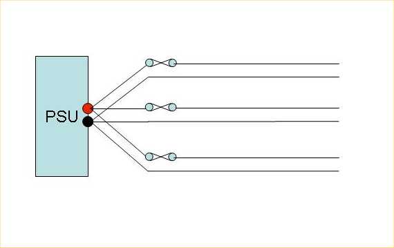

    in you link you kindly provided with regards to the wiring ,the fuses going from the drivers, are 5A OK or should the be lower? also how are the 2 PSU connected together?
    thanks again

    Hi Mike,
    The PSU’s are wired in Parallel, the earth going from the PSU’s (green) to each driver housing is done with a star arrangement.
    Do not daisy-chain the fuses back to the PSU; wire them individually as per the diagram.
    Fuses are rated at the current they will carry without blowing, which should typically be 25% higher than the highest current you expect to encounter. Generally wire should be rated 50% higher than the expected maximum so that the fuse becomes the weak point.
    Also for high frequencies and for systems where there are fast transients (like a stepper driver) stranded wire is better as high frequencies travel in the outer skin only, so more strands gives a better result (more surface area).
