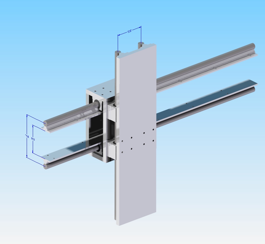

    Is aluminium/steel box section straight enough to mount a supported linear rail on opposite sides and expect it to run smoothly without binding.
    Here's an example to clarify. I'm thinking of putting a piece of 100x50 box section between those two horizontal rails.

  2. Depends on the spec... and how it was manufactured.. Extruded may well be, welded steel box section maybe not, might need a pass with a mill..
    'Pass with a mill'
    Skim it with a fly cutter on both sides? What about the internal stresses in the material, is that going to be an issue?

    Assuming the rail is straight and if it's only a few tenths here or there you could use a thin layer of epoxy.
    Extrusions are very accurate, either profile Ali or RHS Ali section. Bit more expensive than steel, but alot of steel is ERW (electric resistance welded) with a seam down one side. I remember reading a post where they wished they'd skimmed the steel section before mounting the rails. Factor in the cost of getting two faces ground and the Ali profile is your best bet.
    By the way, in your sketch showing the box section assembly wrapped around the gantry this could probably do with a slight re-arrangement. As drawn the top and bottom plates fit on top of the sides. This means that the sides have to be very accurately cut to get a nice just-right preload on the bearings.
    If you make the sides longer, and have the top and bottom plates inset, then the play in the bolt mounting holes (~1mm in total up and down) which are now in the sides and not the top will allow you to put it together better, and set the system up with just the right load. Otherwise you risk either squashing the bearings or pulling them apart.
    Thanks for that. I reckon I'll go for 80x80x3mm aluminium box section then. There's someone selling it near me for £20 per meter. That does make the centre distance of the Y-rails only 134mm - is that OK?.
    Excellent point about the bearing preload - that's probably saved me a lot of hassle! I'll change the drawing now.

    Are you using the rails back to back on the y axis to counter the uneven load distribution? (ie 25% reduction at the open side) if so have you looked at doing the same with the zaxis? if you mounted them on a c channel (or box with a slot cut out, then you would have space for the Drive screw as well)
    Exactly.
    I looked at it, but didn't think of using C-channel which would make it quite simple.
    The place near me has some 3"x1"x0.25" aluminium angle. There's also U, 2" x 3" x 2" ... only 3/16" thick though. Time for some more drawing / calculation!

    This is what I was looking at, the idea was that the two horizontal box sections top and bottom with the c channel and vertical box in the middle would provide a pseudo I beam but with improved torsion due the central box, the c channel would house the Ball screw and there fore keep the z axis in tight to the gantry
    The idea for the z axis was similar in that the spindle and hence cutting forces were in close to the gantry and the back to back rails to give an even load distribution. I figured that a wider z carriage was acceptable as the increase in rails needed is marginal compared to the bearings.
    Anyway thats as far as i got and I know there are many improvements but hope it of some use or sparks another idea
