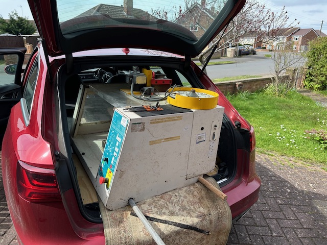

    Of course collecting it was a challenge as it would only just fit in my car!

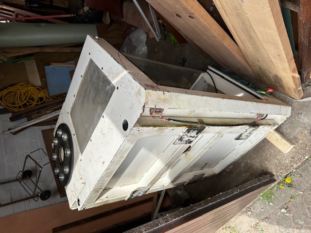

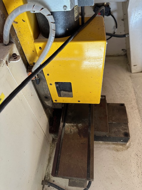

    If you are considering purchasing one of these mills be warned they are pretty heavy at around 200 - 250Kg, I was lucky in that the machine was located on a farm and the seller had a forklift to get it into the boot of my car. even then it was pretty hard to get it in. Even harder to get it out at the other end.
    My original plan was to strip it for parts like the vice and tool holders and sell the rest. But under the rust and muck it looked like it might make a nice machine.
    First the bad bits:-
    Rust everywhere, the cabinet was peelings and rusty so was everything else.
    Electronics, 1980s drives and spindle. Spindle drive and electronics had obviously blown up at some point!
    Other bits I did not know about until striped, Like spindle bearings shot, and very wonky Easy change chuck!

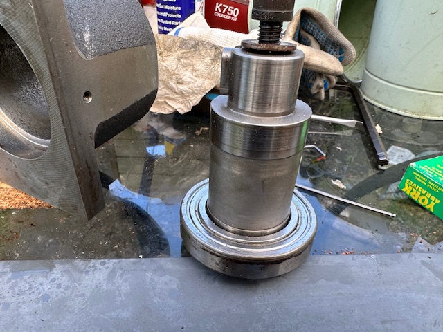

    Above the spindle removed from the head, the bearings are are just deep grove ball races so these will be upgraded to angular contact bearing of the same size.

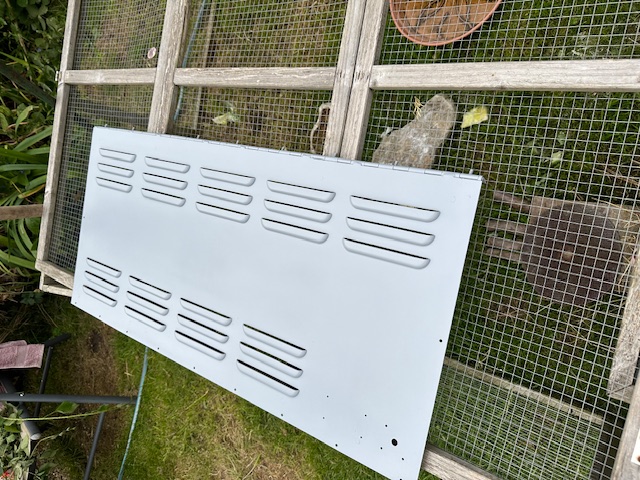

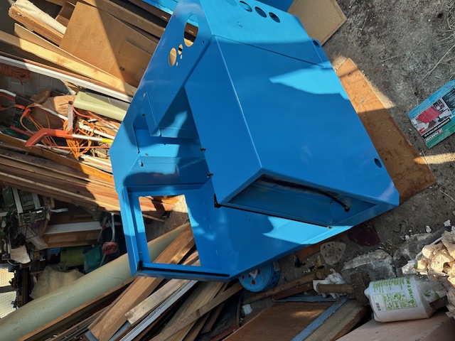

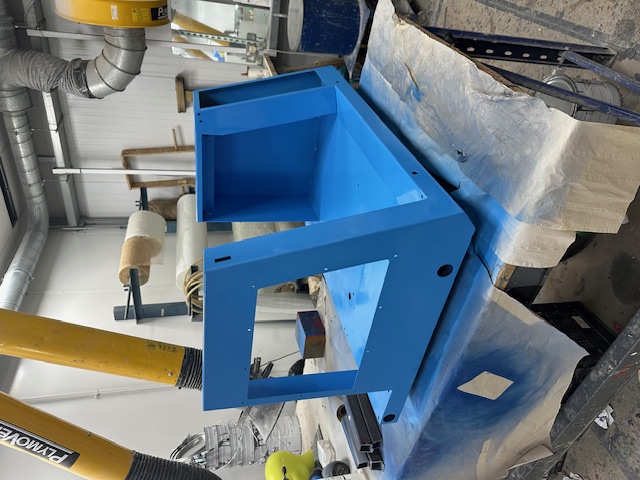

    Below are pictures of the Cabinet parts, clean up and painting.

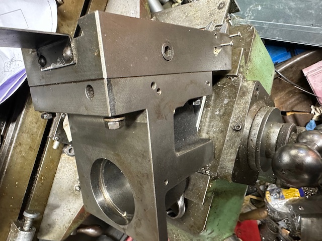

    Right, if you’re thinking of picking up one of these mills, there are two key things to check before you part with your hard-earned cash:
    Is the spindle running true? (Mine, er, wasn’t.)
    How much backlash is lurking in the ball screws?
    I’ll admit, I didn’t even think to check the spindle (not that it was important for the what machine cost). I’ve never come across a machine with such a wobbly one! The spindle itself was alright, maybe 0.005" out, but the Coventry Easy Change master holder fitted to it? A ridiculous 0.2mm off true. Pop a tool holder in, and it’s like watching a wonky spinning top. My first guess was a proper crash—someone giving it a right wallop. But I’m not convinced. The holder’s not shaped like it could bend easily, and the error was consistent along the taper. Feels like it was machined eccentric from the get-go. This being a late ‘80s model, ringing the manufacturer (still trading, mind you) for a refund was a bit optimistic.
    By this point, I’d poured too much time into this project to chuck it in. So, my options? Shell out a few hundred pounds for a new master chuck body or try to salvage the dodgy one. Problem is, the body’s hardened to 55-58 RC, so turning it was out. Time for some workshop bodgery. I 3D-printed a mount for my Metabo die grinder, turned a mandrel on the lathe, and draped my trusty S&B Model A in as much protective cover as I could. Then, I set to cylindrical grinding the outer taper of the master chuck, this time true to the bore. The finish came out surprisingly decent, but I’m not keen on making a habit of it—my lathe didn’t sign up for this!
    End result? Runout’s down to about 0.01mm, maybe a tad less. Not bad for a bit of shed engineering. Anyone else had to wrestle with a spindle horror show like this?

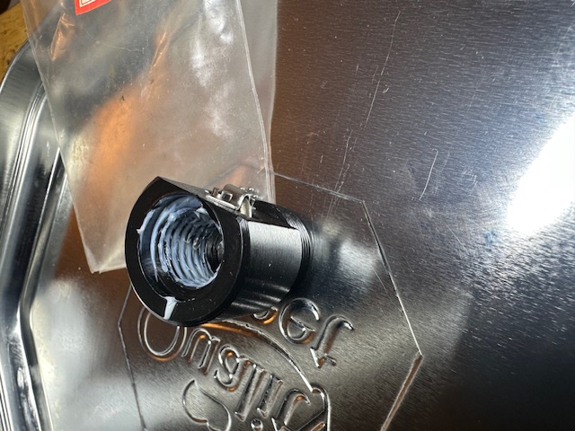

    Well, the spindle was a right faff, but the ball screws? No surprise there. These VMC 260s have a bit of a reputation for knackered ball screws. They’re 14mm with a 2.5mm pitch, and to top it off, they’re overhung with no end support. The single nut uses tiny 1.6mm balls, so the load rating’s a bit on the skimpy side. Finding replacements? Good luck. The nut’s a screw-mounted type, not a flange-mounted one, which are ten a penny.
    Once I’d got the machine back together and wired up for a test, I braced myself to see how bad things were. The X-axis was the worst offender at nearly 0.18mm backlash. Y-axis wasn’t far behind at 0.09mm, and Z was the least awful at 0.05mm. I did track down a Chinese supplier offering rolled screws for £90-100 each, plus shipping. But knowing my luck, the replacements would probably be dodgier than the originals. So, I thought, why not have a crack at re-balling the ones I’ve got?
    I started with the X-axis screw, dismantled it, measured the balls, and ordered replacements. When they arrived, the real fun kicked off. Those 1.6mm balls are so small they vanish the moment you drop one—like they’ve got a personal vendetta against you. For the first go, I meticulously counted out the exact number of balls from the old screw, then counted out the same number of new ones. Sounds simple? It’s not. After thoroughly cleaning the nut, I packed the grooves with ball screw grease and, with the patience of a saint, placed each ball into the grease. This took forever. Once all the balls were in, I slipped in a turned nylon filler rod to hold them in place temporarily. Fitting the screw back was a doddle… after a few practice runs, mind you. The result? Backlash down to less than 0.01mm—good as new, if not better.
    The Y and Z axes were a breeze by comparison. I ditched the ball-counting nonsense. Instead, I slapped as many balls as I could into the grease, popped in the filler rod, held it just past the return path tube, and kept feeding in balls until the track was full. Worked like a charm first time and took about 20 minutes per screw. Piece of cake, really. Anyone else tackled ball screw woes on one of these? Or am I the only one daft enough to try?

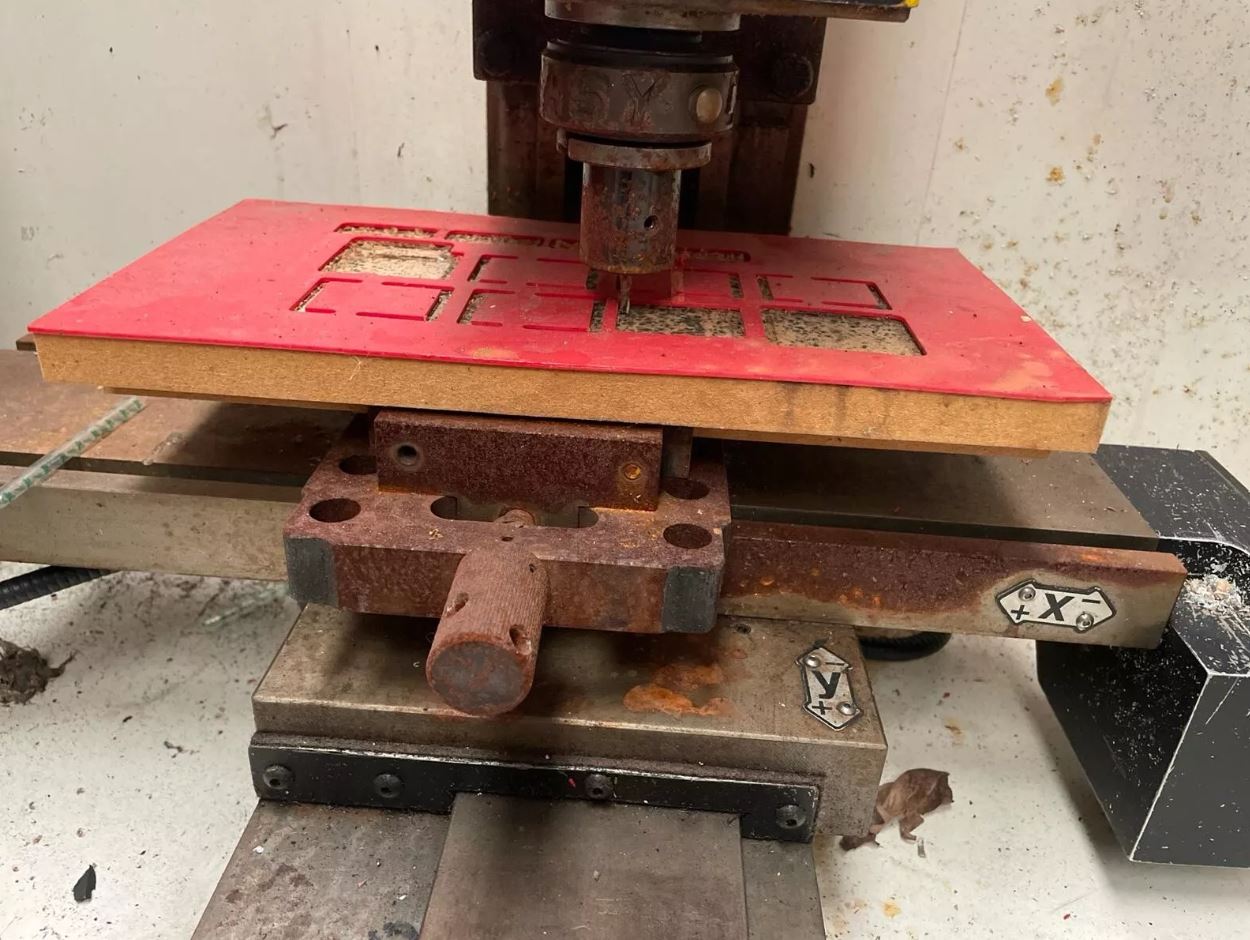

    With the rogue ball screws sorted and the wonky tooling tamed, I turned my attention to the control panel. The old one was a sorry sight—rusty and bearing scars from what looked like a minor electrical tantrum. Several components on the back had, shall we say, “vigorously disassembled” themselves at some point. The new panel needed to be a proper job: an MPG dial, feedrate and spindle override controls, plus manual switches for spindle and coolant.
    After measuring the old panel and unceremoniously binning it, I fired up the CAD software and faffed about until I had a layout that didn’t offend my sensibilities. I sent the design off to have the panel laser-cut from 1.2mm 304 stainless steel. When it arrived, I dug out my home-brew 40W CO2 laser to engrave the markings. To get a proper finish, I used Ceramark laser marking spray—spray it on, let the laser work its magic, and it fuses into the surface, leaving a crisp, permanent black engraving. Not bad for a bit of shed tinkering, if I do say so myself. Anyone else had to resurrect a control panel from the grave? Or is it just me battling these relics?
