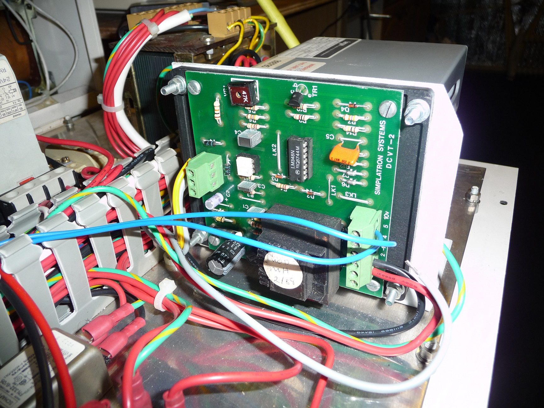

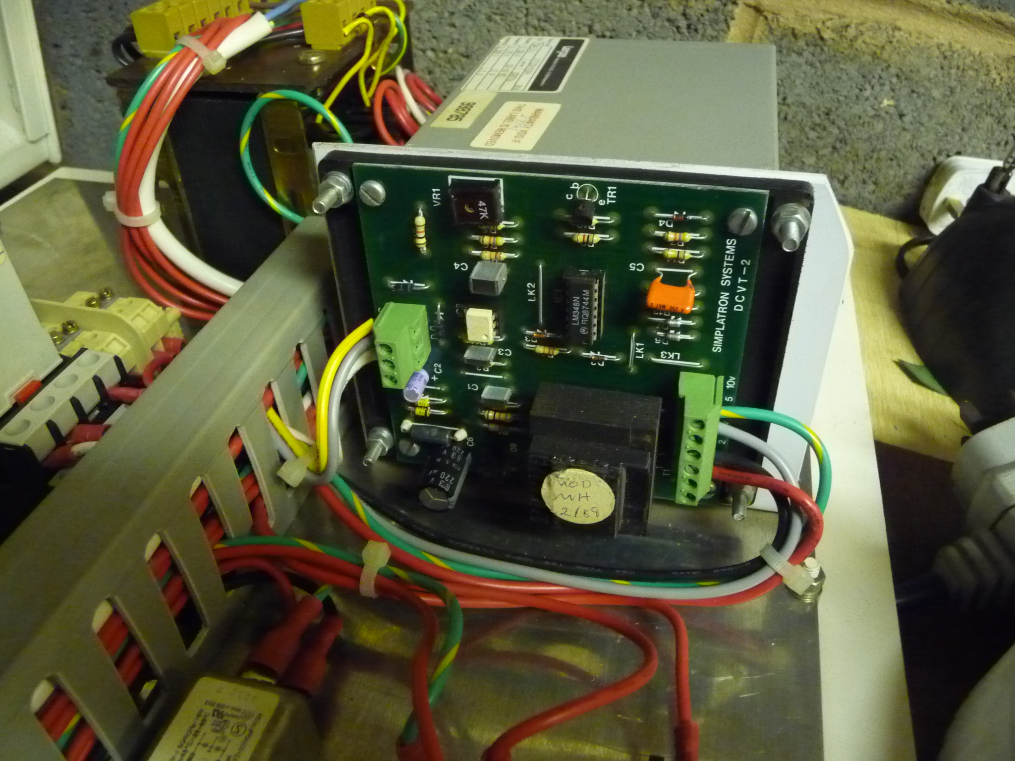

    Hi Jazz,
    I have only re-visited the setup of my machine and last week I bought the full version of Mach4 which I now have setup. You stated in your last reply that I need to control the relay to switch polarity of motor. There is a relay on the original board for which if the direction and the 0v wires are connected it flicks the relay over and initialises reverse direction, it would be great if I could work out how to incorporate this switch within the 107. So I suppose my question is should I be using the original relay off the original CNC board or should I use the relay on the 107? If it's the relay on the 107 I dont understand which wire connects to which terminal on my power supply board (simplatron). Looking at the power supply board it does have 5v and 10v but no reverse option so I assume with my current setup the only way to get reverse is via the original relay unless I strip all this stuff out the machine. I attach a couple of photos, the one shows the original wiring the other shows my new wiring (temporary blue wires). Would be nice to hear your thoughts on this.
Name:	New wiring for Simplatron.jpg
ID:	17394Click image for larger version.
Name:	Simplatron Systems DCVT-2 Board.JPG

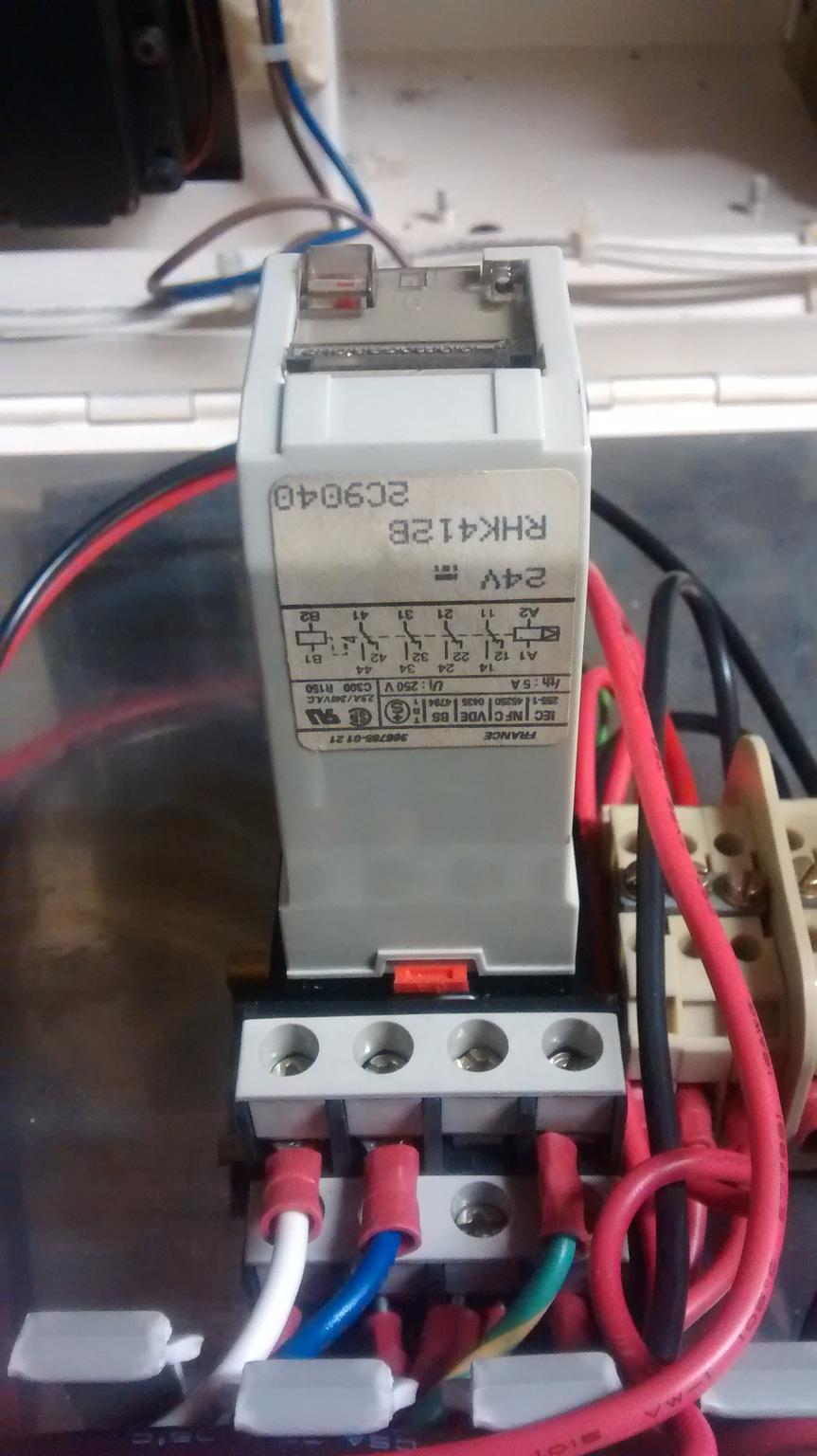

    And reversing switch which works (when I join 0v and direction wires).
Name:	Reverse Switch.jpg
    Steve
  7. #37
    The white relay is switched via one of the three clear cap relay in the row
    with the Lenze drive. I don't know if the middle or the right relay is for left direction. The first is, if the machine doors are closed.

    Quote Originally Posted by swood1 View Post
    None connect to the Simplatron board other than 0-10V signal. Control the White Change over relay using the 107 Relays which are controlled Via Mach3 M3/M4 switching the Outputs.
    I suppose the Clear Cap relays Uli12us mentions where controlled via the original control software using standard Outputs. Your just replacing those with the ones on 107 which are just connected to dedicated relay Outputs on 107 controlled by Mach3.
  9. #39
    the white relay RL1 is controlled from one of the 2 relays RL3 or RL4.
    these two ar controlled from the main board with the large connector with 12 or so pins. Unfortunately at my machine something is wrong at the moment, the motor turns only left or only right. I must find out why, but not before next week.
