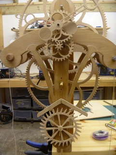

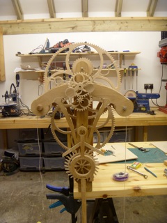

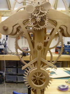

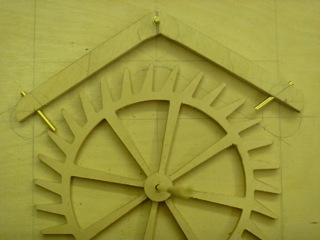

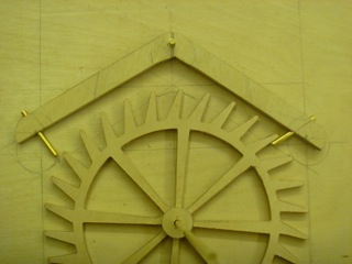

    Hi I have just created a deadbeat escapement gear for my clock. Up to now the clock was hand built, but I wanted to take it further so I used a program to generate the gear and then created the g code and here it is, quite proud of myself
    Now with finished article too. Now time to design the escapement mechanism

    Hi, well the clock finally ticks and tocks too, now to sand it, stain it, and put it on the wall, as you can see the dead beat mechanism now works!
