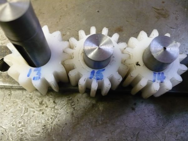

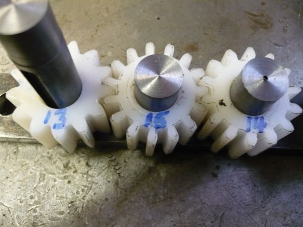

    Also does spur gears. I did two 14 teeth gears and put them on pins at the correct centre distance and they run fine.
    I then did two more blanks, exactly the same size and modified the tooth shape to cut 13 on one and 15 on the other.
    These gears will chop and change onto any pins and run in any order.

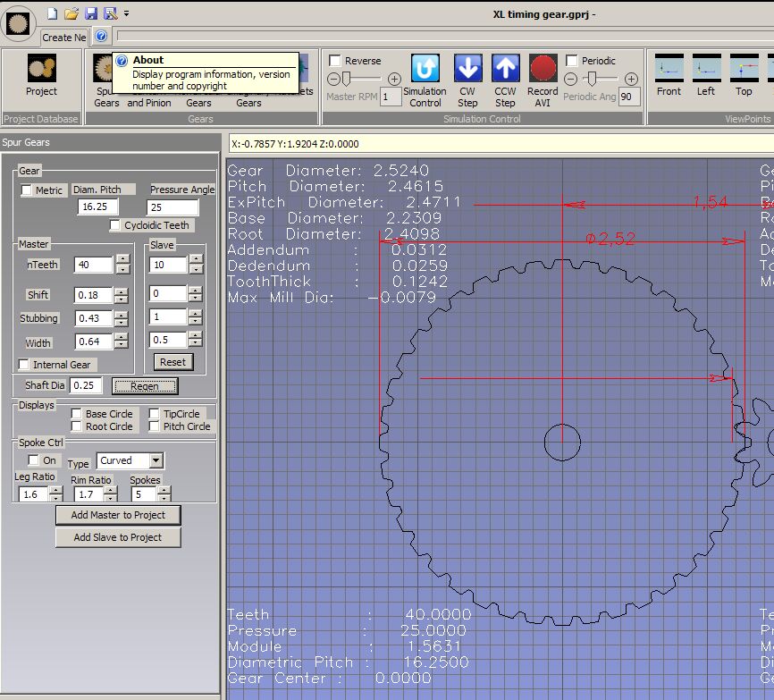

    I drew a 40 tooth XL series timing pulley up in CAD [ with the help of Mr SPI Industries ] and got some measurements off it.
    They went back to Gearotic [TM] and juggled some figures.
    So if we use 16.25 DP we get an OD of 2.5240, we need 2.5240, OK so far
    Then play with shift, stubbing and tooth width we get a total depth of 0.0571, we need 0.0550, 2 thou too deep, think I can live with this.
    Tooth width is 0.1242 and we need 0.1240, even closer.
    Now bung the dxf onto the original drawing and it's within a gnats left bollock.
    It's still early days on this program but so was Mach3 at one stage and look where it is now.
    Once saved all that is needed to make any XL pulley is to change the number of teeth.
