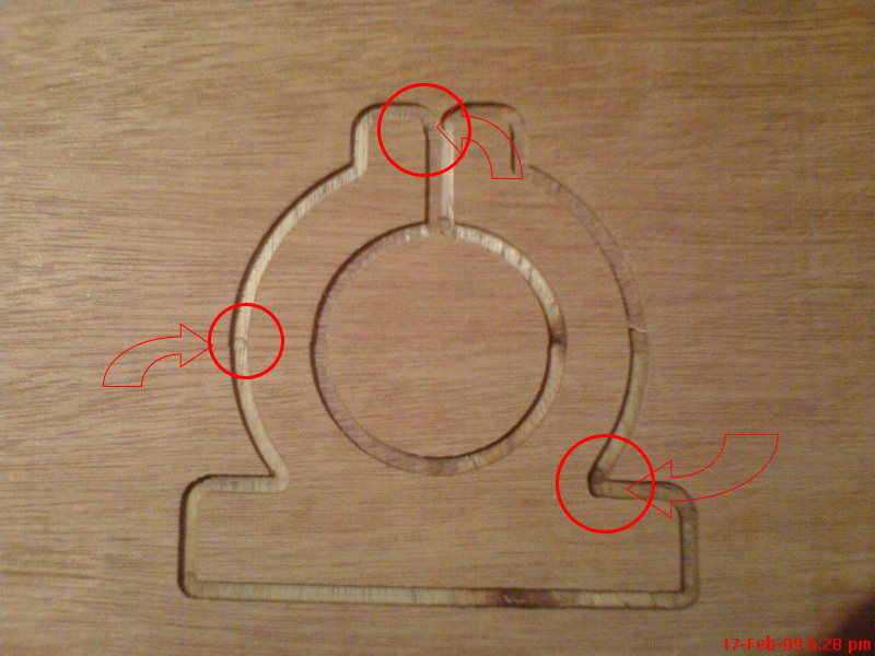

    An MDF machine dose have potential, below is some of the first cuts I did with mine:

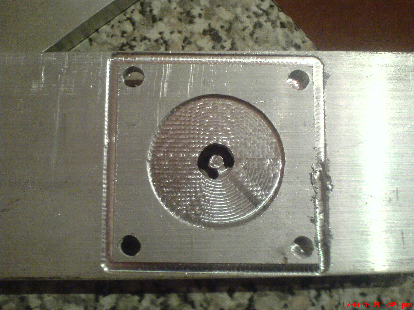

    Next is my attempt at working with some Ali, apart from the obvious in the picture when the cutter got stuck it also spilt the Z Axis plate right down the middle. In the above pic I was “having a play” with the spindle speed to see what would work and what wouldn’t, when the cutter got stuck it had just gone into the next plunge, for a deeper cut and I had increased the spindle speed.

    Everything got jammed up as you can see in the pic and it more or less ripped the machine apart. With that I stripped the machine down and burnt all the wood :lol:.

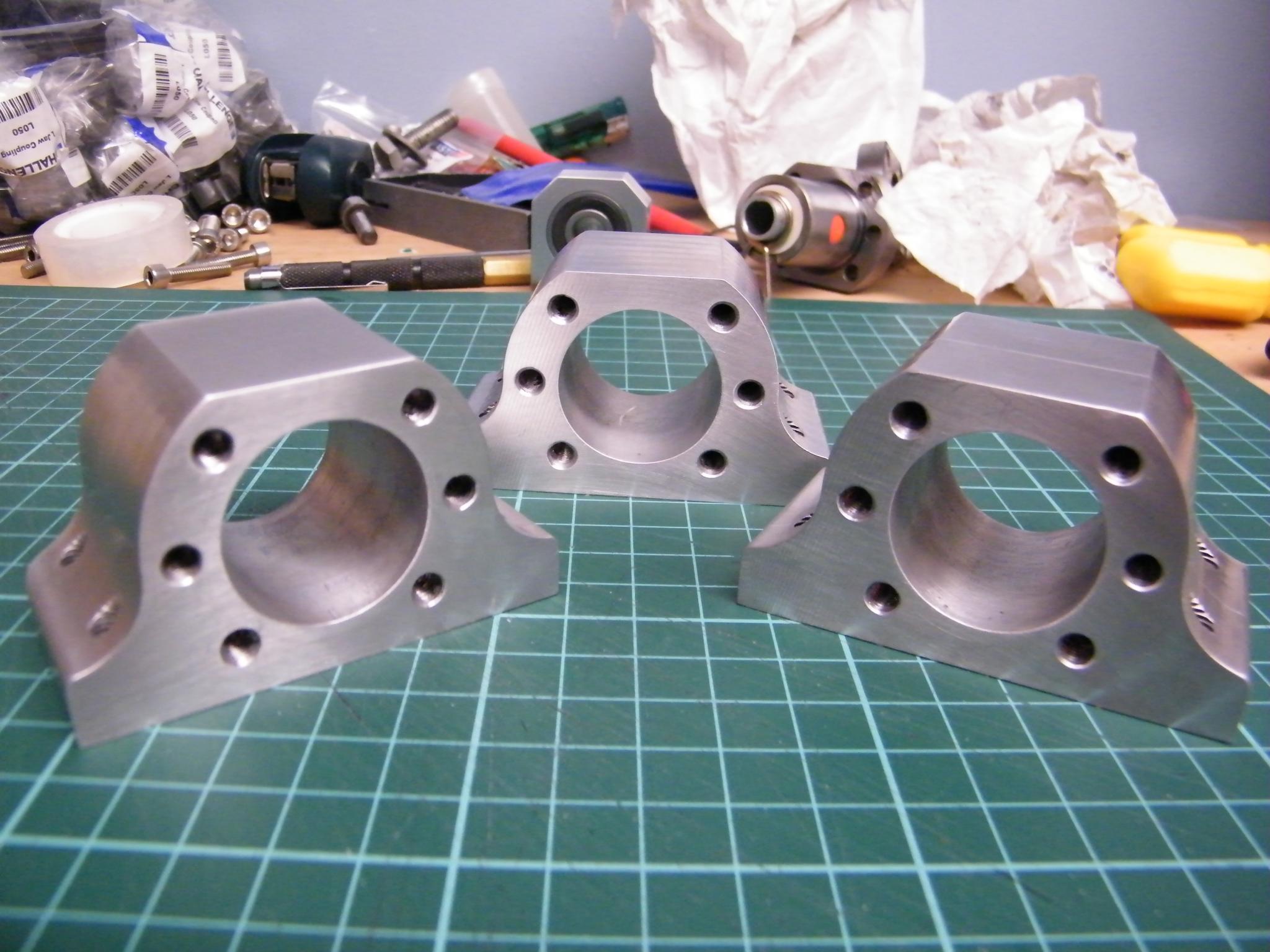

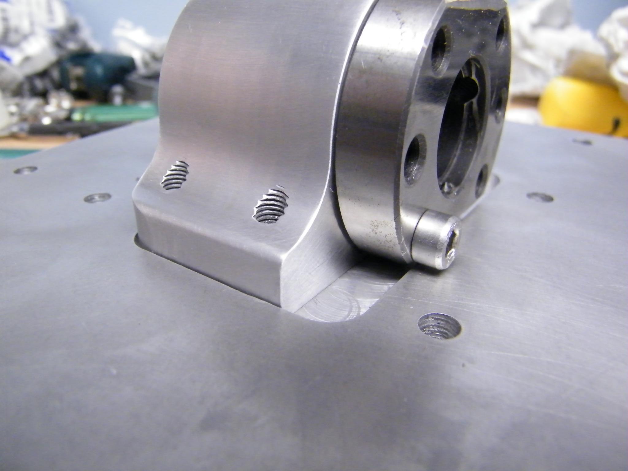

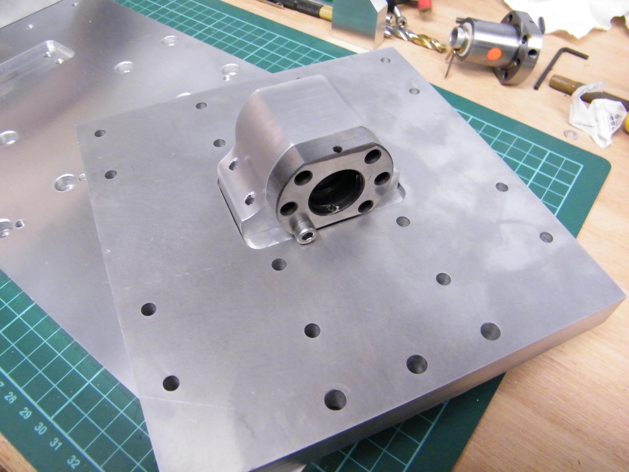

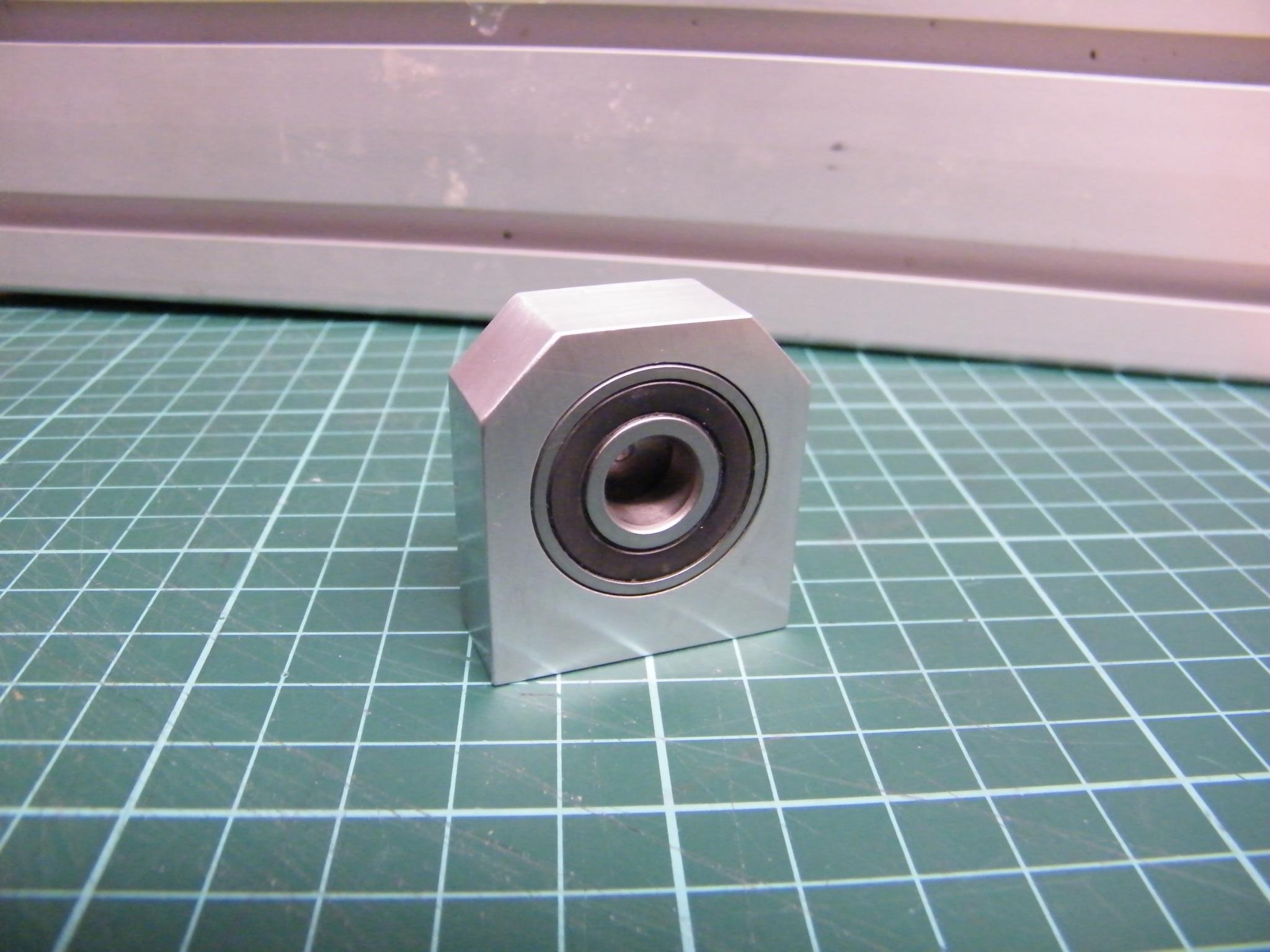

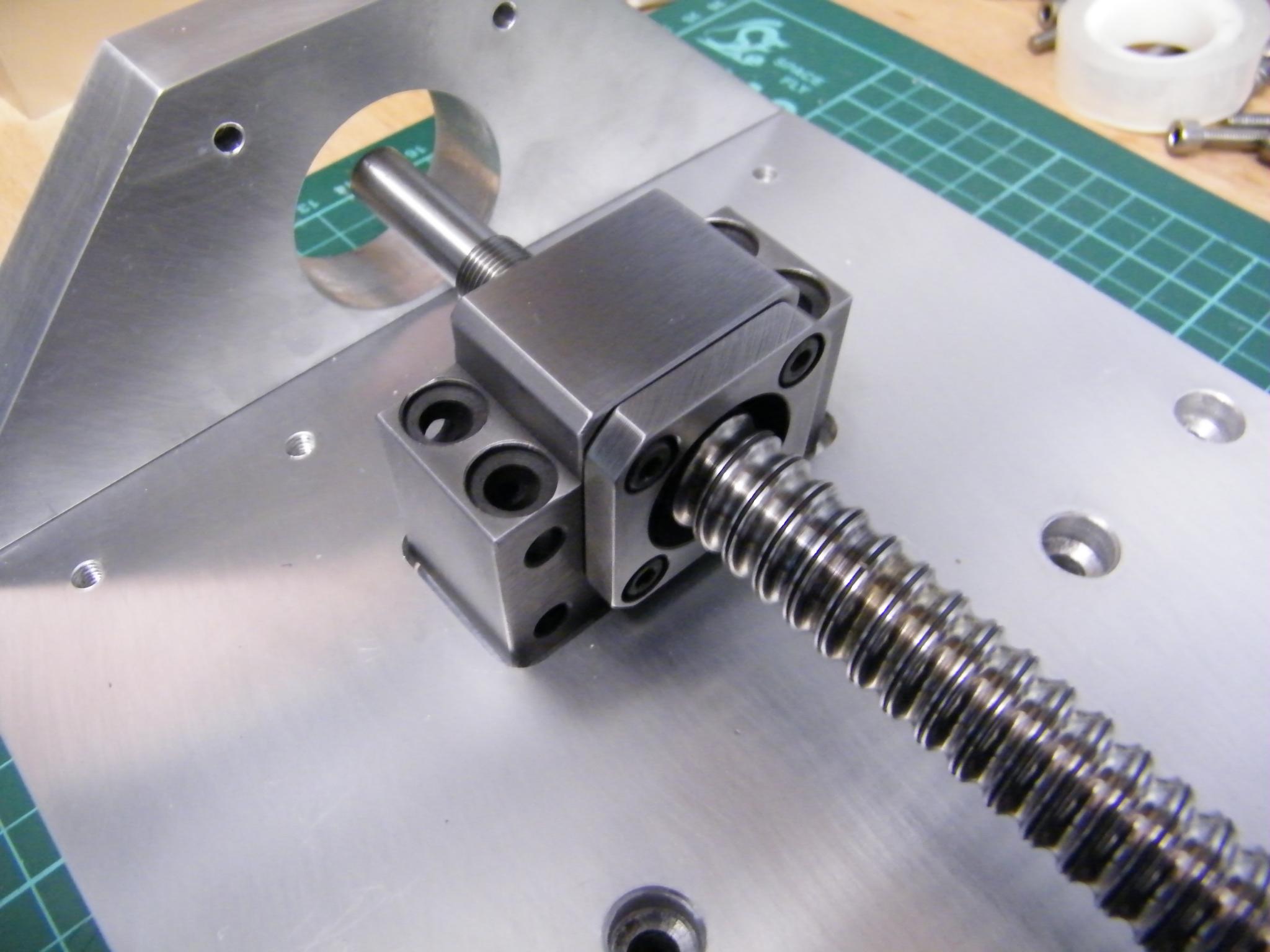

    Time for some inspiring photos me thinks

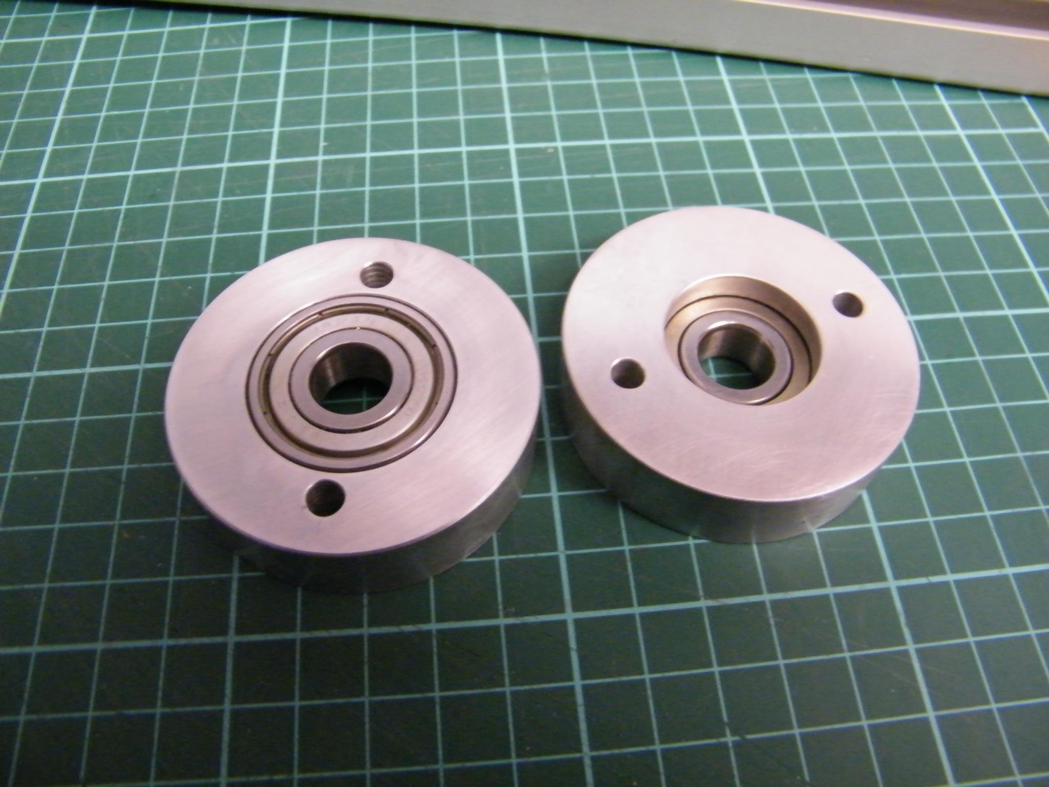

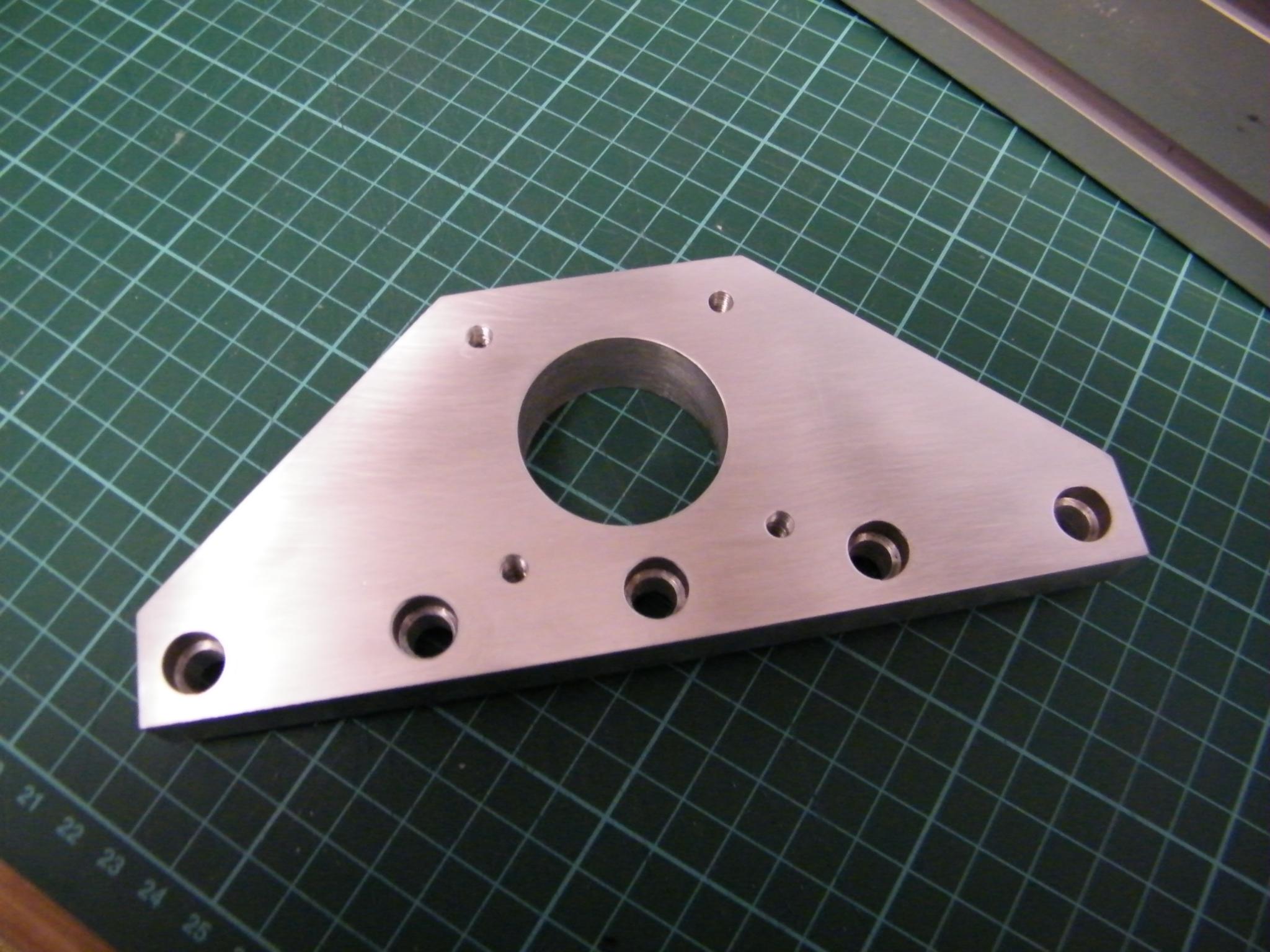

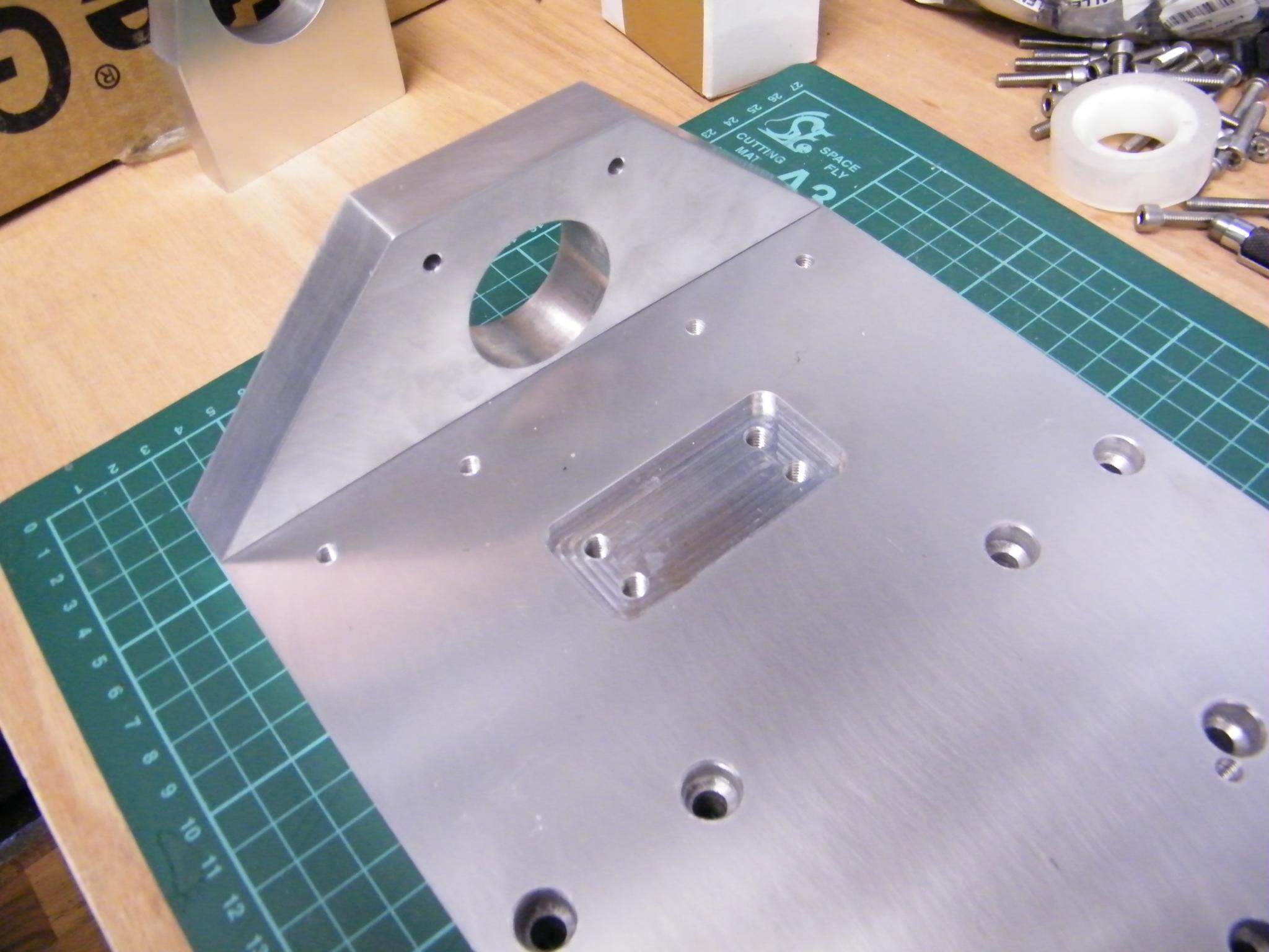

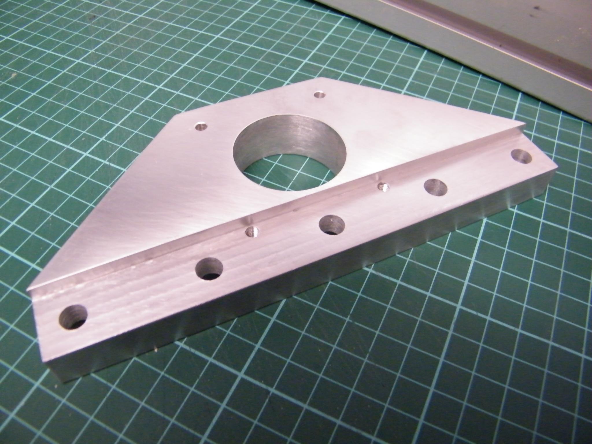

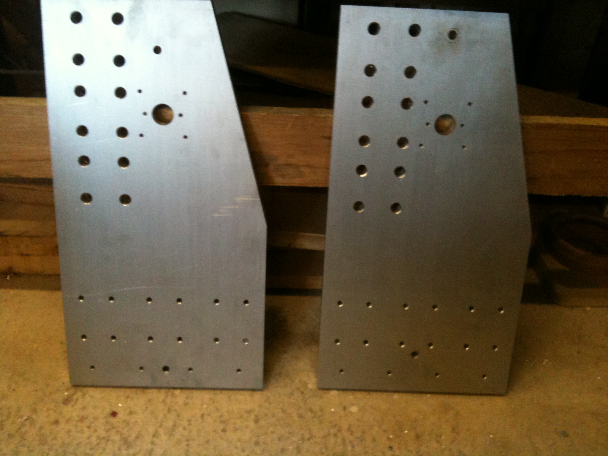

    Below are some parts for my new machine, I designed these and then got another member to make them for me, obviously things cost money but you can see it allows you to maximize your creative potential and build what you want rather than “what you can manage on your own”.

    A long message this time Rob, aimed at everyone starting out not just you. Hopefully I have pointed out some things that are over looked in the excitement of “building your own machine” but really should be thought about. I know, i've been there!
