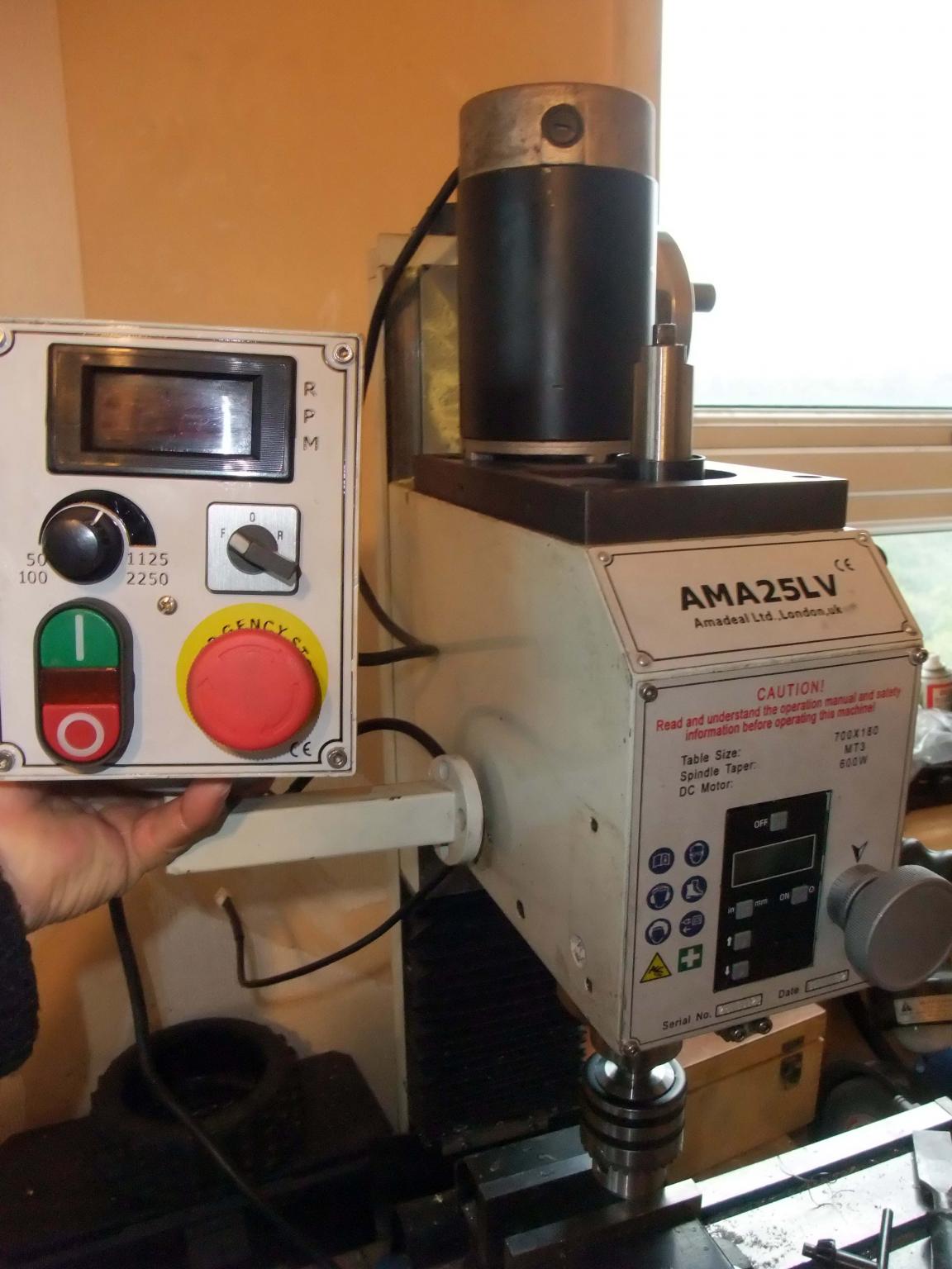

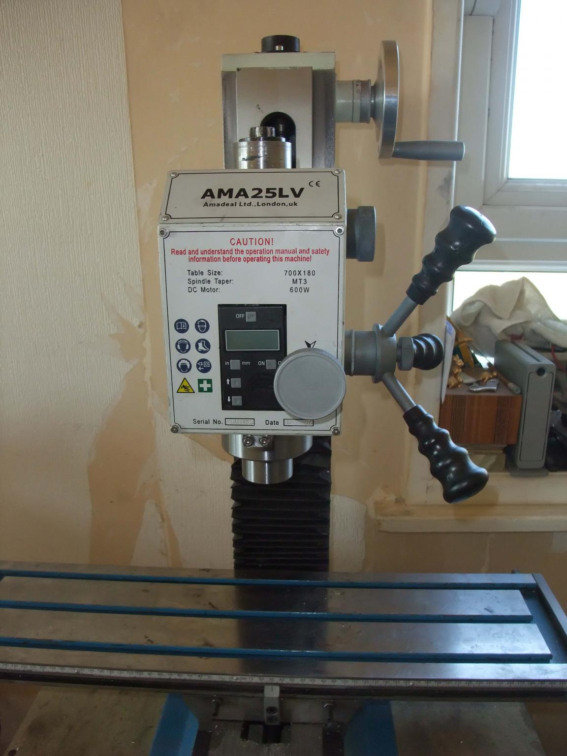

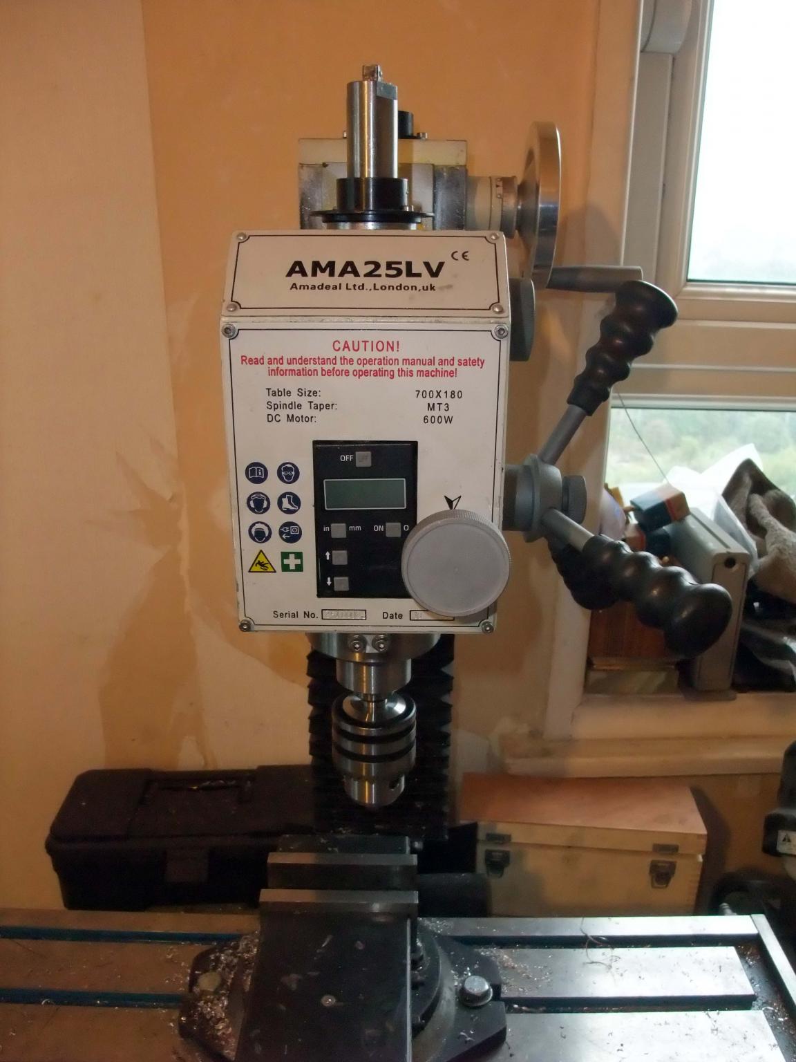

    This is my conversion of a Amadeal AMA 25LV Mill
    Strip down remove the spindle motor and electronics,there is to be a more powerful spindle motor fitted

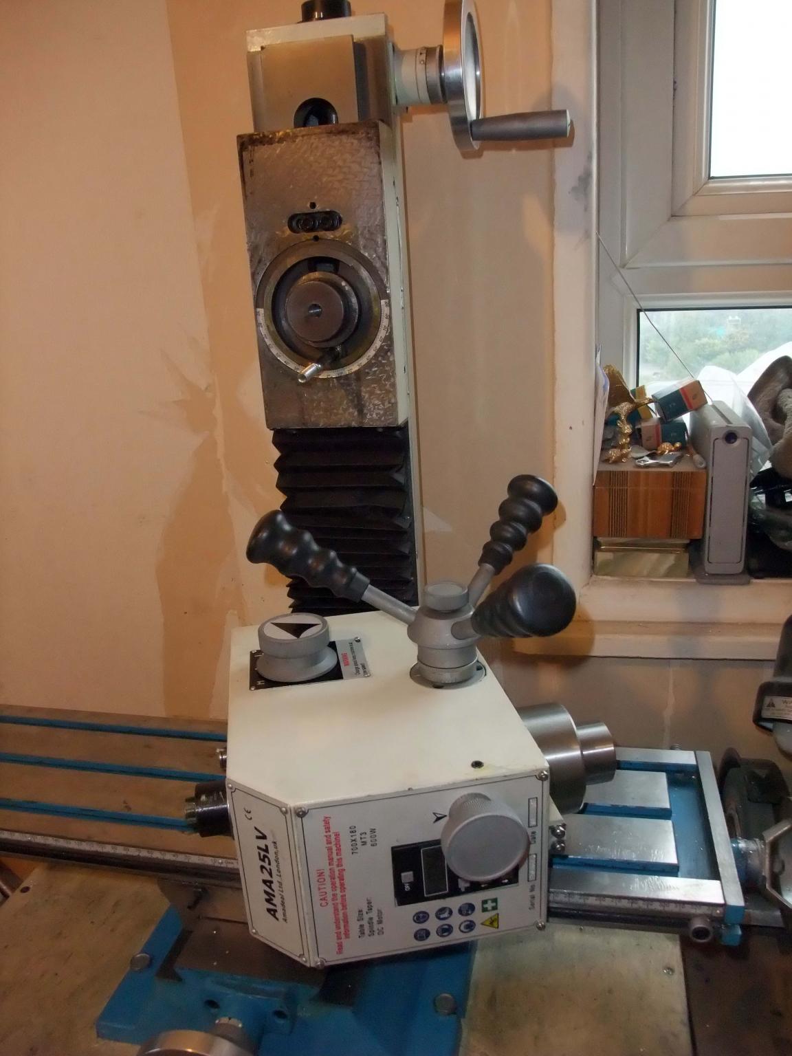

    Spindle head removed

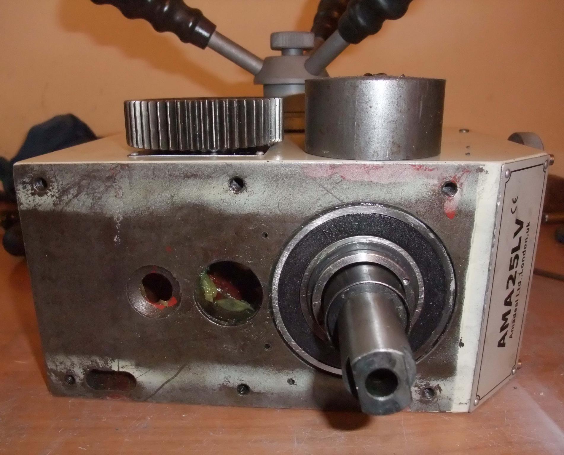

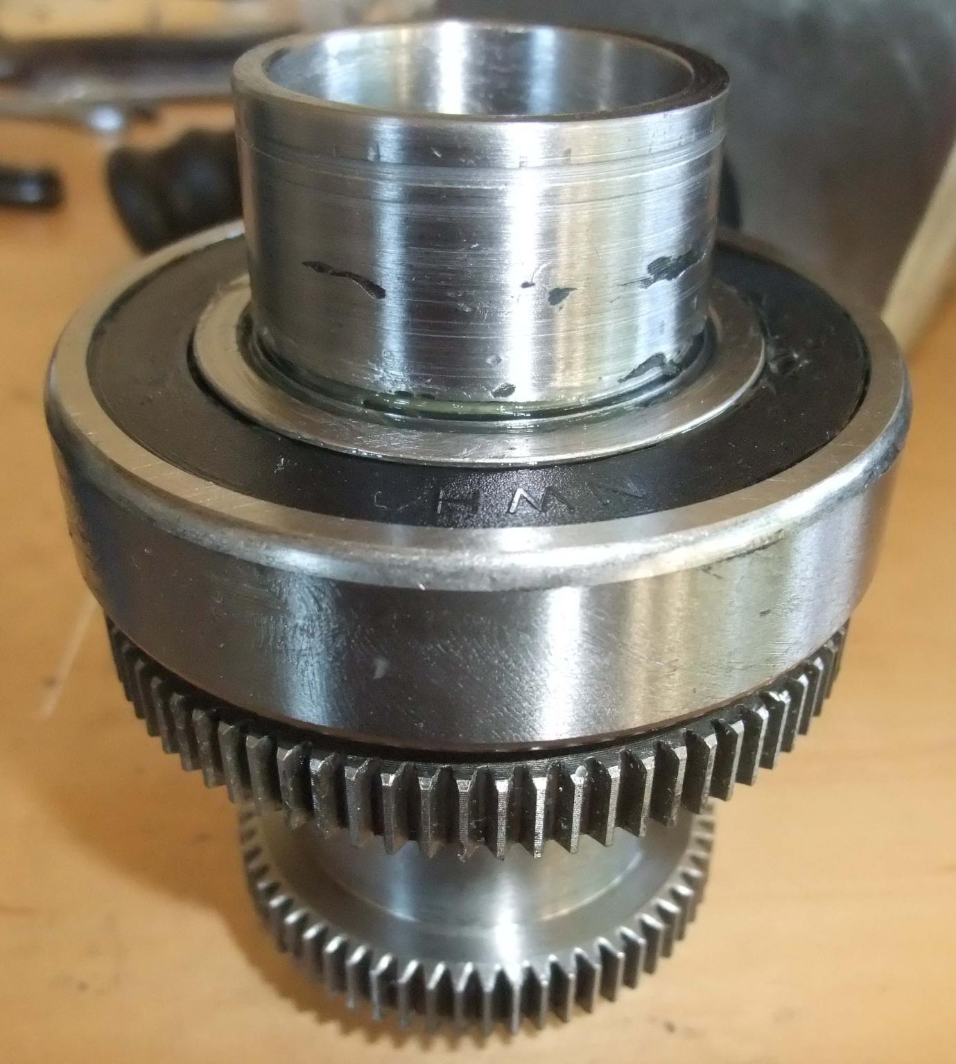

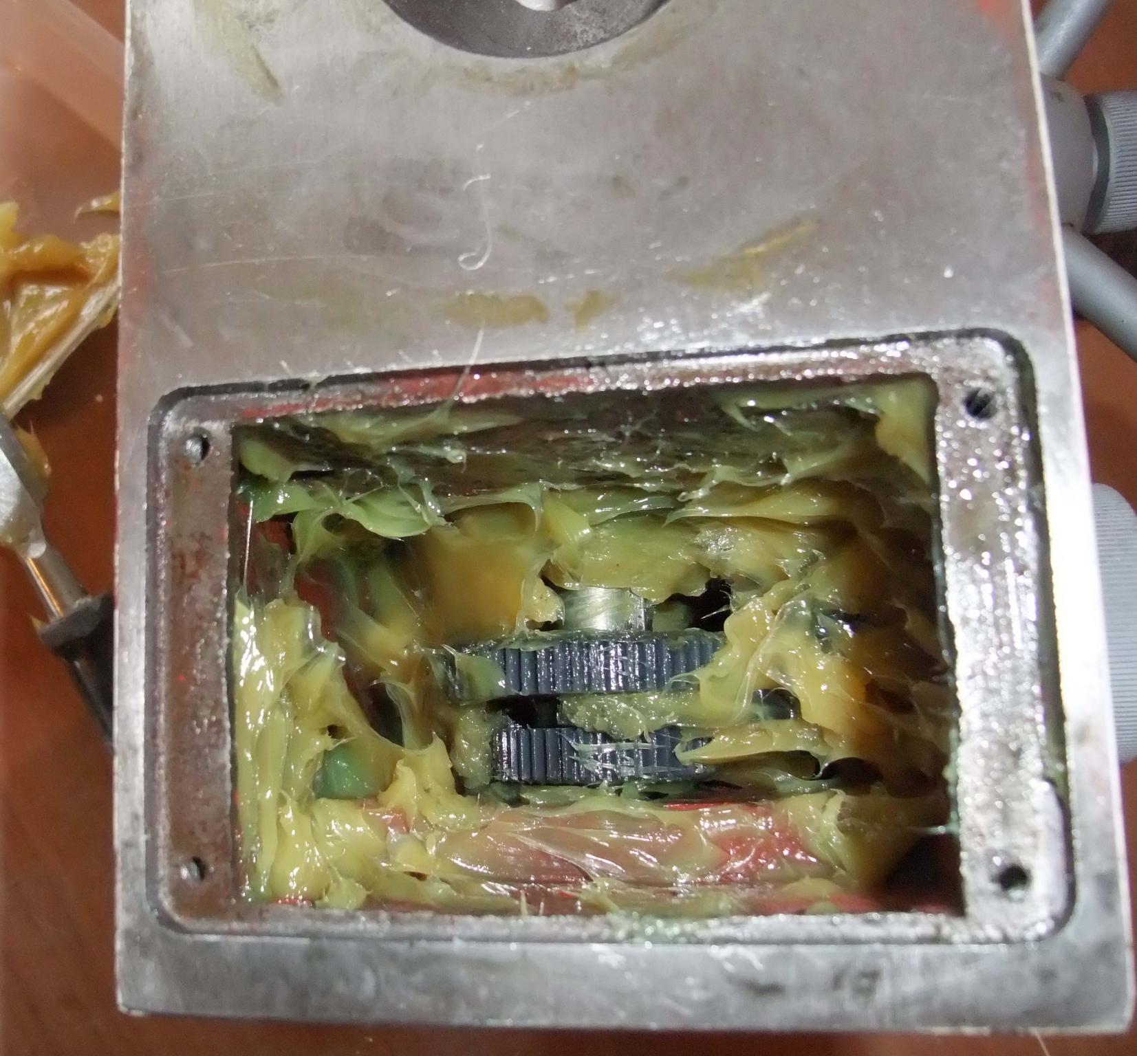

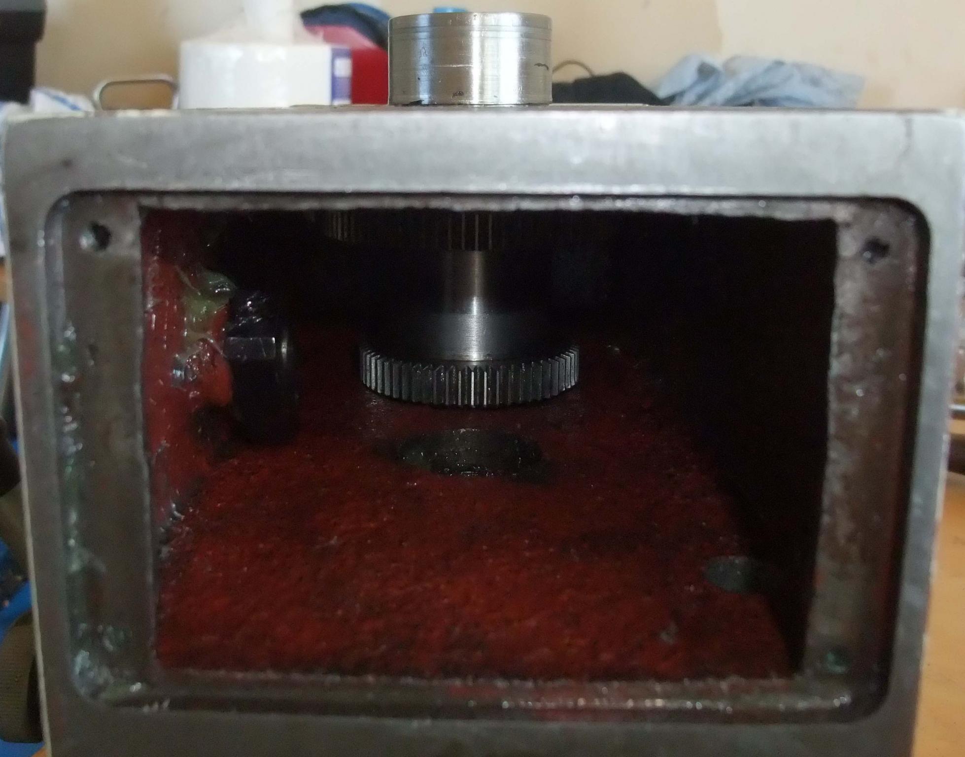

    Clean out gear box and remove gears as these will be no good for the new motor they are plastic and would not take the strain

    Next remove spindle machine an extender for the new spindle drive,the gear you see is also to be machined for the drive of the spindle

    Extender now welded to the gear chain bearing fitted ready for the housing

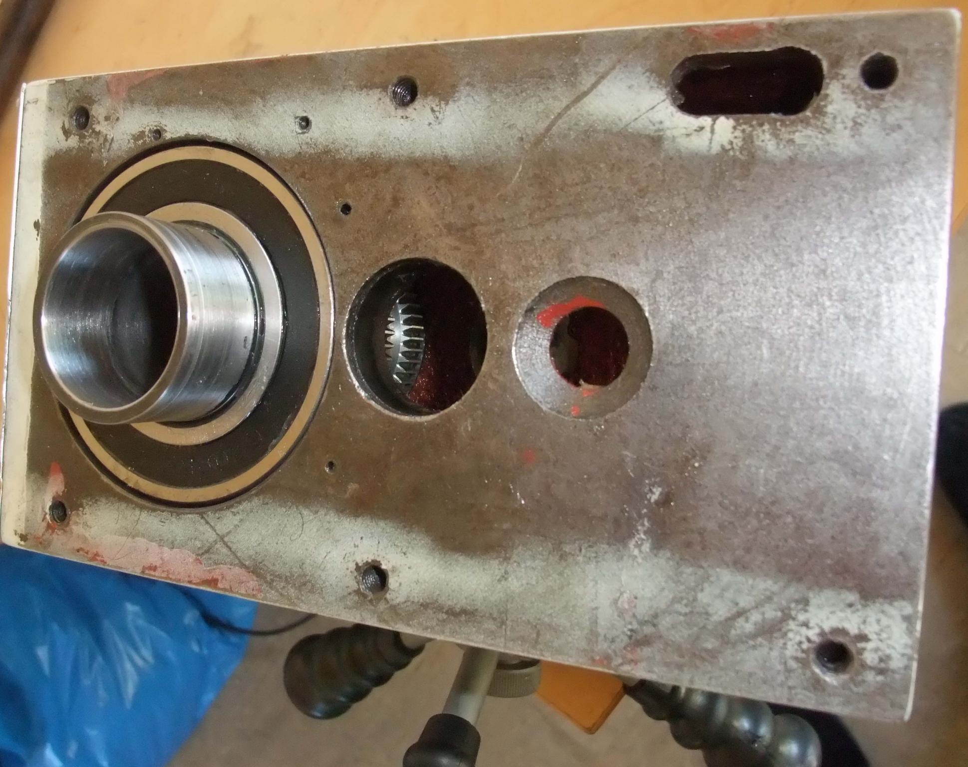

    Spindle Head back on but at this pint i find out the spindle wont turn (ouch ) so strip down to find the problem i had drifted the spindle two far in and locked up the bearings so drift it out 1/32 fitted it back and all is well always make sure the bearings turn before assembling not like me im always in a hurry and this is what happens

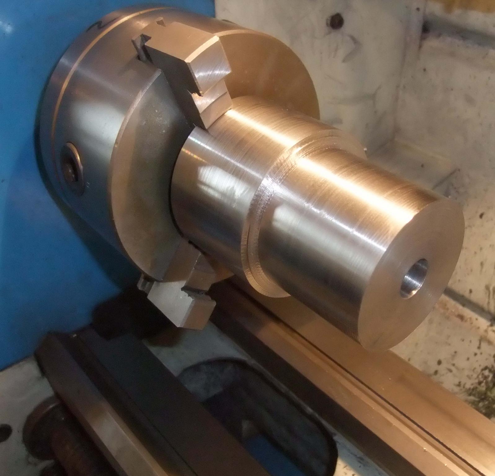

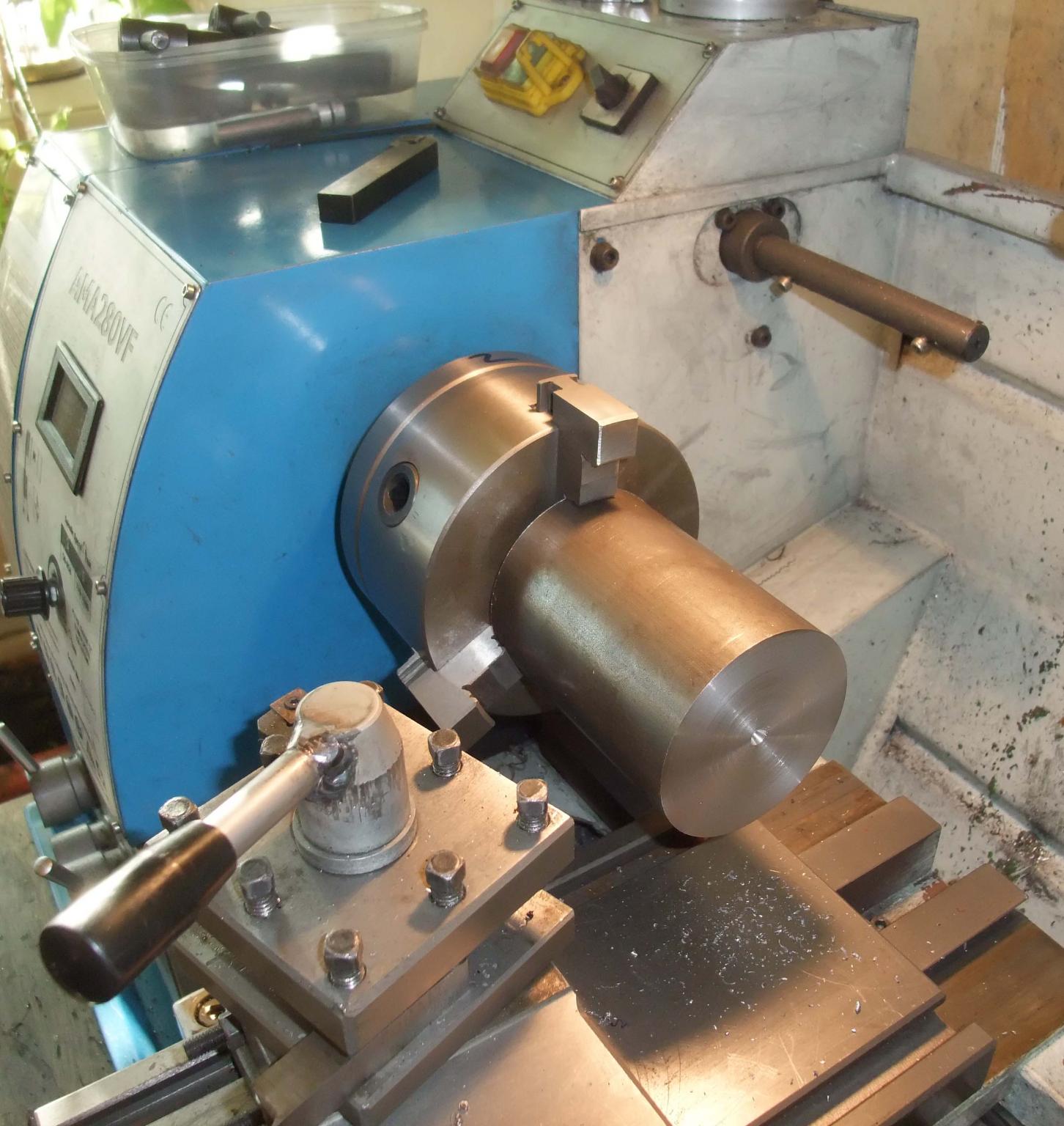

    Onto the lathe to machine the adapter for the motor i had intended to direct drive the spindle by this adapter but then i read that the Colett must have the long bolt that go’s throw the spindle to hold the Colett i was hoping the colett would stay in place by just knocking it into the taper, so after machining i had to go back to my original plan that is to gear drive it and that is where i am at the moment, gear machined and connecter partly re machined for the spindle.
