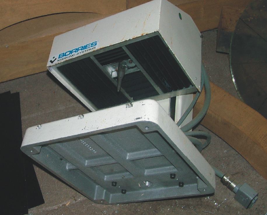

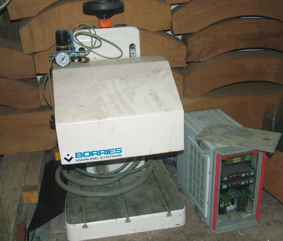

    In my junk pile I have a Borries engraver. Has precise X Y screws at the top and a T slot bed at the bottom. There's a handle to wind the top up and down. It's old, 60cm high 33cm wide by 34cm deep (approx) and weighs like it would need collecting. Comes with a big controller box and a stack of manuals. Presume the pneumatic engraving heads could be replaced with a light rotary cutter but not by me.
    I'm getting too old to do anything with it. Looks too useful to throw away, might be just what some budding CNC hack on a budget might want. Forty quid.
    If anyones interested I'll post some pics.

  2. put some pics up Robin...lets have a look
    I think the active area is only 100mm square, but as it's designed to drag a stationary carbide tipped cutter through metal with great precision, it is Robust. I think the steppers are rated 70v 6A. Full X Y bellows so it shouldn't have too many spiders inside :D
    Could be great for cutting pcb's.

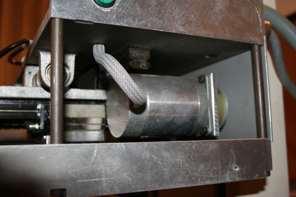

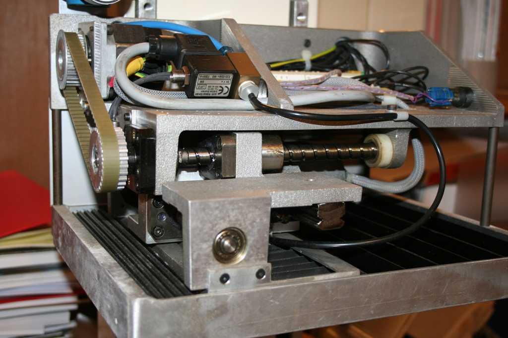

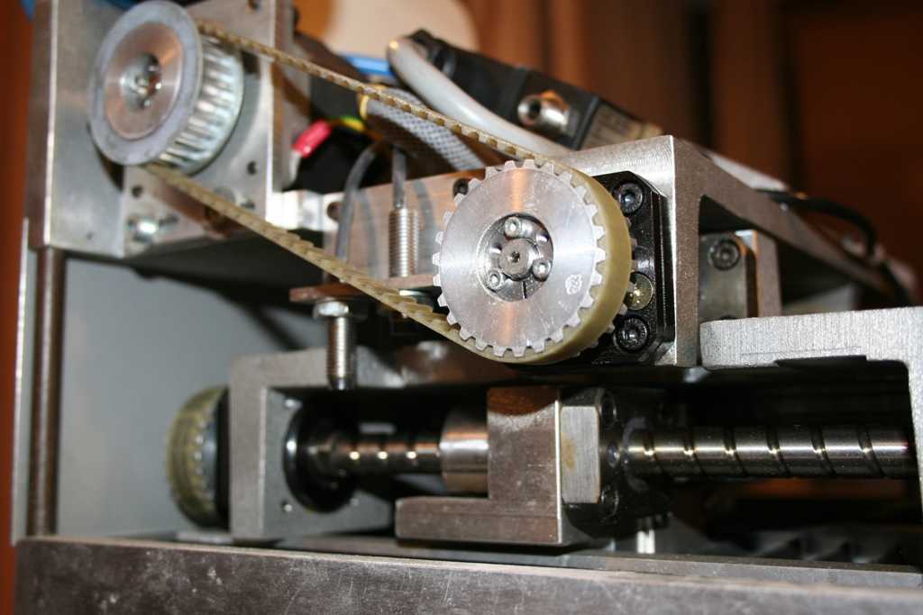

    Well I am the happy recipient of said beastie, now christened Boris. I picked it up from Robin this evening... the closure of the A23 on the way back added an hour and made it a 5hour 200mile round trip - the petrol almost cost more than Boris!
    So when I got home it was with some concern I had a quick scan of the manuals and decided to open the box (since Robin had already taken the money - duh, showing my age there)
    Anyway, heres three pics of the insides...
    What we have are a Pacific Scientific single stack Powermax II stepper (0.8Nm) belt driving a 10mm pitch 12mm dia ballscrew for the X-axis (upper screw) and a double-stack version of the same stepper (1.5Nm) driving the belt/screw for the Y-axis (lower screw). Resolution according to the manual is 0.02mm (10mm/rev/200 = .05mm half-stepped is actually .025mm, but thats good enough for me!) The steppers are 4.6A bipolar parallel. Pic 3 shows the Y motor and the end of the X slide (in shadow above). All the ballscrews are supported in bearings.
    Working area is 100 x 100mm.
    The controller unit contains a pair of stepper driver boards (9.1A max, full/half step) opto-isolated inputs (step/direction) and a power supply rated 70v 9A plus some other rails for the electronics. It shouldn't be too hard to get EMC to drive this :D
    There is no Z drive as such. Boris has a pnematic hammer that vibrates at 100Hz approx and marks the work. 'space' between markings is simply acheived by turning the air off with a solenoid valve (the thing with the CE mark in the first pic). The whole X/Y assembly is supported in the Z-axis on 2 x 40mm round rail slides with a 3mm pitch leadscrew (doubt its a ballscrew tho) with 140mm motion driven by a handle for setting the z-position and fitted with a revolution counter calibrated in tenths. In operation you would place the item to be marked under the scribe, wind it down til it touches and then wind back 1 or 2 clicks on the counter to clear the work surface. In the manual it suggests that the software can be programmed to pause for the operator to wind the Z up and down to avoid obstacles!
    It wouldn't be hard to fit a stepper in place of, or alongside, the handle.
    I am thinking that for PCB milling/drilling a small air spindle would be ideal, since there is already an air supply/regulator assembly. There isnt really room for a motorised spindle in there unless the motor was slung alongside the spindle below the X/Y axis somehow. With the X/Y unit at its maximum height there's 210mm of clearance to the table, and for PCBs you need the length of a 1mm drill in a collet plus a few mm for the sacrifical plate clearance, say 50mm all in.. so a 150mm long spindle is a possibility (theres about 50mm clearance internally).
    Its a superbly engineered piece of kit and I'm fairly confident it can be repurposed as a PCB milling machine relatively easily...
    So am I happy?... what do you think :D:D:D
