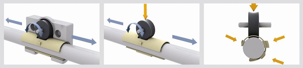

    Linear technology expert igus has developed a completely new breed of hybrid linear bearing that both rolls and slides. Called DryLin® WJRM, this innovative bearing system reduces driving force significantly and is particularly well-suited to applications that combine sliding and rolling movements, such as manually adjustable doors, guards, partitions and locks, as well as for light handling tasks.
    The lubricant-free plastic sliding plain bearings ensure the hybrid linear system is robust, insensitive to dirt and humidity, as well as being lightweight and cost-competitive. The polymer rollers, which are also maintenance-free, allow for easy manual adjustment of heavy machine doors and protective doors that can weigh up to 50kg. At a defined installation position, the roller bearing, which carries the main load, reduces the overall driving force by a factor of between four and five – this eases manual operation considerably.
    The principle of the installation position for the new hybrid bearing is such that the main load is on the roller bearing which reduces the driving momentum required. The plastic sliders compensate any lateral forces.

    The hybrid linear bearing design is based around the field proven DryLin W linear guide family. igus has modelled the new DryLin WJRM system in such a way that the roller fits inside without increasing the overall design width, which remains at 18mm. Standard economic guide profiles can be used, which are available in three styles for 10mm diameter shafts – as individual rails for a flexible guiding distance or as double rails with centre spacing of 40mm or 80mm, which allow self-aligning for speedy installation. The hybrid bearing housing is of blue-chromed diecast zinc.
