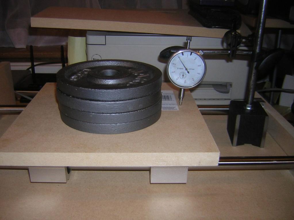

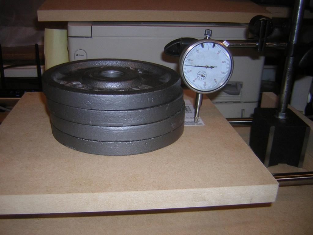

  1. Just by way of interest for prospective builders there is always discussion about what rod should I use... 12mm or bigger...
    Well here is the measured deflection of both 12 and 16mm rod (500mm long in SK type mounts) under 5kg load.
    In this experiment the mounts were not clamped up nor were they bolted down so the deflection of the rails themselves will, in reality, be less than this although the MDF base will deflects some as does the MDF 'table'.
    2 x 12mm rod = 0.25mm (theory .08mm for rigidly fixed ends to .3mm for unfixed ends)
    2 x 16mm rod = 0.1mm (theory .025mm to .1mm as above)
    (i.e. if the clamps aren't tight and the supports not bolted down the rod flexes more)

    Whats on the dials as read outs mate?
  3. errrmmm... 0.25mm and 0.1mm :)
    :rofl:
    Pretty bendy stuff but average joe probably wouldn't be bothered (or know to be)
    Quite. I think it depends on the intended purpose of the machine too. For instance, I'm not going to be bothered about even .25mm deflection when I'm routing a house sign. On the otherhand, I would like good precision if I'm milling a mold for a modelling project. I'd like to see the results of the same experiment done with the ends properly clamped and bolted down to a firmer surface than MDF. I bet a clamped rail bolted down to a steel base would fare better.
    Since I'm running 1m unsupported 20mm rails on my machine I may well do just that.

  9. Just to answer the point made previously, now the rails are fitted and bolted up tight with the table attached, the deflection of the centre of the table (16mm rails) under 4.5kg of load is <0.05mm (so that is the combined deflection of the rails, the MDF table and the MDF base the rails are mounted on).
