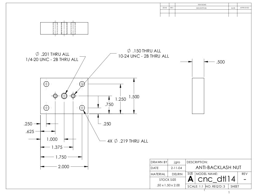

    I would make them to be at least 25 to 30mm minimum but think about making square ones as they are easier to fit. 12mm bearing will not be any good for 12mm trap 8mm bore is the norm for skate bearings.
  6. Yes I was thinking square/rectangle and maybe with 2 holes either side so I can screw or bolt them to the axis's now if the bore to house the the leadscrew is 12mm diameter what would be a safe thickness so i have enough meat either side of the leadscrew ? would 2omm thick be ok ?

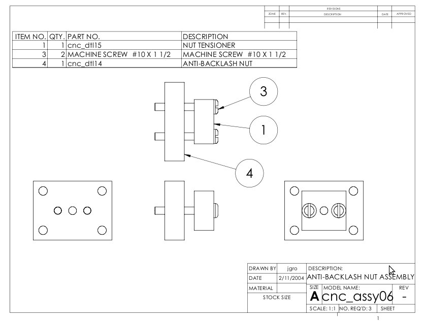

    I used the JGRO design for the nut - I attached some pictures below (dimensions are in inches - and you would need to alter the dimensions for a 12X3 central hole). It uses two rectangular pieces of delrin (each around 12mm thick), you can adjust the tension between these two pieces via two bolts to reduce backlash. It would be easier though to just use a single thicker piece and not worry about backlash. These nuts are attached to the machine using four bolts.
    Send me a Private Message with your address if you want me to post you the trapezoidal tap. I used a 10.2mm drill for the hole.
