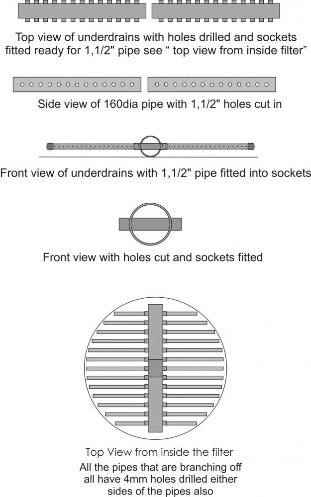

    Im looking for some good people to help me with a project that im going to be making.
    I currently own a Swimming pool filtration company and we deal with alot of under drain systems for the swimming pool filters.
    The underdrain systems are built using 2 x 160mmOD PVC-U pipe ranging from 2ft per side up to 5ft per side, however most of the customers want to spice thing up a bit by making them bigger or changing the design, so we will just stick with those sizes for now. The two halfs are then glued into a 160mmID PVC T peice to make one unit.
    In each half there is a number of holes that some 1,1/2" sockets are then welded into. these holes are then also mirrored on the opposite side of the pipe for each end of the socket to stick out of.
    I would like help to try and come up with some design or use an already proven plan that may be available.
    What should the router/profiler do?
    The machine should be able to cut rounded holes along the center of the pipe (any kind of shape really). then the machine should be able to spin the pipe around and mirror the holes on the opposite sides, perfectly aligning with the opposite holes.
    we do a different range of underdrain systems so the pipe fitting must be able to accept a pipe from 1,1/2" up to 8"
    Hardware i have
    Nema 23 motors x 3
    drivers x 3
    controller
    supported round rail x 4
    bearings x 8
    ball screws x 4
    lead screws x 4
    all i really need to come up with is some sort of design. im guessing the design does not have to be wide, just wide enough to accept the largest bore pipe i will be putting int
    o her. And for length im going to keep it simple and go for 5ft
    any help getting me started on this project would be greatly appreciated
    please see diagram

    I'll start of with some thoughts on this.
    Drilling forces should be pretty low in PVC, and given that you'r doing this by hand just now, accuracy doesn't need to be the top of the priority list?
    First idea -
    To keep costs low, I'm thinking a long bench, and use some standard steel/alu for rails for a moving head to run on, driven by either a rack and pinion set-up, or for more accuracy, a timing belt (single length, anchored at each end, with it looped up and around drive/idler pulleys on the head). Other option is ball screws, but I'm guessing 6m+ ones may be quite expensive..
    As you'll only be dealing with round pipe, you only need an x-axis.
    Then have a rotary table at the end of the bench, which clamps the pipe, and some form of adjustable guide on the head itself to support the pipe during drilling/slotting, yet still allow the pipe to pass through/spin.
    second idea -
    Have the machining head static, and then have the pipe pass through it, however it would probably take a fair bit of experimenting to design some form of reliable feeding mechanism.

    MC,
    I have just been thinking about what you are trying to do and I think that you could do it with a fairly simple design.....
    What I am thinking is that you will only need 3 directions of movement, Rotary (A) to spin the pipe, Linear (X) to move along the pipe and Vertical (Z) to plunge the cutter. You could even do away with the Z axis being controlled by steppers and do it manually seeing as you are only cutting through pipe, just a thought.
    With a max pipe dia of 8" then why not limit the travel on the X axis (along the pipe) to something similar, maybe 10"-12" will do. Moving along the pipe to cut various other holes could be done with a second linear move and clamp system that could be positioned manually anywhere along a 5ft pipe.
    Your design then could consist of a fairly small X axis which could be done with a ballscrew as you will only need a small amount of travel. Same goes for the Z axis (if you go for stepper control), use a manual move and clamp method to get it close to the pipe surface depending on the pipe dia and then you will only have a small distance to go to plunge through the pipe.
    Pipe would be held at one end by a chuck which is controlled by a stepper motor for rotation and by a simple 3 roller type system at the other, 2 at the bottom which again have a manual height adjustment for various dia pipe and one roller at the top to hold it on place.
    Hope that makes sense, trying to dip a hobnob in my tea at the same time as typing this is a bit distracting.
    Have a look at the photo below then read my post again, may make a bit more sense!

    That extra info is good!
    For the drilling, you need an A-axis, if you want the material turned automatically. To begin with, as you're only drilling holes on opposite sides, you could always just rely on turning the pipe by hand (machine drills/machines one side, then spin the pipe 180deg and let it do the other side).
    However, now that I know the type/size of holes you're doing, a x and y axis is pretty much essential.
    For the bigger holes, in order to keep the edges parallel, you either need to use a milling cutter and move the work under the cutter, which requires 3 way movent (up/down, fore/aft, right/left), or to rely on having the correct sized cutter so the pipe remains stationary.
    The hardest part I'd say to design, will be some form of clamp/support for the pipe. Rotary table at one end with chuck to control rotation of pipe, then on the moving head, some form of roller/guide assembly on the head to support the pipe at the cutter (probably one either side of the cutter for maximum support).
    Just check this video out, it shows what I was trying to explain....
    The interesting stuff starts around the 2 min mark, cutting large holes with a plasma, for your design the plasma would be replaced with a small router or Kress with something like a 6mm slot drill. Also it shows the machine drilling holes with a standard drill bit.
    Same principle as I was trying to explain though, just an X axis to travel along the centreline of the pipe, an A axis to rotate it and a Z to plunge through, Z would be optional but nice to have! Not sure why you would need a Y axis at all??
    You could also cut the ends of pipes so you can create your own 90 degree joints.

    You'd need a y to keep the cut edges parallel for slotting the cross pipe in.
    If you rely on spinning the pipe to create the hole, the edges are always going to be half the cutter width of the centre line, creating an unequally chamfered hole. For small holes, or thin pipe, it's not too much of an issue, but if you're needing a tight fit, you really need to use a y-axis to keep all edges parallel.
