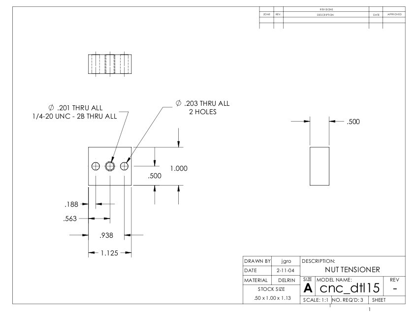

I would make them to be at least 25 to 30mm minimum but think about making square ones as they are easier to fit. 12mm bearing will not be any good for 12mm trap 8mm bore is the norm for skate bearings.
