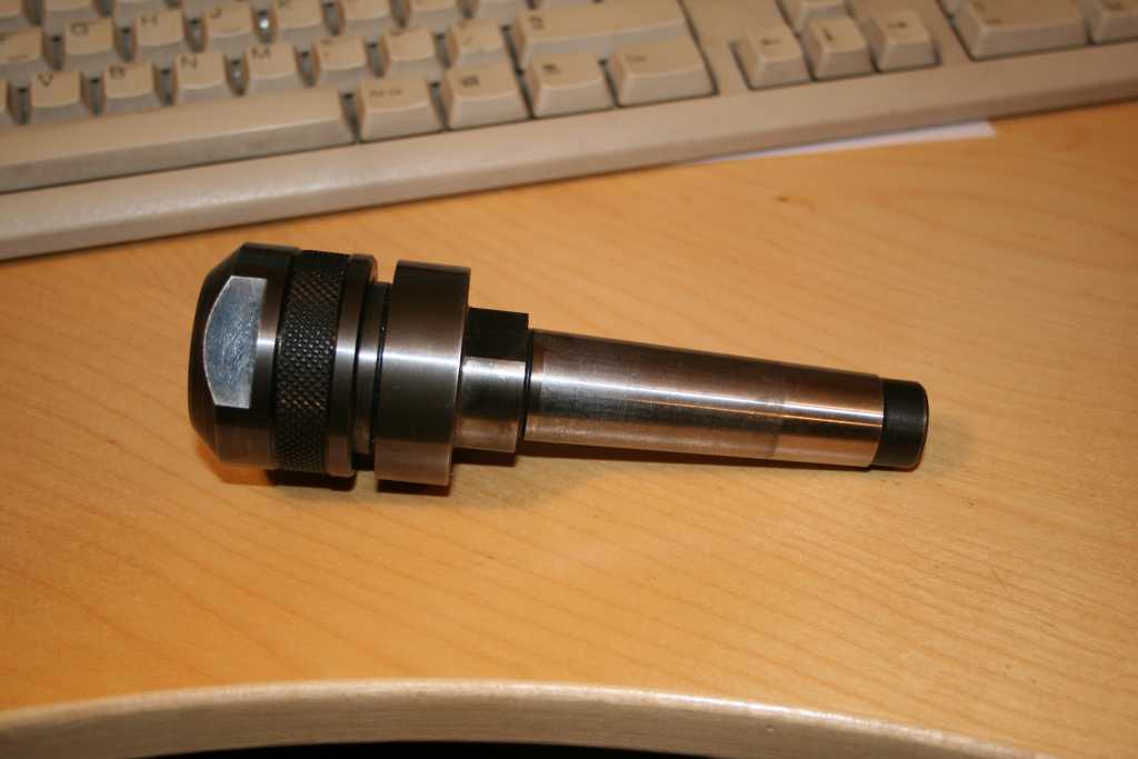

  1. As the title says, I have a collet chuck that came with the mill... but I have no idea what sort. Its MT3 taper, can handle anything up to 0.7" (17.7mm) through the nut and the internal opening for the collet in the main body is 22.4mm at the top. The nut is about a 32mm thread. The outer dimensions are 48mm dia and from the top of the nut to the gauge line is 66mm....
    Ideas?

    Could be a Clarkson, does it take standard end mills?. Is there a pointed dimple inside the body at the top?.

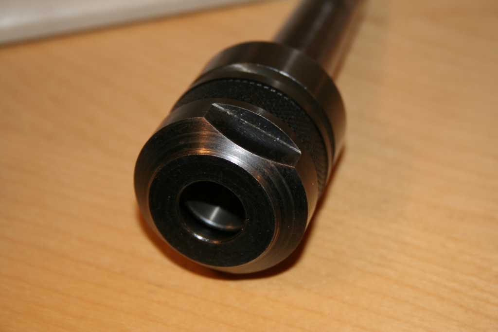

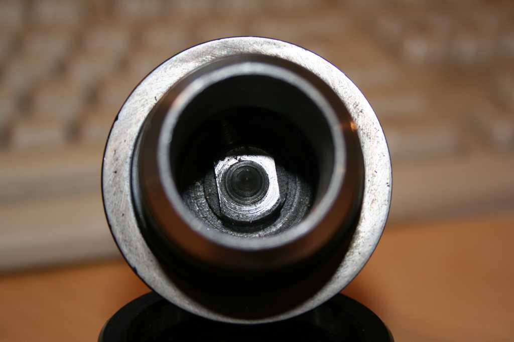

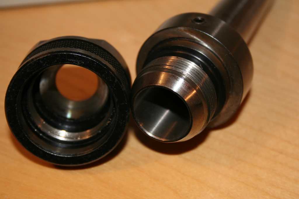

    Yes, there's something that looks like a little centre in there.., here are some pics...

    That's the one...
    Screw the nose shut, it doesn't grip until the cutter is in place. Screw in a milling cutter until it hits the pin, open the nose slightly so you can screw the cutter in another quarter turn then tighten the nose.
    Don't screw the cutter in too far, smaller sizes can shatter if not supported by the threads because the nut drives against them.

    Hmmm, I dont understand - what does the cutter 'screw' onto, there's no thread as such inside...
    [edit]Ah - I see... its a Clarkson Posilock.. uses threaded tanged collets... so I need to buy a set of collets at £35 then some special threaded endmills at £5 - 8 a go...
    Should I maybe just go get an ER25 or ER32 collet set...?[/edit]
