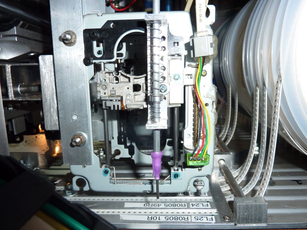

    Is that a rubber pick up nozzle? You must have camera alignment because you ain't going to move it! I also have a notion that a pick and place nozzle needs to leak air. Without the leak your pick up force is limited by the nozzle diameter and vacuum pressure. If you let it leak Bernoulli tells us that air forced through a gap will try to close that gap. You can probably do more lifting with a leaky nozzle than with a hermetic seal

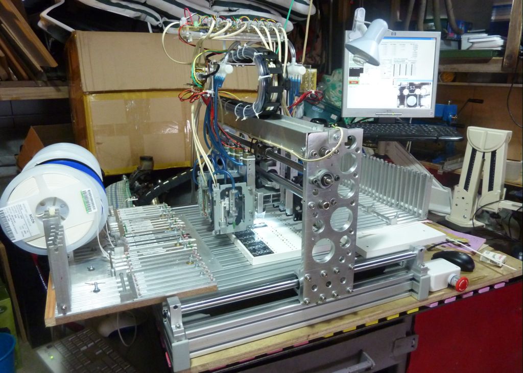

    Whatever. I am going to have a go at building a 24 station pick and place machine and this is my build log. It's only purpose is to spur me on, a sort of motivator, I think I can rely on you lot to keep me going
    First the XY gantry which is peculiarly floppy. There simply isn't enough space to make it rigid because I need access to the table on all 4 sides. The front is for loading pcb's, the back is for the tool rack and the chip alignment station, the left if for tape reels, the right is for chips and more reels. I am depending on 4 screw adjustable feet to keep it square.
    First pic: The Y axis runs on two 16mm round rails. Each has it's own 3/4" pitch screw fitted as close to the rail as physically possible.
