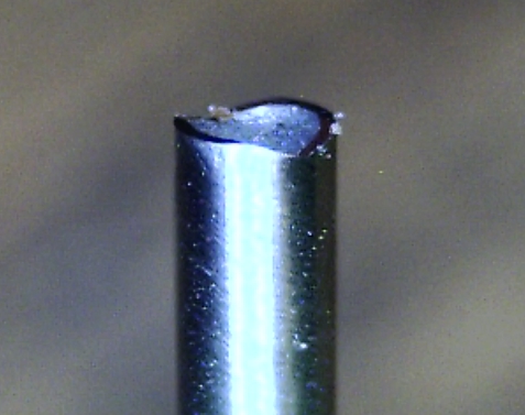

    hello.. just wondering, how do you compute for the correct nozzle type for a specific product? is there a standard computation for the nozzle inner hole?
    hope someone could answer..
  5. #25
    Tricky... :naughty:
    I don't think you can do it simply as area * vacuum differential > mass of the component.
    If you look at the tip it is cut to leak air. Bernoulli tells us that when you force air through an orifice it will try to close that orifice. Perhaps leaky is extra sticky.

  6. #26
    hixo's Avatar
    Lives in legazpi, Philippines. Last Activity: 09-09-2011 Has been a member for 9-10 years. Has a total post count of 2.
    so how do you generally select the type of picker that must be use?
  7. #27
    Quote Originally Posted by hixo View Post
    Pick one :whistling:
  8. #28
    Aim for the largest that you can reliably pick the part with, allow for the worst case resolution on your tape feeder as well as the nozzle placement.
    If physically aligning the part on the nozzle you may need to snatch it back when the tapper opens so a good flow rate helps.
    OTOH, if you don't have an autochanger you may decide to compromise on a single tool that picks your entire selection of discretes.
    Suck it and see
