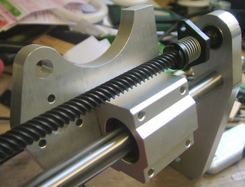

    First the XY gantry which is peculiarly floppy. There simply isn't enough space to make it rigid because I need access to the table on all 4 sides. The front is for loading pcb's, the back is for the tool rack and the chip alignment station, the left if for tape reels, the right is for chips and more reels. I am depending on 4 screw adjustable feet to keep it square.
    First pic: The Y axis runs on two 16mm round rails. Each has it's own 3/4" pitch screw fitted as close to the rail as physically possible.

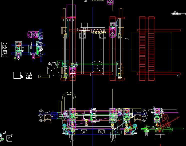

    Do you have a CAD drawing of the whole machine you could show us?
    Finish looks nice on the aluminium plate
    My CAD drawings are there to make sure everything fits together and can be assembled. The perspective is reminiscent of ancient Egypt, I keep most of it in my head if I'm doing the machining :naughty:
    My CNC package works exclusively with AutoCAD DXF files so I extract shapes as and when I want to cut them. There is no 3D pic of the whole thing.
    Suppose I should show that there really is some kind of plan though...

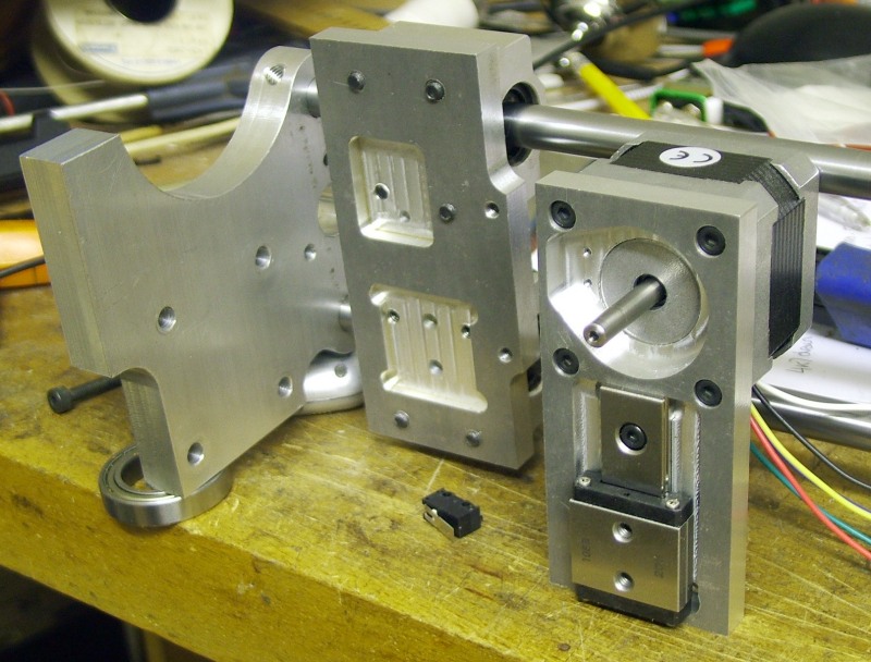

    I had a bit of a software blip that slowed me down but I'm back cutting metal (and seaching for 2mm screws to hold a microswitch :whistling:).
    This is the start of the Z axis and rotation. It lifts amd lowers by cam action with another NEMA17 for the rotation. Had to use a linear slide for the up down because it descends under gravity and I can't risk it sticking.
    The lifting cam has to run on steel because aluminium would dent.
    I sank the linear slide in to the 8mm plate so that it can't come apart now the tabs are off
    AutoCAD side view to show how it goes together. Plates in cyan, linear slide in green.
    Next the 3/4" pitch nut mountings and the component rotation motor plate.
