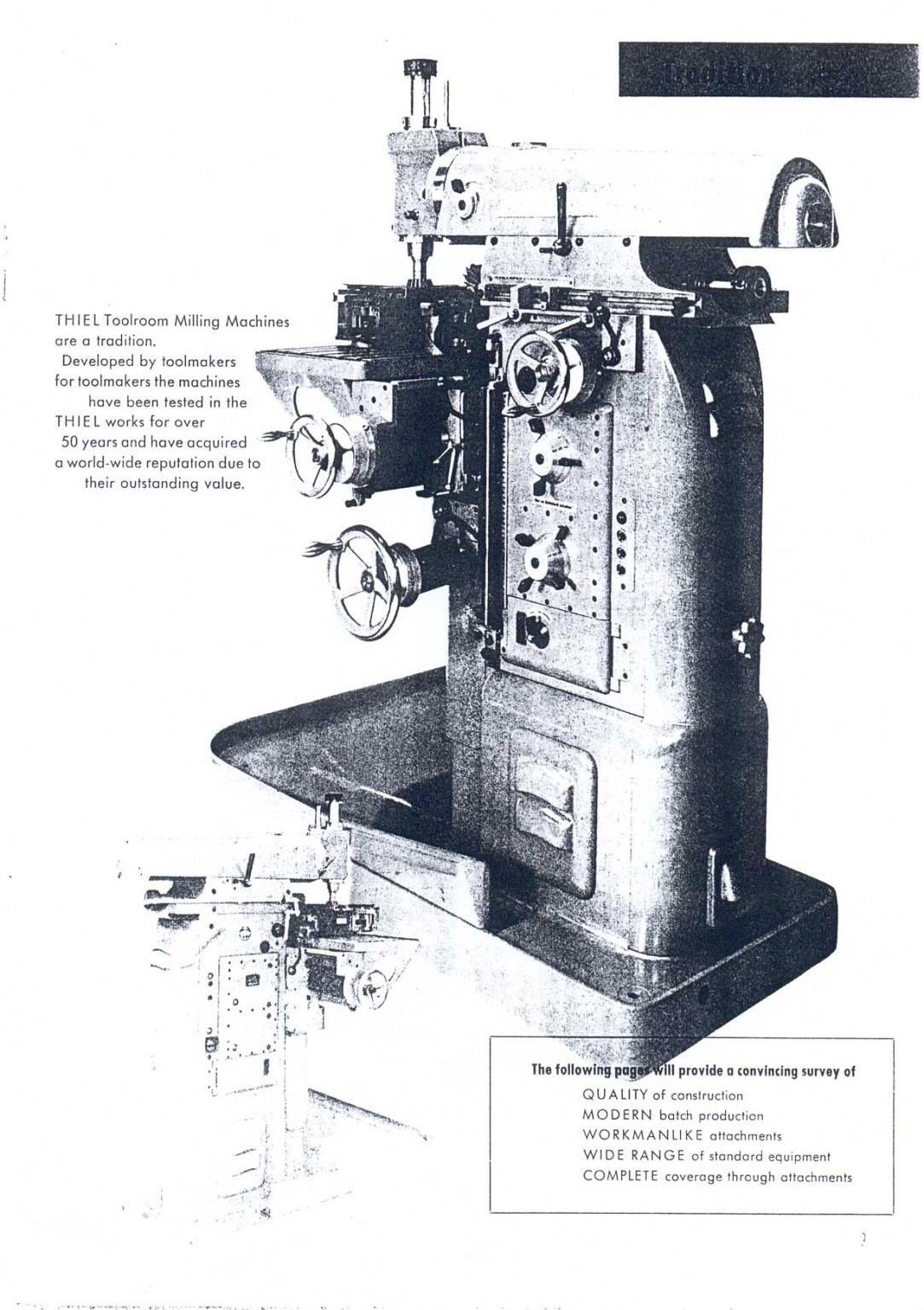

    Hi, ive got a thiel 158 tollroom mill. Ive seen this kit http://www.rhonmac-cnc.co.uk/index.htm and woundered if the one with the 5.8nm steppers would be enough to power it geared down 2:1, but dont quite understand about the driver, as it appears to me that it can run 4.2 amp but the motor takes 7?
    I used to have a couple of Thiel 158's, excellent machines. I remember the X axis being nice and free flowing, but the Y axis was always stiff. The Y axis is created by an overarm coming forward and backward with the spindle is attached, this all added to the weight and stiffness. Have you thought how you will get the stepper/servo drive to the Y axis? I am assuming you have a fixed table and not the XY fancy one.
    Mike
    Hi, i have the fixed one i think, its the same as the one that you attached a pic of. The y axis is surprisingly free moving with little backlash but can see how it could be hard to move. My x axis is the one that is harder to move and also has a bit of backlash so i need to find a way to reduce that first.
