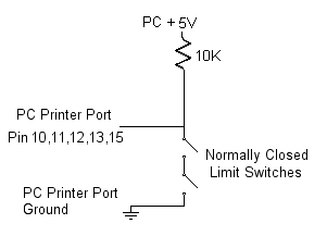

Below is a schematic for a simple limit switch.
The idea is straightforward.
The parallel port pin is connected to the computer's +5vdc power supply through a 4.7k to 10kΩ resistor; this was a half watt unit. The resistor protects the parallel port from the excess current that it would receive were the pin directly hot wired to the power supply. The 5v pulls the pin high.
Also wired to the same pin on the parallel port are the Normally Closed limit switches linked in series. One wire is connected to the pin and the other wire from the switches is grounded to the computer's power supply low voltage ground. When the switches are all closed, the parallel port pin sees ground. It will be pulled low since the current from the power supply will take the path of least resistance and seek ground through the switches rather than through the parallel port.
When any one of the switches is open the current will travel to the parallel port pin, and the pin will be pulled high. The software is told to stop the machine when the signal is high.
Above is a picture of one end of the Xylotex board with a pair of limit switches and a pull-up resistor. One end of the 10kΩ resistor is connected to the +5vdc terminal on the Xylotex board and the other is connected to the same terminal as one wire from the limit switches; in this image it is terminal 10 (the red wire).
The other wire (black) from the switches is connected to the ground terminal on the Xylotex board.
Note: Sometimes limits will be tripped by the noise in the steppers’ wires. Run the wires separately and/or use shielded cable.

Limits aren't that difficult but to a degree the way you implement them depends on the facilities offered by your breakout board... or in your case the Dsub board... there are usually about 5 pins dedicated to input, which looking at the pic I can see the Dsub board has. In your CNC control software you will be able to assign functions to these inputs based on pin numbers.. Estop , Limits or Encoders are usually the functions assigned.
Just looking at limits they operate as follows:- Use a normally open switch, when the software detects any of the assigned inputs switching closed it stops ALL motors. In the case of Estop it similarly stops ALL motors. Shared Home/-ve limits operate slightly differently to just a simple limit. When homing the control software moves each axis until the switch is triggered then advances a small amount off the switch to a known position. When NOT homing if the shared switch is triggered then ALL motors are stopped as with a bog standard limit. A lot of this is down to the features available in the software you plan on using. It's one of the reasons I went with Mach2/3 myself as it has ALL the bells and whistles IF you want to implement them.
It's usual to assign a separate input for each axis home position/-ve limit, this uses 3 inputs. Then a further single input can be used for all +ve limits, this is called summed limits. The remaining input can be used for a separate Estop or enable function... again on a normally open switch. If you plan on using the inputs for other purposes it is possible to sum the home/-ve limits too... but then you have to ref each axis 1 as a time instead of being able to ref all.
I've upped a rough diagram based on a pic from your build log with suggested trigger/switch positions. I'd mount the switches to the base/frame so that the blocks of your moving parts would trigger the switches or you can preferably use adjustable trigger blocks. This avoids having the wiring to the switches in motion and also means it's easy to move the trigger block to adjust the point at which the limits are switched. You don't have to use expensive cable for limit switches.... they are normally open for starters so there's no signal/voltage in the circuit anyway. micro switches are as good as anything.. I use micro switches on my Y axis and Z axis and have excellent positioning and repeatability which I've tested using multiple-passes over the workpiece.
