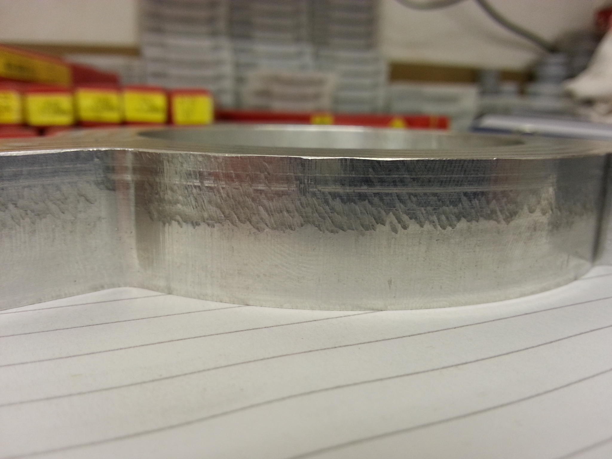

    I am cutting some spindle mounts for someone and although they will be happy with them I am trying to improve the cut quality.
    This photo is of the bottom of the mount. The only difference between this edge and the others is that there was no material on the other side of the cutter. The cut was positioned close to the edge of the material so that I could get two parts out of it.

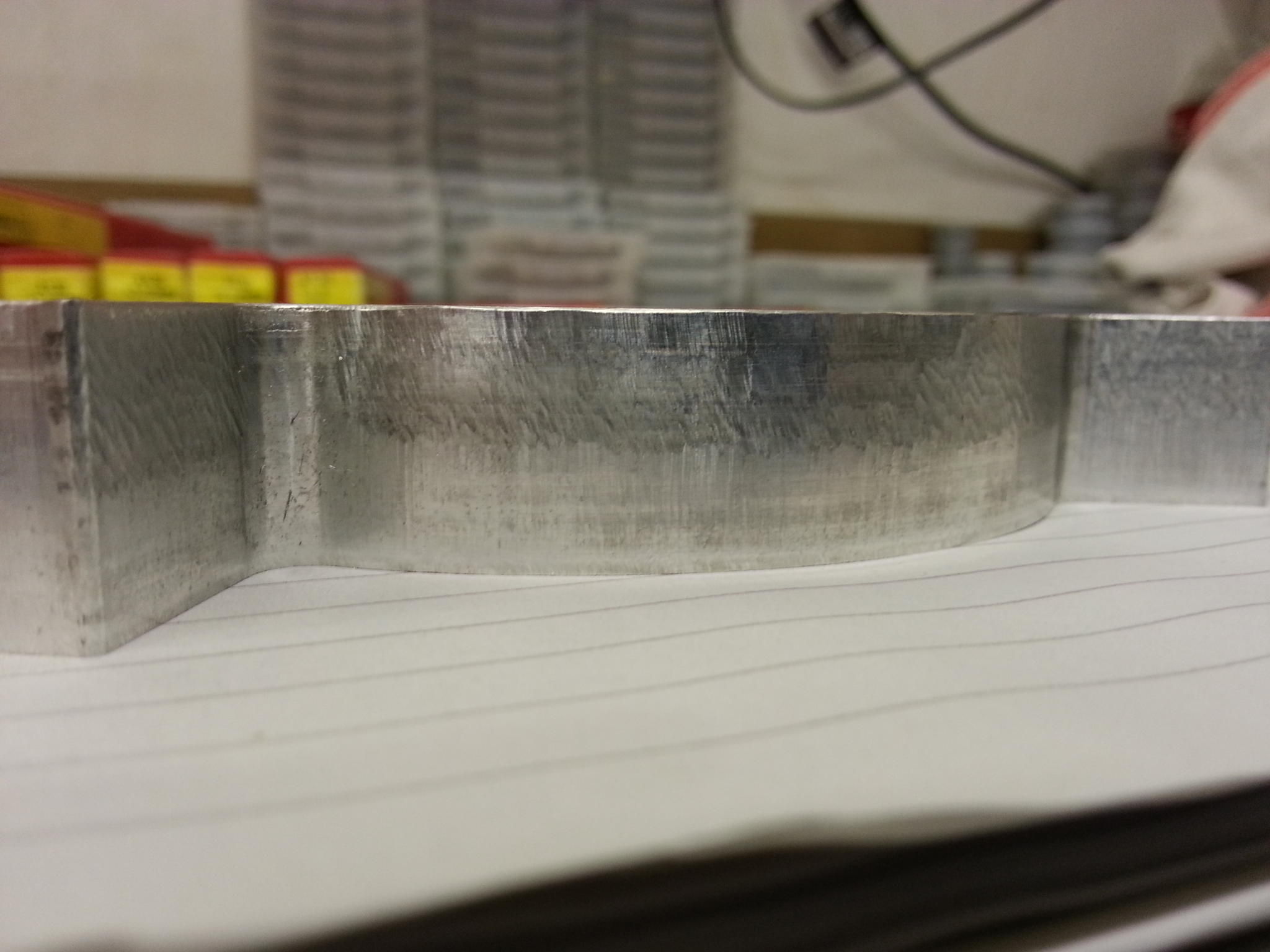

    The next photos show other edges of the cut which seem to show some vibration from the top down but it dissappears approximately half way down.

    The material is aluminium 20mm thick, 12000rpm, 700mm/min 1.5mm DOC with a 0.2mm finish pass. 6mm single flute cutter.
    last 2 photos look like chip re-cutting/rubbing marks how was you clearing chips.?
    I was following the cut round with the vacuum so I think I did a good job of clearing most of the chips. Gave it a fair amount of lub as well. But seeing as the first photo shows a good cut and this bit did not have anything to hold the chips in that might be the problem. I might have to rig up my compressor and try a bit of air blast to see if that helps.
    Welcome to the club ;) If you already have an air compressor then it seems that is the best solution and I believe is what Jazz uses?
    By the looks of the dents then I'd put a small wager on it.!! . . .Loads of air does the trick you have to blast the suckers away then bit of coolant just helps stop cutter stickage.!

    If it comes down to having to use air I have a compressor but its fairly big with a 100ltr tank. I dont fancy having to run it constantly. I wonder if a 280ltr/min magnetic air pump would push enough air to clear the chips away?
