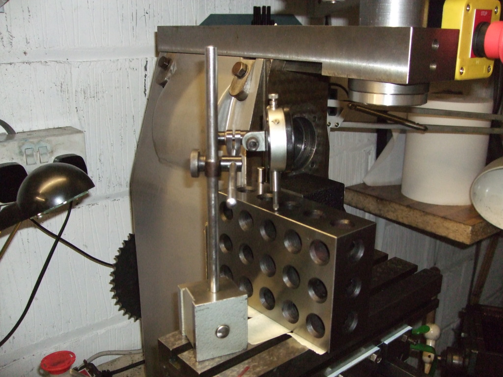

    Final alignment checks to see if I have met the Connelly prescribed 0.001" in 18" accuracy:
    one side was trammed to y axis then other face of block measured to z axis.
    block clamped to z ways and y axis traveresed
    similiar done to x axis.
    results:
    x-y 0.001" in 18
    y-z 0.0015 in 18
    x-z 0.0015 in 18
    I am going to leave it at that as I am loosing the will to live!

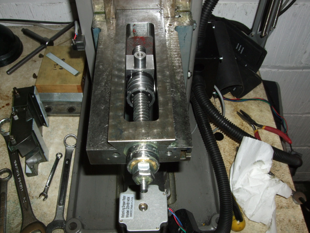

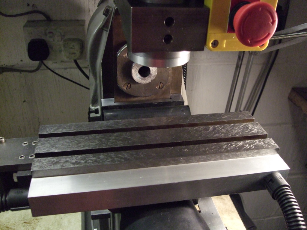

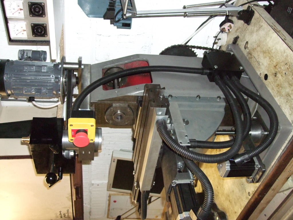

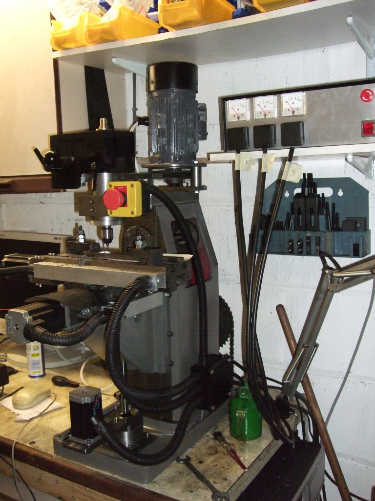

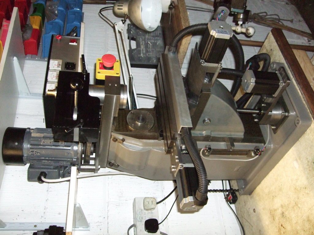

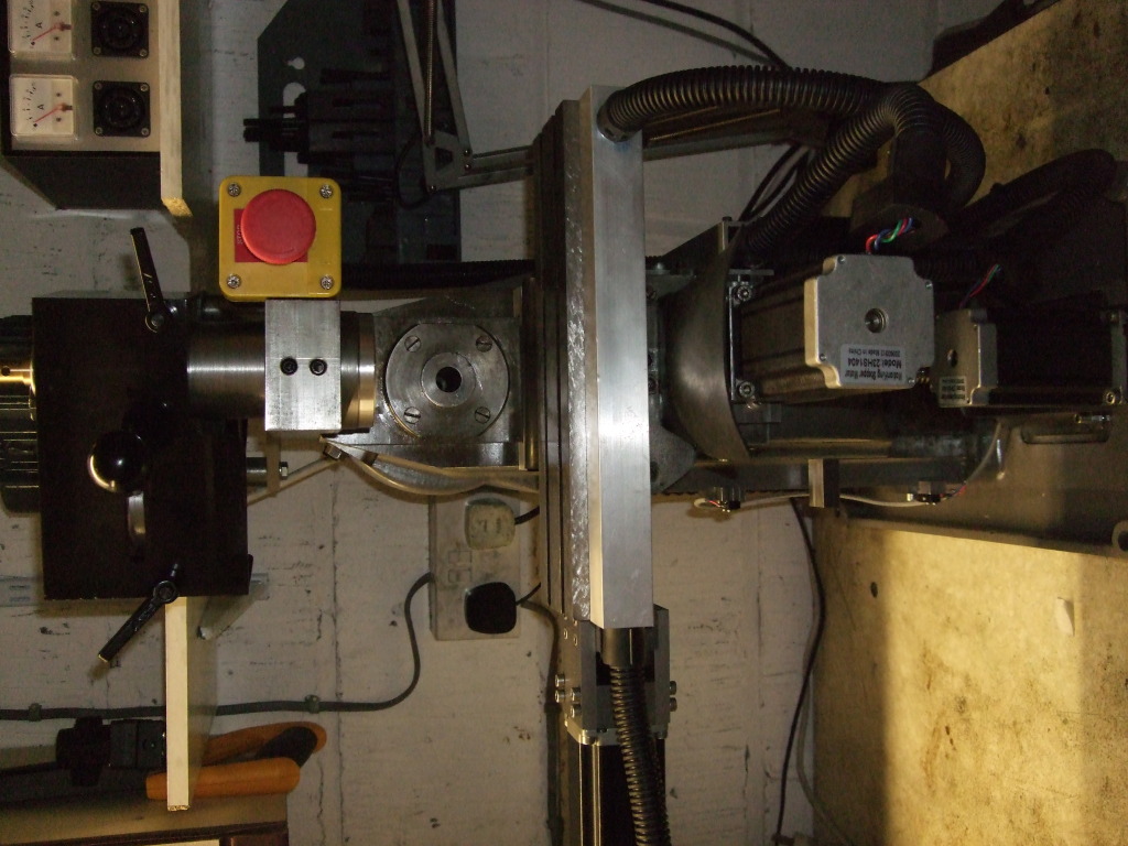

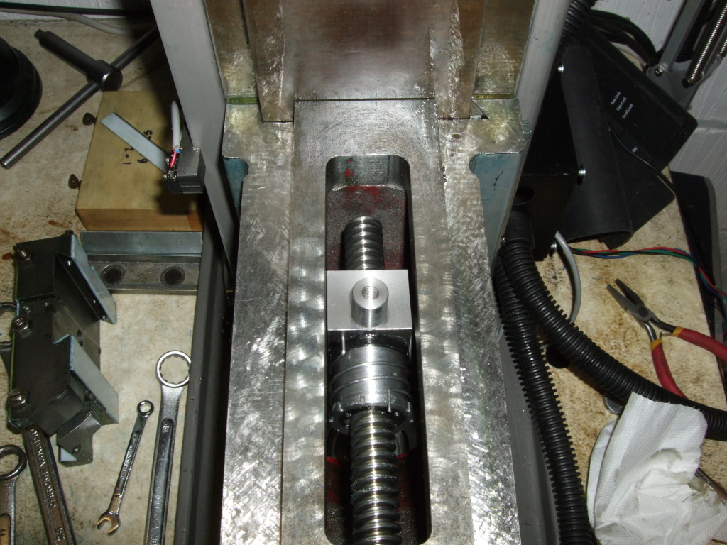

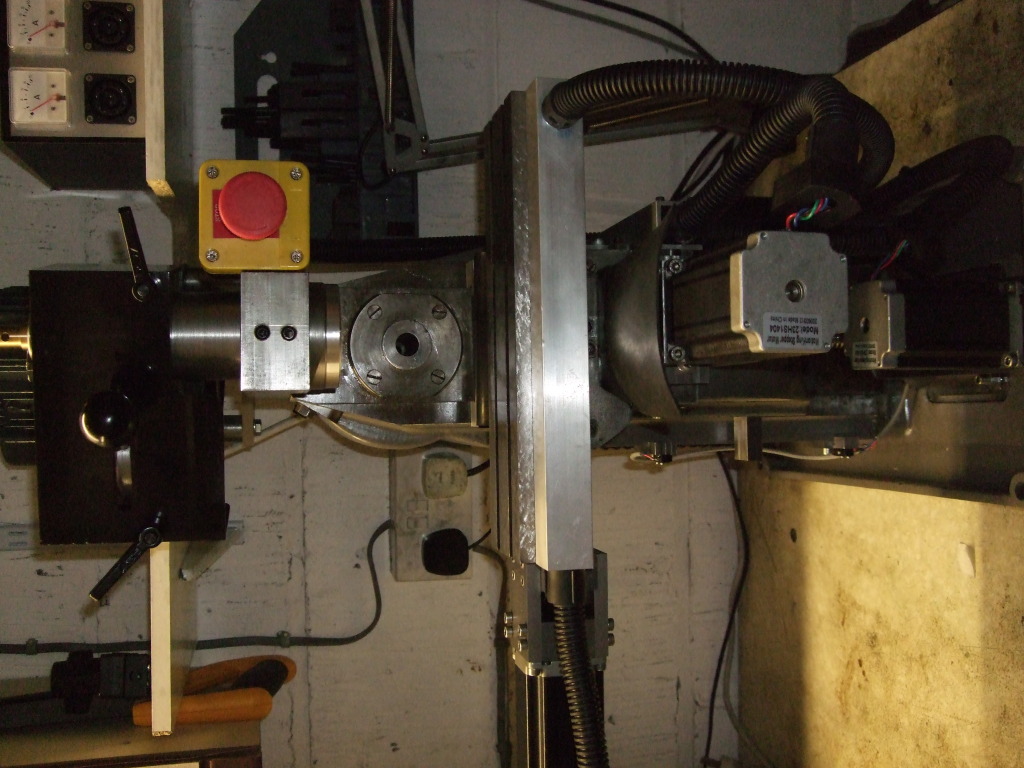

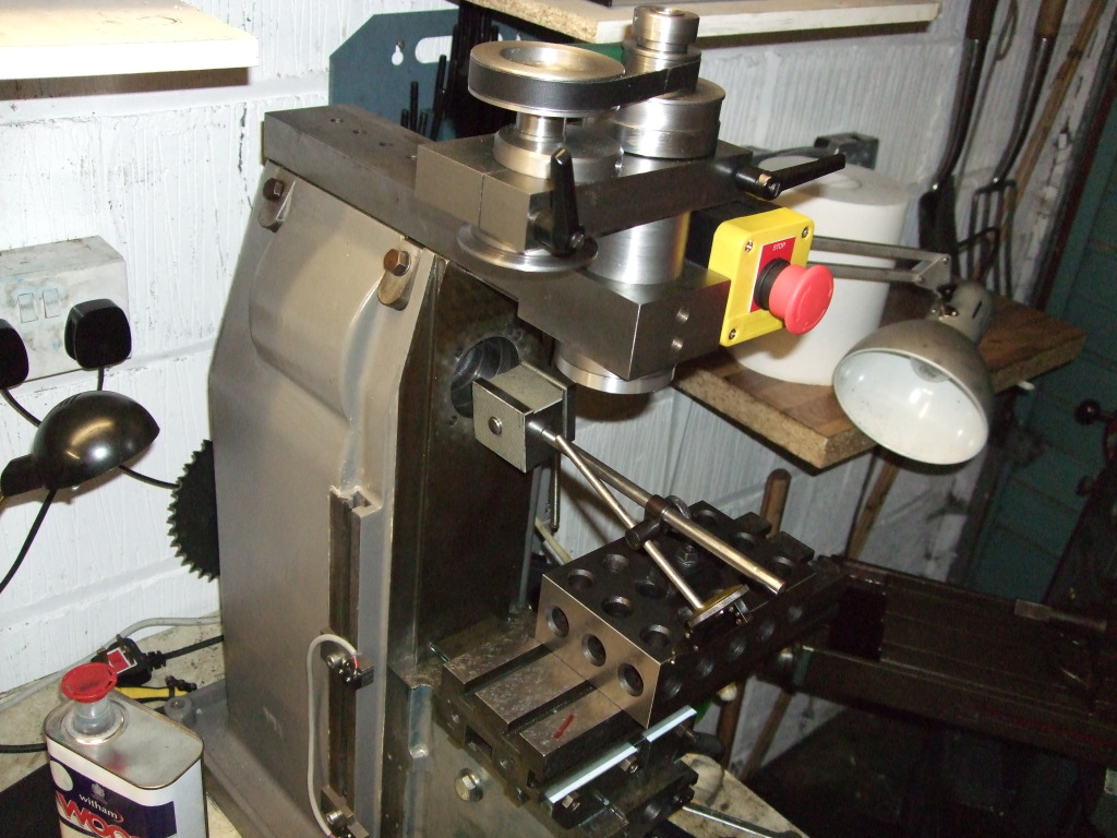

  2. #42
    final mechanical assembly:
ID:	4622 Click image for larger version.
ID:	4623 Click image for larger version.
ID:	4625 Click image for larger version.
ID:	4626 Click image for larger version.
ID:	4627 Click image for larger version.
    Just final wiring with shielded multi core back to controller and I am done, oh and I have to learn how to use the thing!

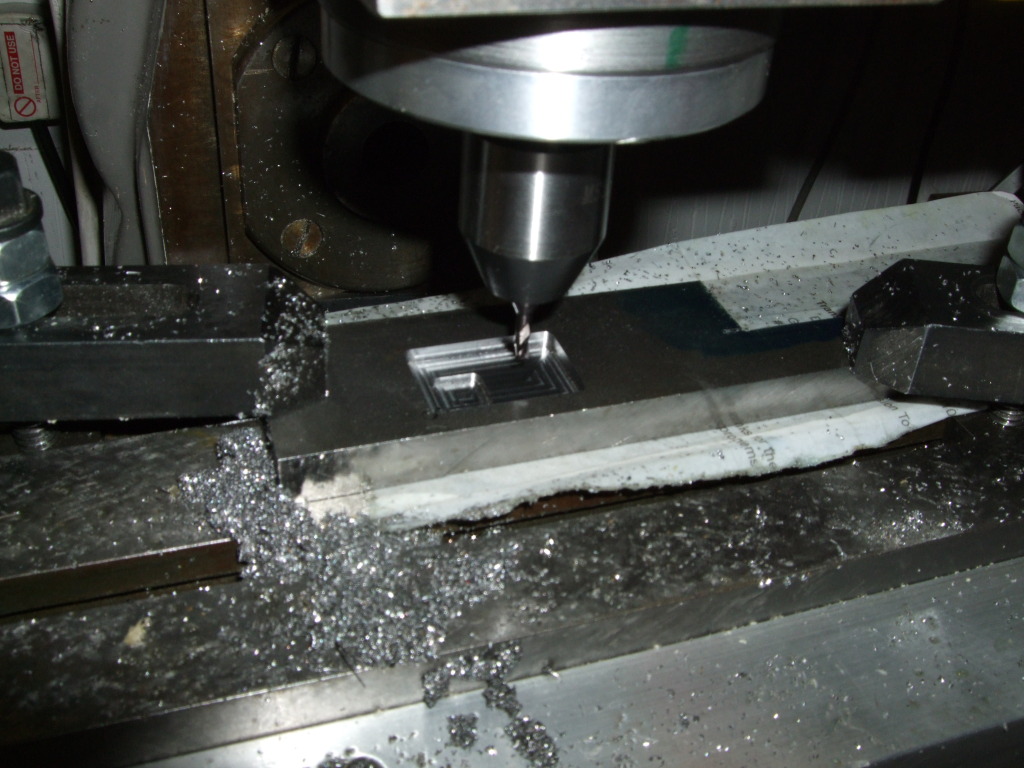

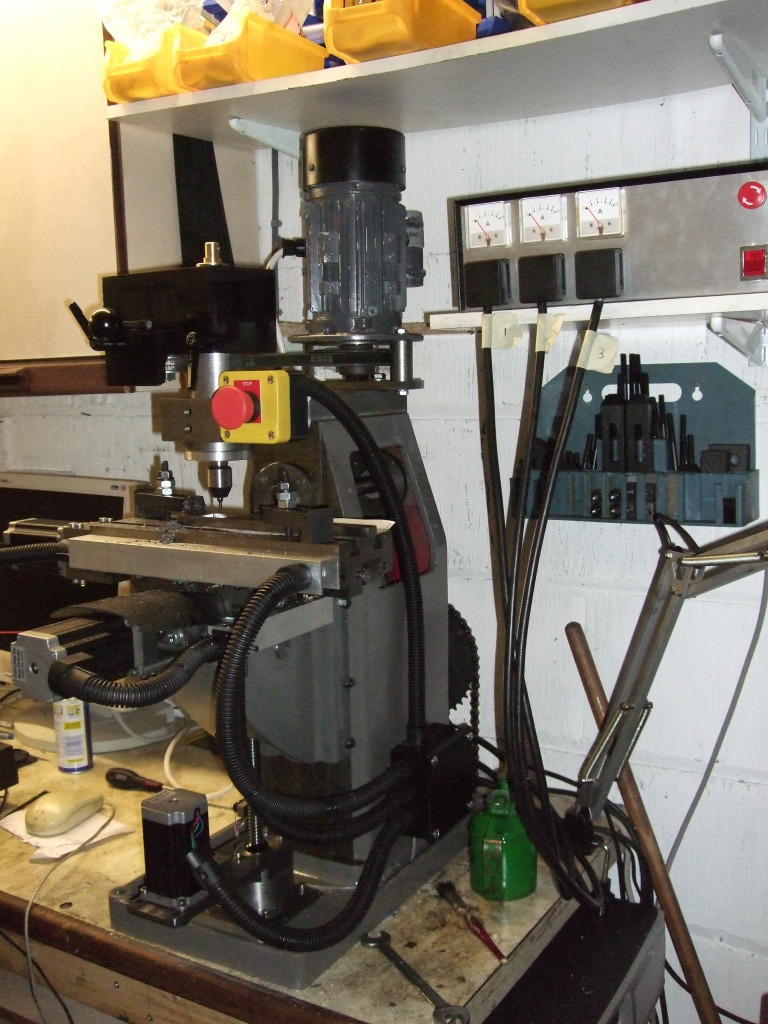

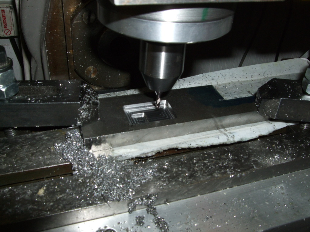

  4. #44
    It's alive!
    Did my first tests and it seemed to go ok. Machined some pockets in some scrap mild steel.
ID:	4787Click image for larger version.
    the pocket was 30mm x 20 mm and all dimensions seemed to be within 0.01mm of nominal (although this was just a quick check with digi calipers). I will do some more serious machining and see how a bigger part measures.
    Cost is a bit over budget as the electrical bits set me back more than expected but I recon the original machine, stock, hardware, motors, controller and computer cost me about £600. That does not include the extra tools I bought to do the job of course, they are an investment!
    I have enjoyed the project and have learned a lot from it. I hope you have enjoyed it too.
