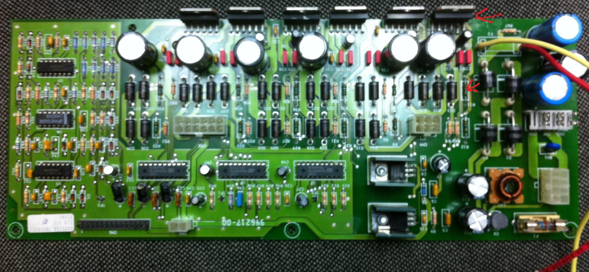

    gave it another go today on a little 4" x 6" carving, just using the easy cnc software that it came with and it worked perfect,
    reading what irving's wrote think that's it, so will leave mach3 alone, and look for a code converter,

    here's a photo of the board robin, arrowed are the bits that blew, plus a Darlington transistor that was on another little 2"x2" board that was joined to this by the yellow and pink wire,
    don't know if there's diodes or not, didn't know what the other little bit was either, but the lad at maplins said something about resistor,
    kevin
  2. The line of black items 3rd row down are the flyback or catch diodes... therefore the issue probably wasnt back-EMF spiking but decelleration surge... that makes more sense if other parts died that are not directly related to the output transistors.... of course all has been stressed now... so budget for a new set of drivers sometime...
    :lol: and you'd believe what a lad at Maplins said?:whistling: mind you i'm surprised he even knew what a resistor was, so maybe hope for them yet! :confused:
  3. The Following User Says Thank You to irving2008 For This Useful Post:
  4. #13
    yes think if i have any more problems with parts blowing thats what i'll do
    lucky he did, there were thousands of bits on the racks, i could of been there for days
    thanks guys
    kevin
