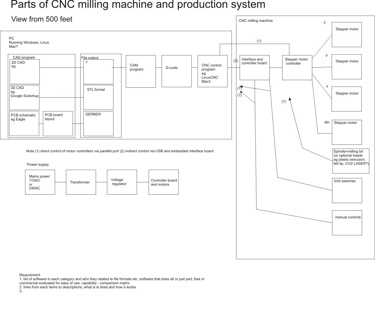

    I am new to CNC and intended it for hobby projects. There seem to be a great range in cost from £100s to 10s of thousands. I wasn’t about to find a web site that gave an overview of CNC routers/mills, i.e all the components parts and workflow. I have a diagram of what I can glean and nwould like to invite site users to comment and improve the diagram for CNC newbies. I wish to create PCBs, engrave, cut shapes from sheets, render 3D shapes, drill holes in materials such as acrylic, copper, brass and aluminium alloy (softer alloys 1000 series pos 5000 series). Is this feasible on a £500-600 budget? Thanks for any help.

    Probably your best bet would be to read through some of the build logs, this will help explain a lot of things you may have questions about & give you a better insight into individual components which vary in cost tremendously as do complete machines.
    Unlikely you are going to be able to buy a machine that will do everything you want it to well with that sort of budget. What sort of size machine you would like will also play a big factor.
