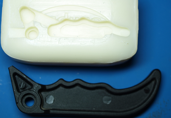

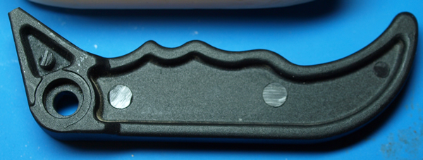

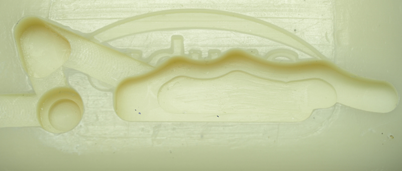

    Well this this is my bar of soap lol.
    I did not do the outer profile last night just the inner ones.
    I had a little trouble with the set up of the machine and set the Z too low.
    When done it should look like the black bit of plastic lol I wish
ID:	3436Click image for larger version.
