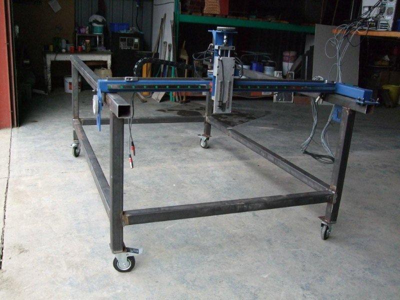

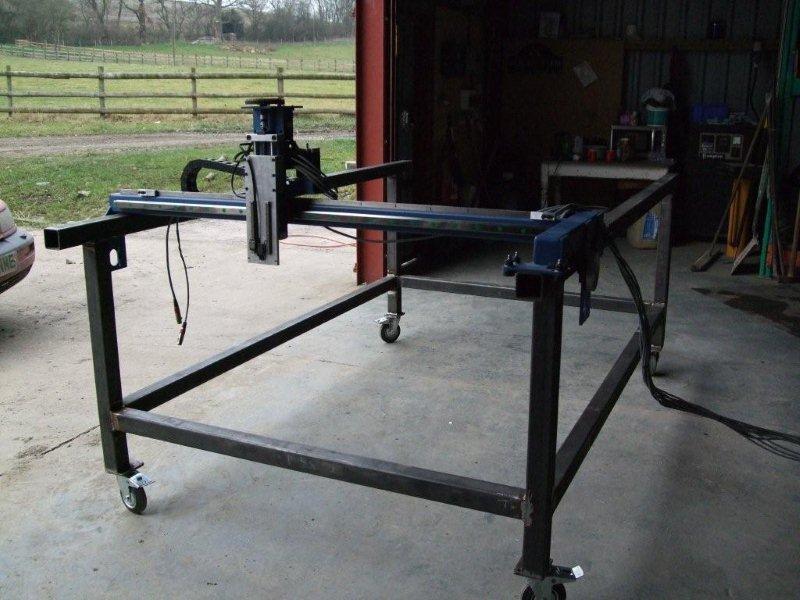

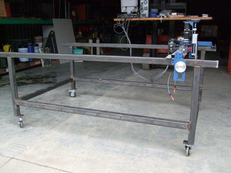

    Hi All
    Just a quick update, I have started on the table ( will get some pictures tomorrow ) for reasons beyond my control I have made it into a 6`x 4` table, I had 2 off 2Mtr gear racks for the X - A axis and had to buy the cold rolled steel for the runners in 3Mtr lengths so rather than cut a good bit off them and waste it I had another look at the cad drawings and managed to get a 2.5Mtr length table with 1950mm travel in the X-A and 1220mm in the Y from the material I had, from 2 full lengths of 7.5Mtr of 60x60x3 box I only had 2 pieces 40mm long scrap, but I do need to buy another length of something to carry the material supports and the water trough ( if I fit one)
    But standing in the workshop it looks big, and I have yet to put caster on it
    Steve
  9. #8
    Happy Chrismas and a prosperous New Year to all
    just a few pictures for those interested, 4`x 4` taple turned into a 6` x 4` table for no extra cost, I did hope to get the 3"x1/2" Bright bar (coled rolled) for the "X" runners before Christmas but missed the stockholders they closed early, so still need to get them yet.but this is how it should sit, I will put jacks on the corners eventualy, when I work out how or even what I want, Any one any ideas??
    The control box is now finished for 4 axis and works well I still need to get a THC from Jim Cullins at Sound Logic, and 2 more motors for "X" then I can mount gear racks, slatted bed, and "Roberts your Fathers brother!" finished play time begins..... oh and of course PAINT it blue
    did try to upload more photos but after emailing them to my self 4 times to reduce size I still cant get some of them small enough, sorry.
    all the best
    Steve
