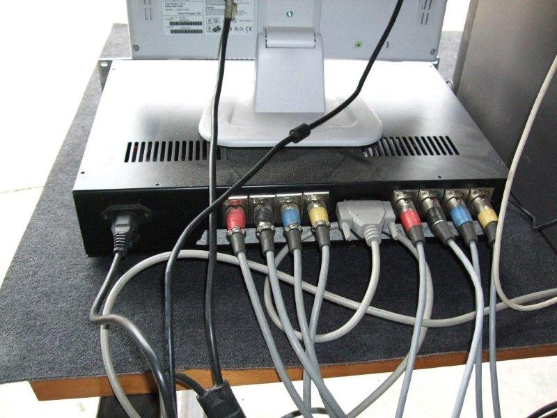

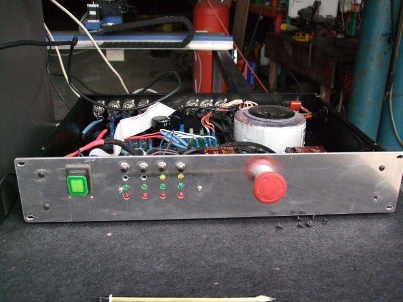

    just a few pictures for those interested, 4`x 4` taple turned into a 6` x 4` table for no extra cost, I did hope to get the 3"x1/2" Bright bar (coled rolled) for the "X" runners before Christmas but missed the stockholders they closed early, so still need to get them yet.but this is how it should sit, I will put jacks on the corners eventualy, when I work out how or even what I want, Any one any ideas??
    The control box is now finished for 4 axis and works well I still need to get a THC from Jim Cullins at Sound Logic, and 2 more motors for "X" then I can mount gear racks, slatted bed, and "Roberts your Fathers brother!" finished play time begins..... oh and of course PAINT it blue
