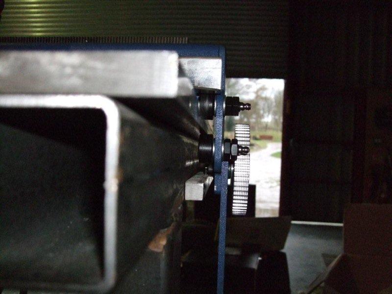

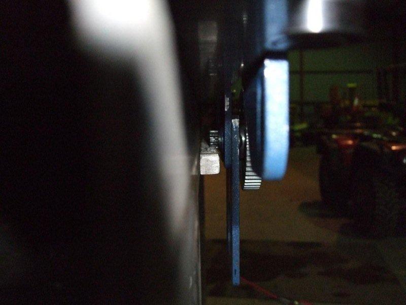

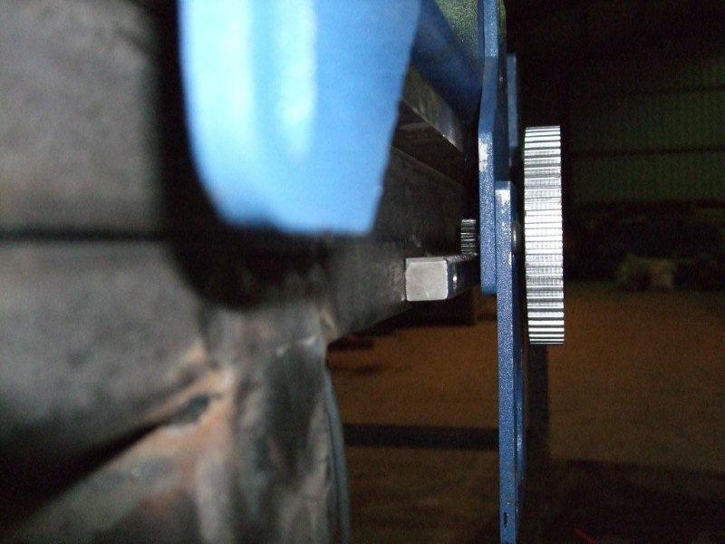

    Hi all
    sorry for the delay in posting pictures, cold weather, hospital, and just plain old lazyness, preventen me from taking them before.
    any how this is where Im up to, any coments or questions please go ahead I like to know im not talking to my self

    Great pictures and a solid machine. What stops the gantry lifting as I cant see bearing underneath? Is it the weight?
    Ignore last comment as just realised this is the plasma section
    Quote Originally Posted by progomez View Post
    HI
    Thanks for the comment, good point there just not fitted yet, nor are the end stops, its still work in progress, Im still 2 motors short, I did order some but when they came I realised I had ordered the wrong ones,
    Steve
    Hi Steve,
    would you not have been better off mounting the rack and pinion the other way up to keep dross off it?
    (or are my eyes in upside down again):p
    that would aslo have stopped the gantry rising
    Jeff
    Quote Originally Posted by Smiler View Post
    Hi Steve,
    Jeff
    Yes it would have been But when I did it it got in the way of the under side (anti lift) cam followers (not fitted in pictures) but in hind sight had I mounted them the other way up I would not have needed the followers, there is still time to have a rethink yet, but put a single motor on the "X" today on the one side only and it runs sweet as a nut, it traveled the 1.9 mtr in 13 seconds fast travel no binding or high spots..........what do I do????????
