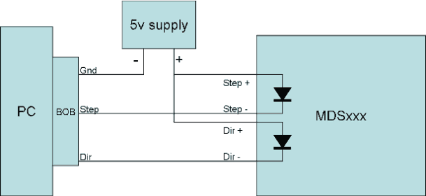

  1. Quote Originally Posted by bruce_miranda View Post
    I am using a similar BOB but was half the price and made by a CNC user, the board is milled on a CNC machine itself and comes with 4 PCB stand-offs.
    http://www.cncdoctor.co.uk/ParallelP...ard(P.004).pdf
    Bruce. That BOB MUST be used driving the opto's in ACTIVE LOW configuration. It will not have enough output drive to drive the optos in active high mode. The signals on the MDSxxx are labeled thus Step+, Step- and Dir+, Dir- The - connectoins neednto go to your driving signals and the + connections to a source of +3.3 or +5v power. This can be got off a USB connector, off a spare disc power connector inside the PC or via a cheap 5v regulated wall-wart.

  2. #32
    So the ACTIVE LOW configuration needs to be done in Mach3 for the Motor Outputs correct?
  3. Quote Originally Posted by bruce_miranda View Post
    Yes you will need to tell the software which way up the signal is... The MDSxxx series of drivers recognise the rising edge of the signal so the PC must pulse the output LOW to cause the required motion.
  4. #34
    Do I need to change anything in the Driver i.e. Jumpers or anything or can I leave them as default?
  5. No the drive does not need to be changed for sinking inputs.

  8. #38
    I have GOOD news to report, my motors are now spinning very well. I used the USB to supply 5V to the drivers and everything suddenly started to work.
    Thanks a lot irving2008.
    Oh in the meanwhile I also rebuilt my laptop and then reconfigured things using these instructions here and everything works quite well. http://pminmo.com/PMinMOwiki/index.php5?title=Laptops
    I have now an issue where if I jog the axis suddenly at no certain point the motors will stall but if I release the key and jog again it continues just fine. Jogging slower the motors stick less often but still stick about once per end to end travel. How do I resolve that issue.
