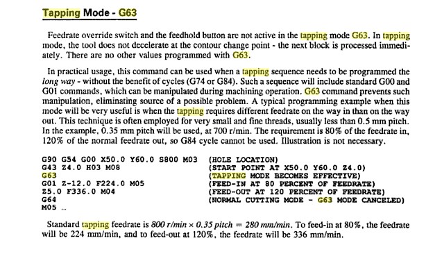

    I have a task on my college course now this is not cheating because I have scoured the net for any commands that go along with the G63 and nothing.
    S the question is is there a fedd or ass commands that go with a G63 tapping command?
    The material is 10mm 6082 ali and the tap is a 4mm all the way through and it is a tapered tap so it will have to go further to cut the full thread the job is in a vice so this is not a problem.
    Any help would be great lol so far have hand writen this job and am up to line 830.
    We have to do it hand first to show we have not used a CAM program and so the instructore can see the way we think as we are doing it( poor guy has to read it all and there is 5 of us on the same course)

    In seriousness though you need to look at peck drilling with depth and speed params set at something sensible i believe? not tried it myself. Look at the guys on you tube and they will send a tap straight the the way through in one go with cutting fluids applied.

    Best I could find on web
    Doesnt say that much about it though!
    peter
    I have read this a couple of times and from what I can see is you think the G63 is a tapping cycle ? I have never used it but from what I can make out it isnt, it is actualy a G Code command to keep the feedrate as programed in the program my lathes use different codes one being m88 .What it does is stop the feedrate being altered by adjusting a feedrate potentiometer on the machine by mistake ,in other words if you program say F.5mm then no mater what, it feeds at that,hope that helps you still need to program the tapping cycle after the G63 then put G64 after youve tapped the hole and move away
