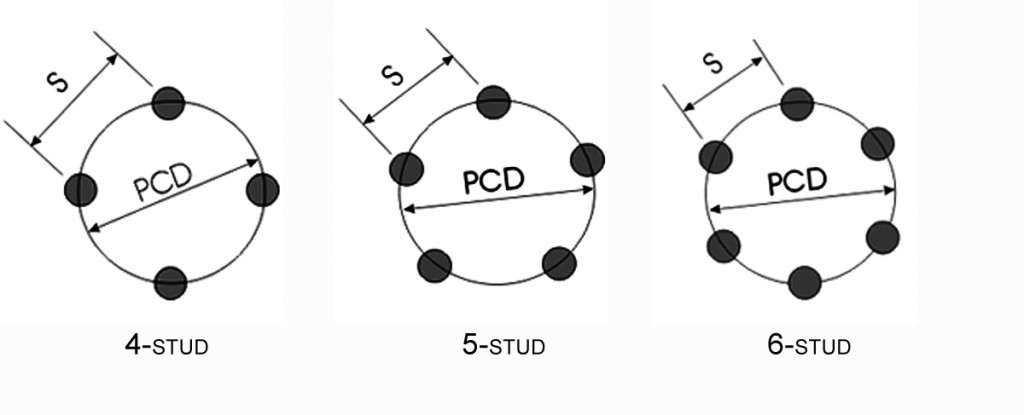

    i can find the formula for 4,5,6 but not for 3 :confused:

    PCD Calculation Formula
    3 stud PCD = S / 0.866
    4 Stud PCD = S / 0.7071
    5 Stud PCD = S / 0.5278
    6 Stud PCD = S / 0.5

    3 stud PCD= S/0.866

    thanks peter star man, added it to the post :-)

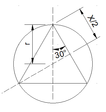

    Ahh, now I understand the question! You wanted *diameter* not circumference at stated in your post.
    It's just cos(30)...
    Let x be side length of the triangle the three points form (i.e 35mm).
    (see diagram)
    Draw in lines on triangle that bisect the angles. So we've now got a smaller triangle with one side length x/2, and we know the angle indicated is 30 degrees, since it's an equilateral triangle and we've bisected the corner angle.
    cos(30)=(X/2)/r
    r=X/2/cos(30)
    r=17.5/cos(30) = 20.2072594...
    (since d=2r, d=X/cos(30))
    Incidentally to help remember it cos(30) is just sqrt(3)/2 = 0.866025...
    Hope that helps. You can get the other PCDs using similar methods. 4 is half root 2.
Name:	PCD diagram.png
