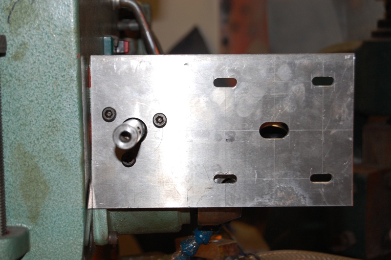

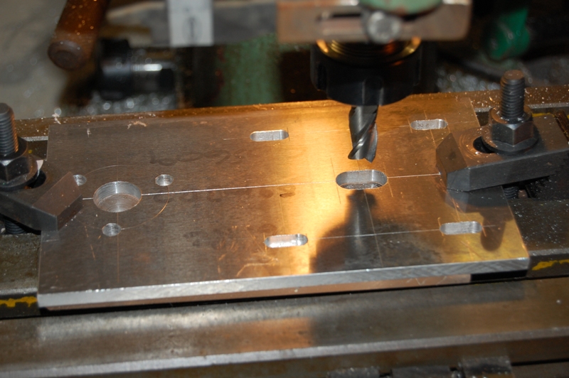

    well my ally turned up so made a start on the z motor plate
    all i could think of when making it was, if the mill was finished i would just be watching it being cut.

  7. #67
    Quote Originally Posted by h4ppy-chris View Post
ID:	3552 Click image for larger version.

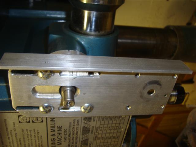

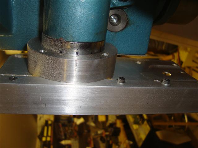

    Similar to how I did it except I mounted the motor plate 90 degrees clockwise to yours, and lathed a bit of 3" aluminum bar to act as a spacer and give a bit more surface area for the motor plate to bolt on to. Doing it that way enables me to use the handle for manual drilling without removing the stepper - I think yours would collide?
  8. #68
    good point jonathan, i will wait till it's all working then make a new one.
  9. #69
    Here's a couple of photos of mine, pretty self explanatory...
