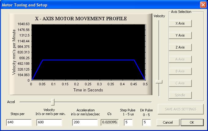

    motor tuning is doing my headin :confused::confused::confused:
    i want my motor to turn 1 rev and when it does, i want it to show 5mm in mach.
    my motor is 200 steps 1/8 any help pleazzzzzzzzzzzzzzzzz

    steps per = 320 errrrrm.... hang on, what micro step setting are you using on the board ?
    its ages since i did mine, if your using 1/16 micro step and your screws are 5mm pitch then you have 1600 steps per revolution of your stepper that adds up to 5mm
    devide your seps my 5mm to get your 320 steps per unit (1mm)
    i think :)

  6. #86
    steps per mm = motor steps*microstep/screw pitch
    For instance, 200 step motor, 5mm pitch screw and you say 8th stepping:
    200*8/5=320 step/mm
  7. #87
    i tryed putting in 1600 steps, put 5mm into mack and the motor span 2.5 revs ish.
    when i use these settings and put 5mm in i get 1 rev this is why it's doing my headin :rofl:
    what am i doing wrong.

  8. #88
    Chris
    The formula is 200 X (Micro Steps ?) = steps per rev
    The amount the screw turns 1 rev (5mm i think in your case)
    In my machines i use 10 microsteps so the formula is 200 x 10 = 2000 / 5 = 400 steps per rev
    The velocity in the Mach setup tab is the fastest you are allowing the machine to run in your case you have set it to 600mm per minute which is on the slow side
    So if you divulge you micro step setting your figures can be confirmed but 640 (Your Setting) steps per equates to 16 microsteps and the generally accepted maximum is 10
    Phil
  9. #89
    how did i set it to 16 microsteps? is that the 1/16 setting on the board, and i need to change it to 1/8?
    i have set the dips to the 1/8 setting at the mo.
    this is from the post on these boards
    "The 1/8 step was reversed with 1/16, a fairly minor problem but still irritating as I had a scaling error on movement until I figured it out."
    by the way a BIG thanks to all that have helped me so far.
    there is no such thing as a stupid question, just stupid answers !!!!
  10. #90
    Well if you have it set to 1/8 then steps per rev = 320
    Phil
