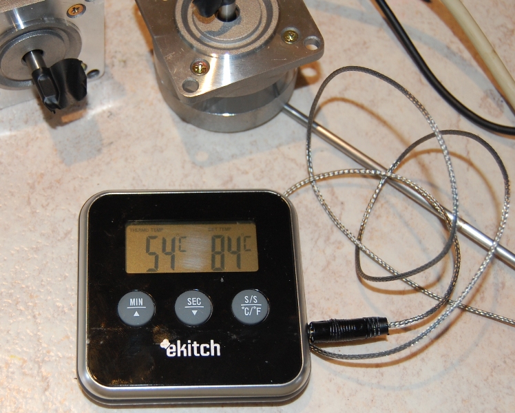

    I hope not... 85degC absolute case temp is the maximum recommended temp you should run a stepper at - higher than that and you risk internal breakdown and demagnetisation.... remember inside its going to be a lot hotter!
    an 85degC case is too hot to touch for most people. Maplin do a cheap £19 multimeter with a temp probe thats a useful bit of kit for playing with electrics...
    Sorry, yes - 130 degrees max internal which is about 85 degrees on the case. This website seems to think 70-80 degrees is normal - bit of a useless temperature that - hot enough to want to avoid touching but not hot enough to make tea.
    80 degrees above ambient is pretty tepid in my garage at the moment so I don't think it will be a problem for a while :-)
  4. #14
    well i tested the temperature 54c

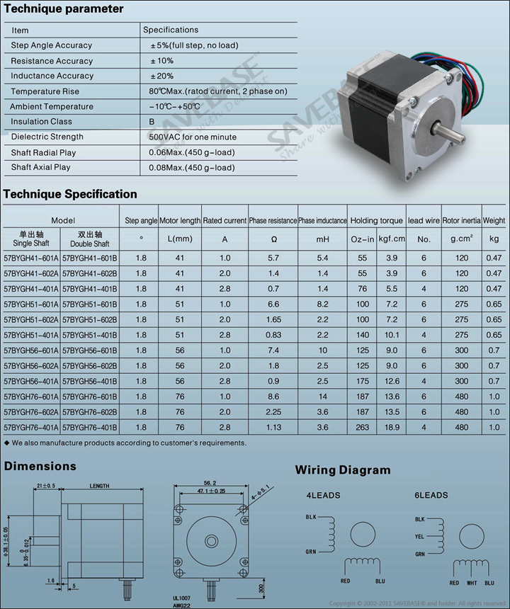

    what motors should i be looking for? the board i bought is the 2.5amp and 24v PSU.
  9. #19
    Quote Originally Posted by h4ppy-chris View Post
    Depends greatly on the size of your machine, are you using ballscrews/ACME etc. With only 24v you want a motor with very low inductance to get any reasonable speed.
    reccomended v=32*L^0.5, so rearranging that:
    L=(24/32)^2=0.56mH
    So your looking for a motor with an inductance ideally lower than 0.56mH, and sufficient torque...you'll be lucky to meet those criteria so just find as close as possible.
    Hope that helps...
  10. The Following User Says Thank You to Jonathan For This Useful Post:
  11. #20
    sort of helps, from this which would you say is the best to go for?
