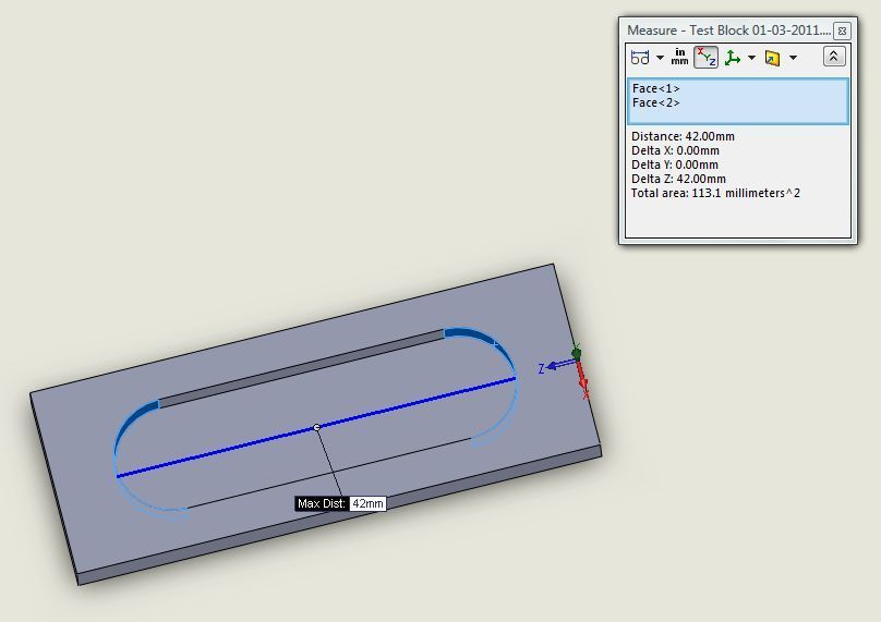

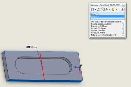

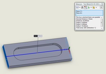

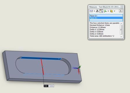

    Just thought I'd put my model with a few dimensions just to show how far out the machine is.

  2. #32
    Hi Anstals,
    As you are using ballscrews you should have negligible backlash so i don't think that is you're problem.
    Looking at the finish on the part I'd say you have play in the jibs X &/or Y or the Z column could have excessive play in the housing.
    Have you checked the amount of backlash you have "Do you know how" ?
    Phil
