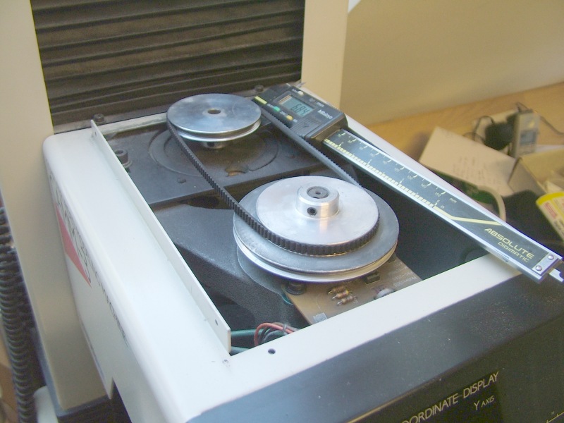

    The drive is a 100W open frame AC motor, not too noisy but has a bit of that ol' Black and Decker whine :naughty:
    Tempted to fit a silent Ampflow E-150, as used by killer robot freaks...
    http://www.active-robots.com/product...w-motors.shtml
    The spindle pulley has relective panels which convert to a voltage. That voltage is compared to a variable resistor poking out the back. The mains to the motor is then switched on or off using an opto isolated triac to set the speed.
    I'm wondering if I could just divert the motor drive to a 400VA transformer, rectify it and call it DC for the Ampflow. Or, would it boil? It would need a monster cap to smooth it. Where's Irving?
    I reckon replace the vee belt with a timing belt and aim for around 1000-> 2000 rpm. Don't think it will handle much over 3mm tooling, 5mm would be pushing it.

    Glad the machine arrived OK. It was well packed alright but better to go with the overkill. It is a nice machine, pretty sturdy. I would have liked to change some of the components but just was busy running parts so never had the time. The yahoo group has alot of info and people who have added components and made fixtures.
    I ran a 6mm bit on aluminum on a few programmes with the air cooling and it didn't have a problem as long as they are small cuts. It would be better with a timing belt and a flood coolant system but I used the air as I never thought I would get to fitting one.
