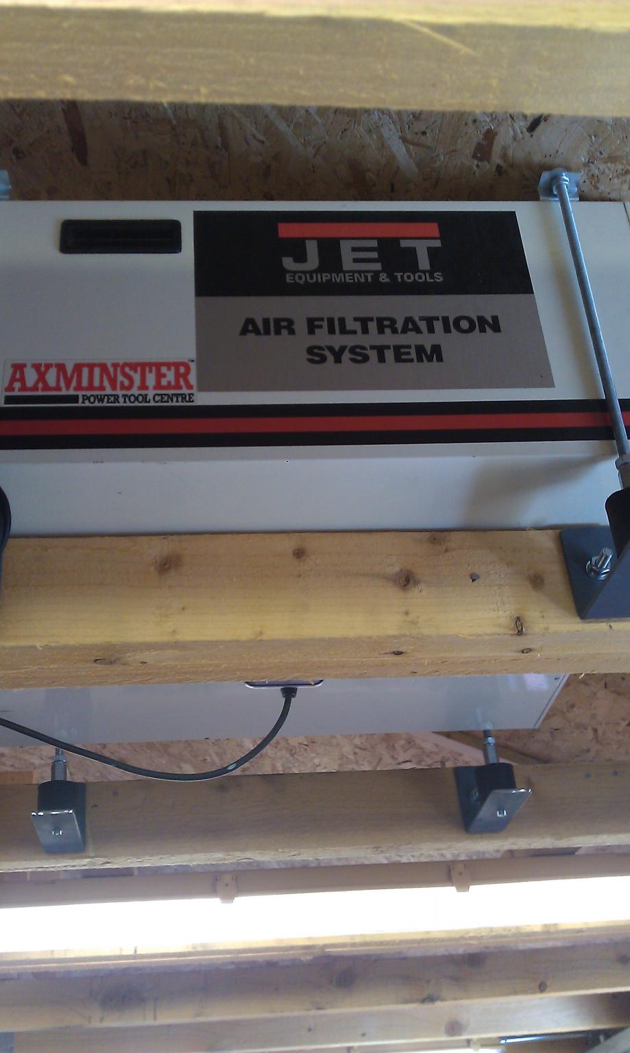

    I have an extractor in the workshop which is a steel drum with two 1000w motors inside the hood. This makes a good extractor and vacuum for cleaning up the floor. I also have a sliding attachment to fit to the back of my lathe which the extraction hood runs along so that I can move it to suit where I am working. I also have one of the Axminster box type air filters in the roof space of the shop as well for filtering the air. This works quite well but if I ever wanted another I would make one from 9mm mdf. The unit is simply a box with a fan at one end and a filter at the other. Rolls of filter material are not hard to come by and a simple kitchen type extractor fan would do the job.
    Photo of my air filter installed in the roof space above my wood lathe. These are good for collecting all the dust that the extractor misses.
    Ian
