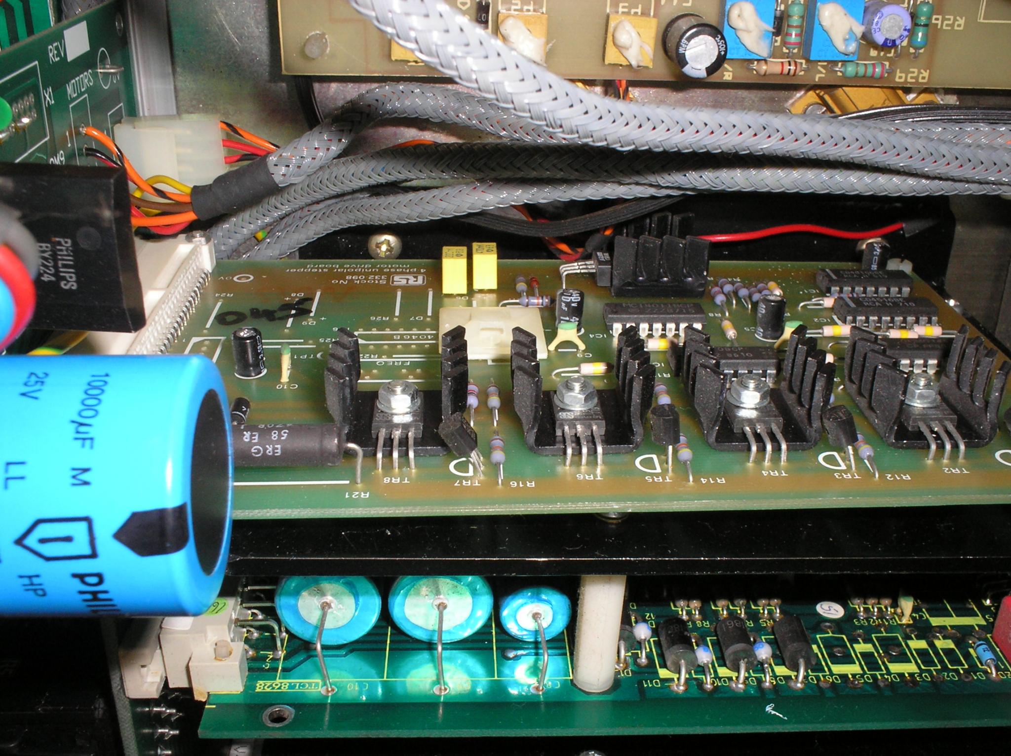

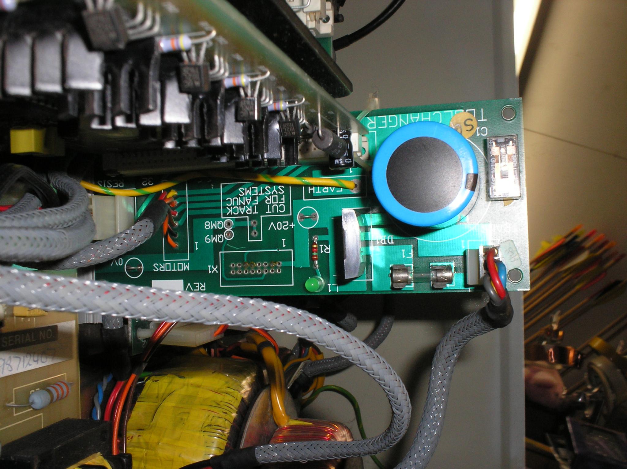

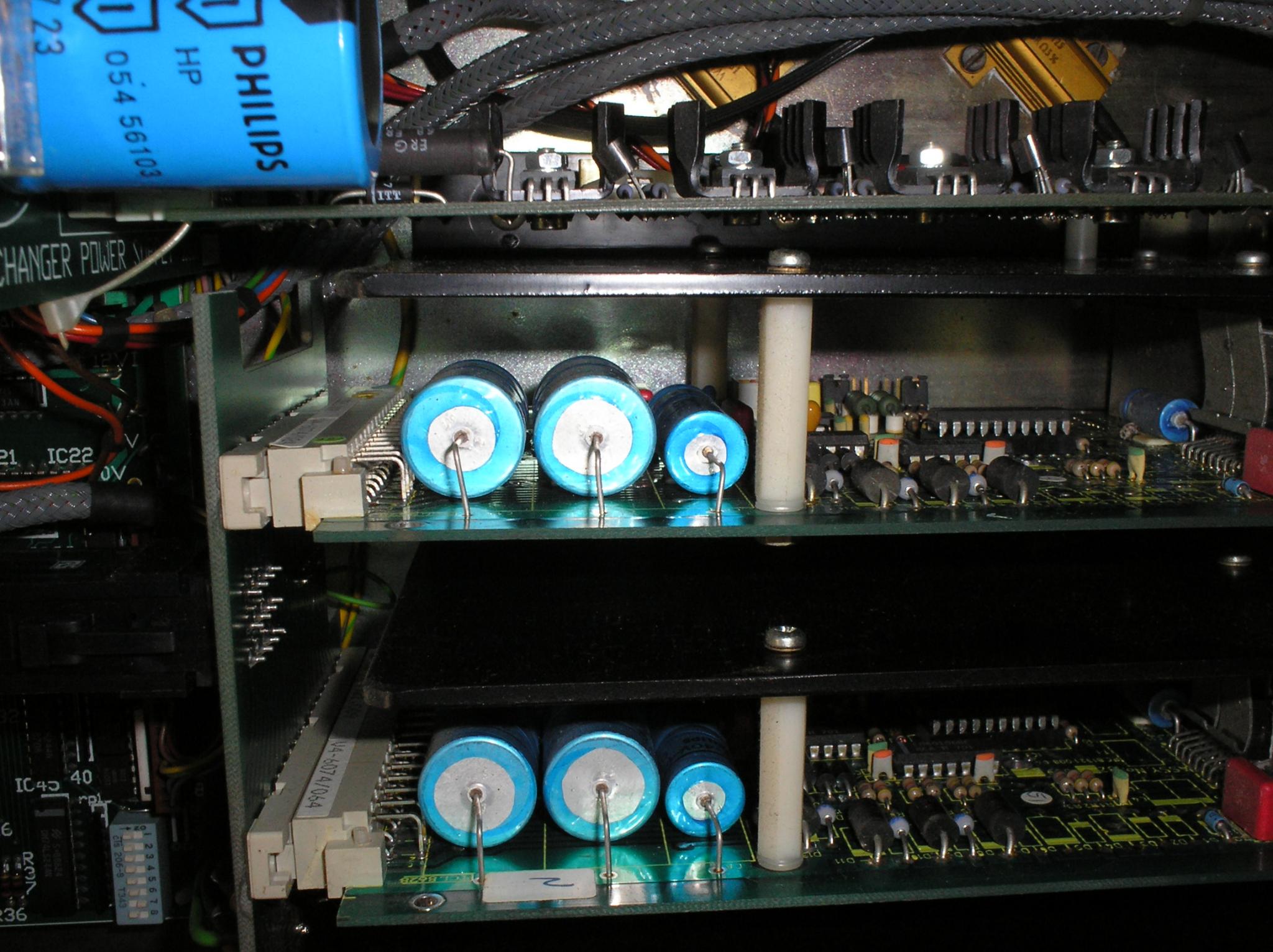

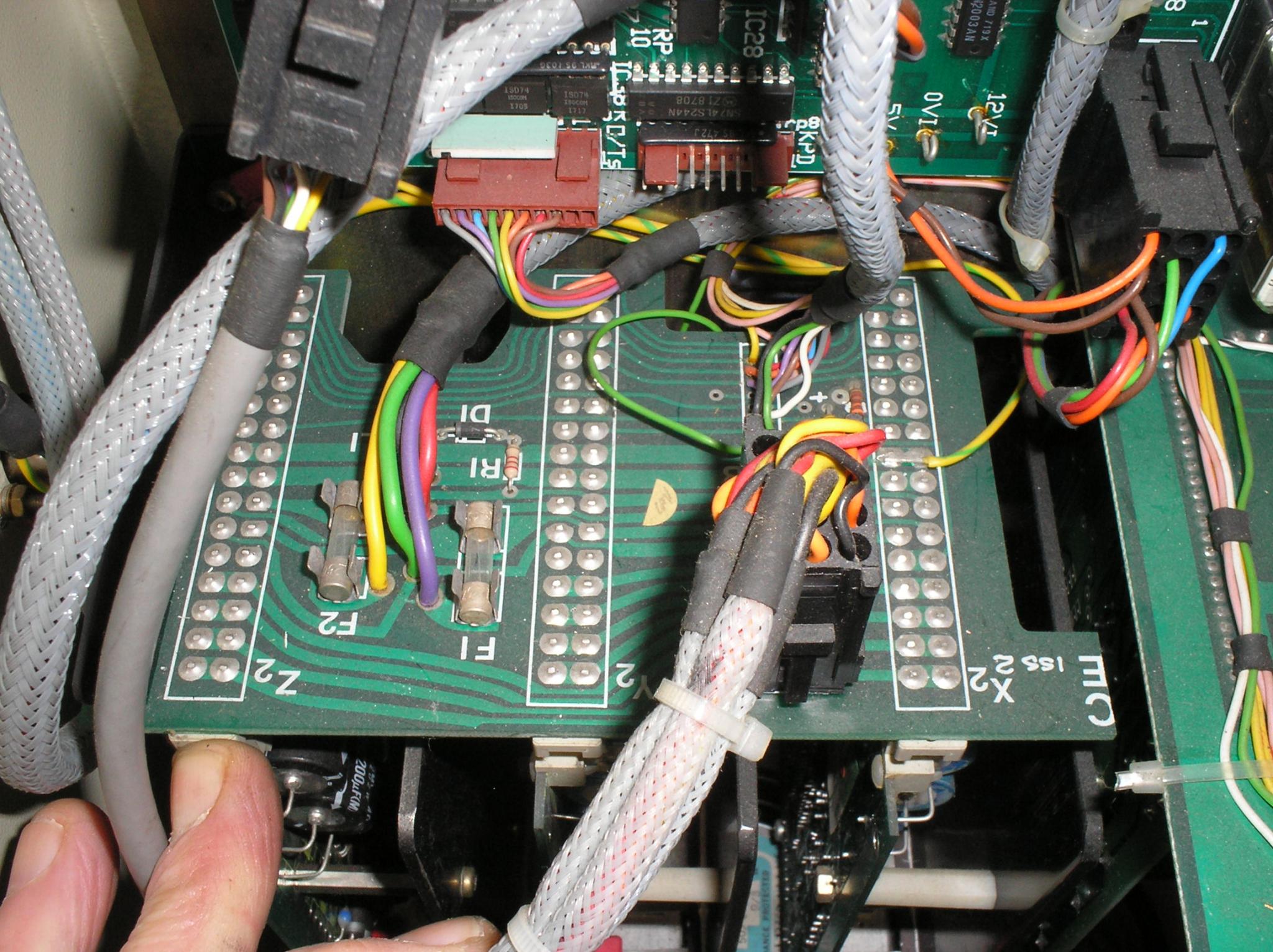

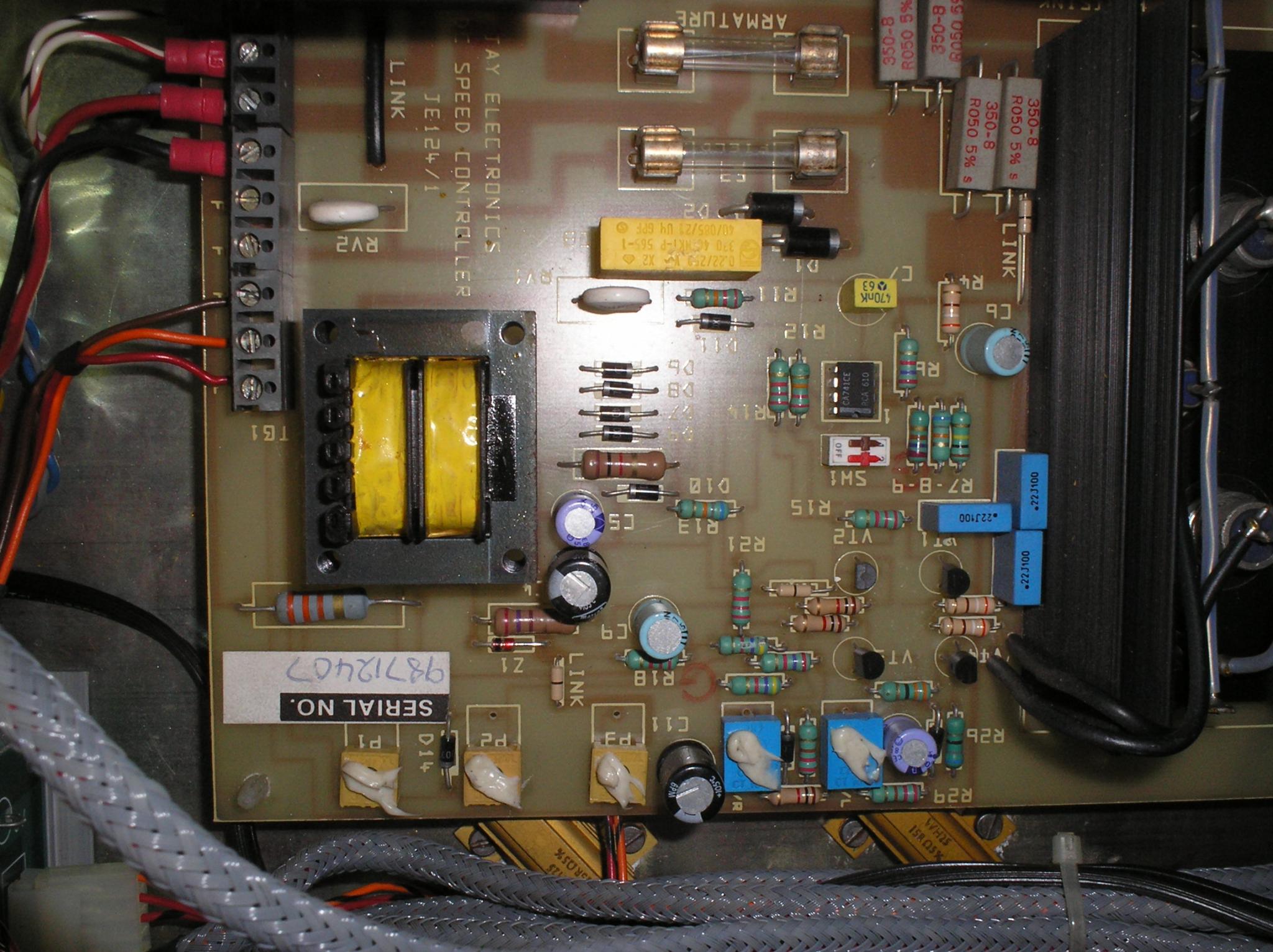

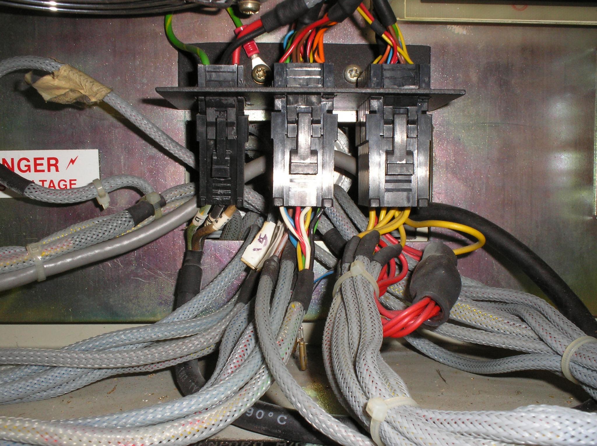

ID:	3605I have hard a good look at the circuits in Click image for larger version.
Name:	Tool change PSU.jpg
ID:	3604the back of the Starmill. I can't be certain but out of the two types of drive on that Denford link you posted, the sd range looks closest.

    The Spindle board is- Jay Electrical DC speed control JE124/1 seriClick image for larger version.
    The tool change psu 122ve.
    I have received parts from Maplin to make buffer but haven't got a clue where to connect up. Phil.Click image for larger version.

  7. #27
    i2i's Avatar
    have a look at the end of the stepper drive boards and it will state what type they are, probably a cd20 or sd 20. Page 23 of the digiplan drive manual shows the pinout for the end connector, and pins 26 and 28 of row c are the dir and clock positions. You'll need to find the wiring that feeds these signals into the drives and isolate them from the main board, then it's simply a matter of putting the buffer board between the breakout boards output and these points

    i2i's Avatar
    with the spindle board, do the red orange and brown wires go to a pot for varying the speed.
