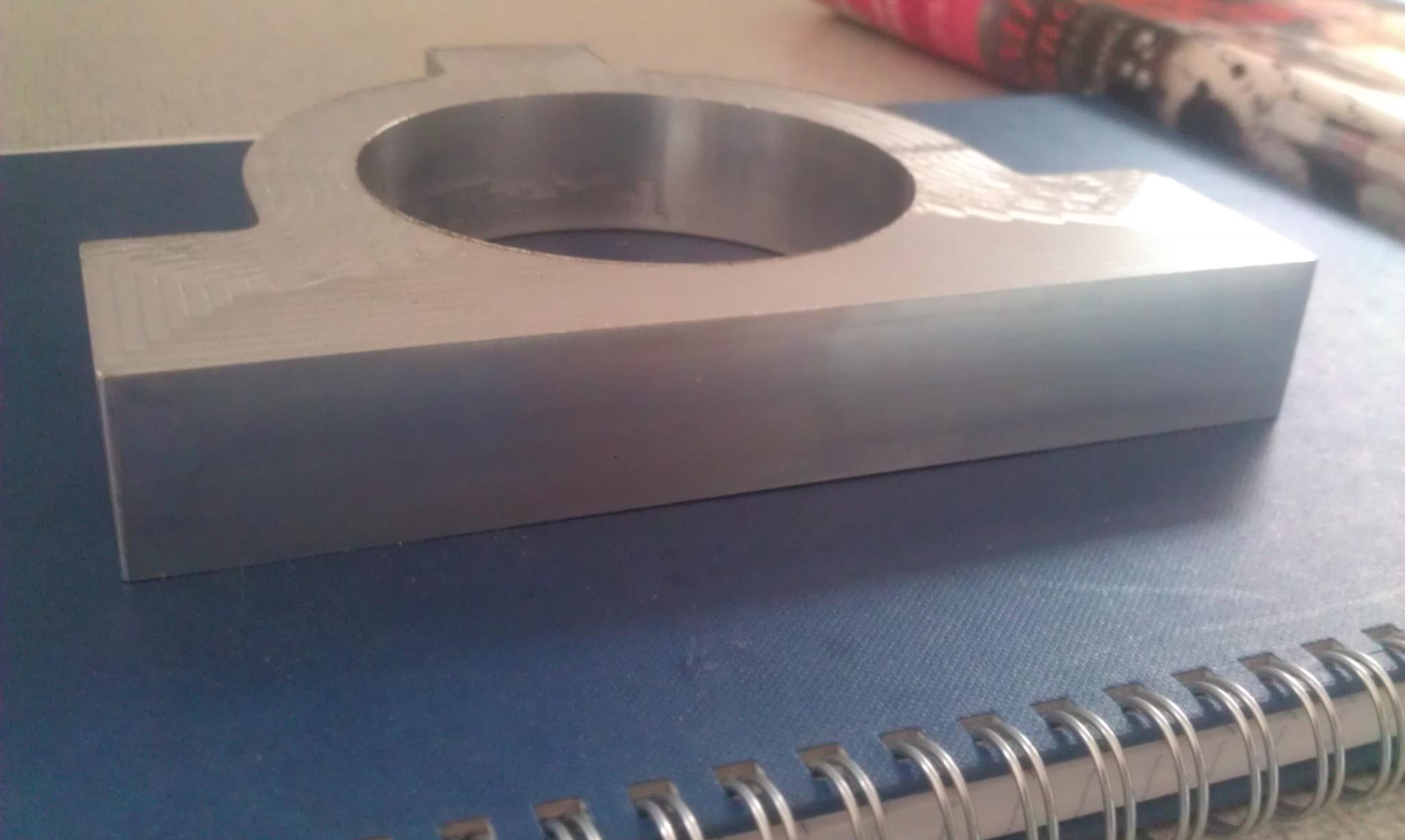

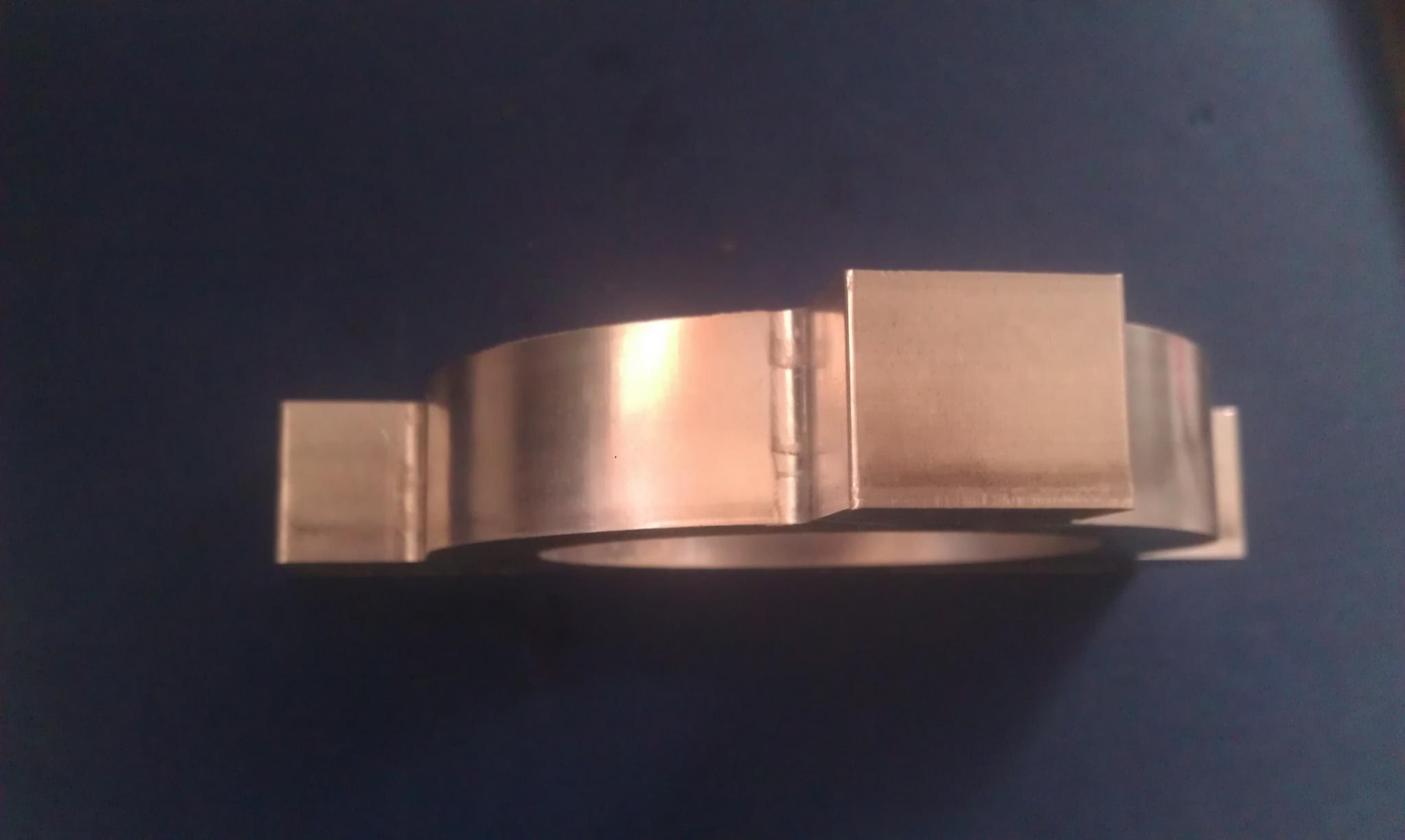

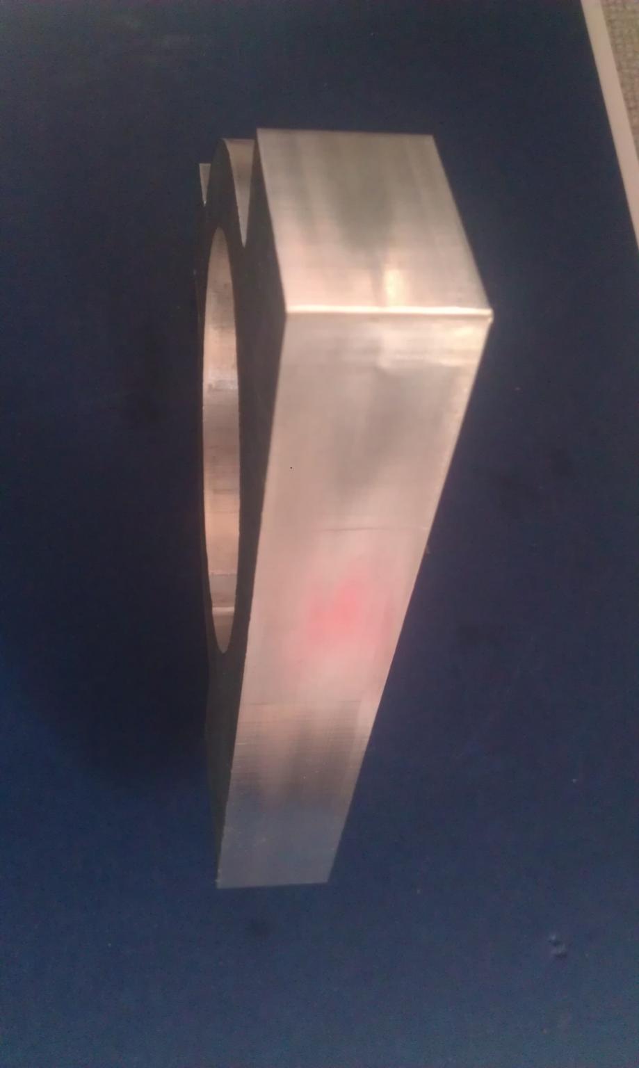

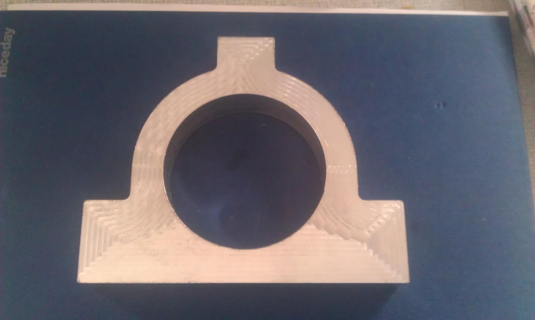

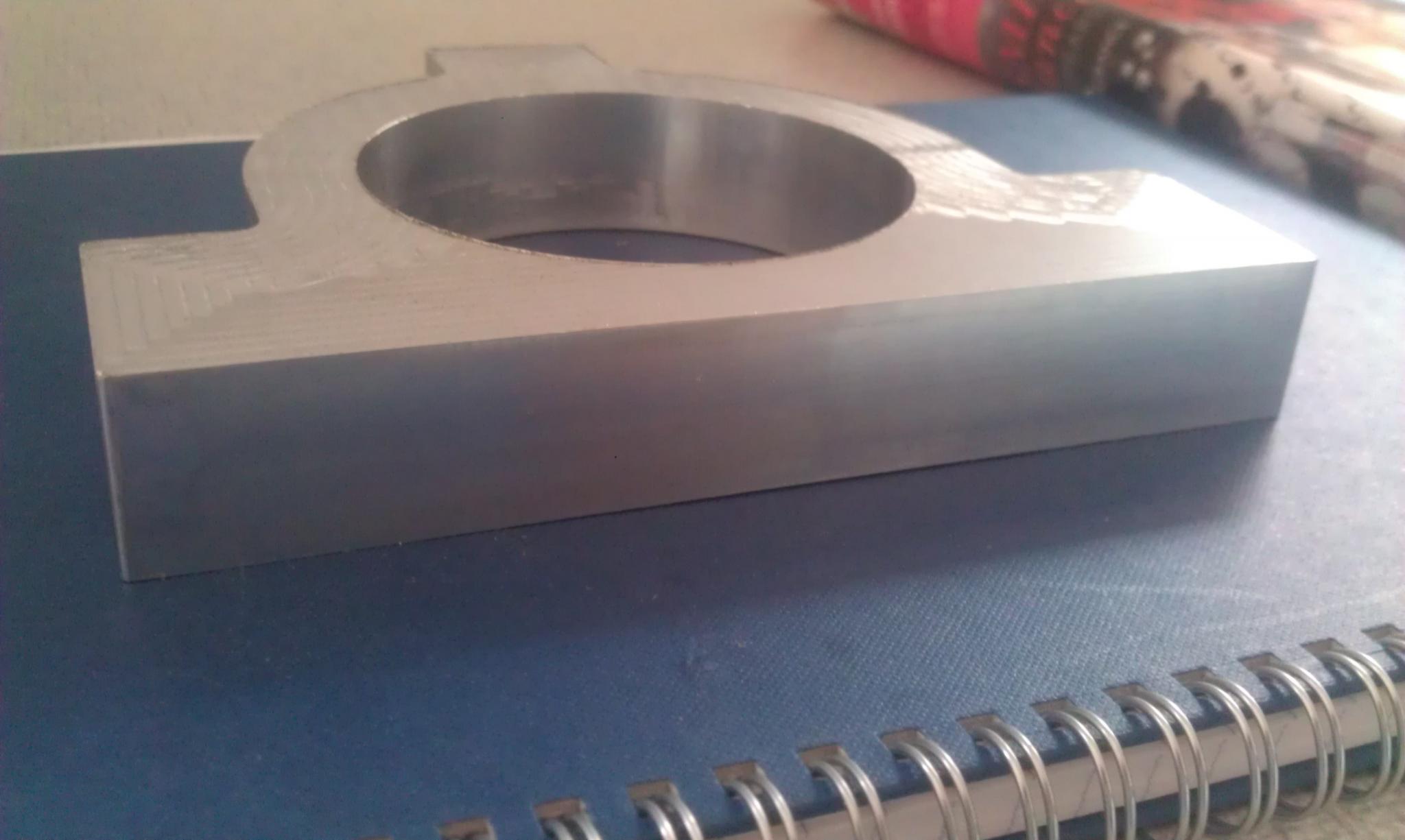

    Had a shot at cutting some new spindle motor mounts today. The first one is cut and it came out well. I used one of the single flute cutters from ebay.

    There is a litte bit of marking on the third photo at one of the corners but its nothing to worry about. This is cut from 25mm thick alu. Inner size was programmed to 80.5mm and it came out 80.4mm so thats fine as well. Just need some more time to get the second one done and get them drilled and tapped out for fitting.

  8. #97
    Hi Ian,
    The corner marking is chatter probably due to radius being the same size as cutter, if you can make your radius just slightly larger than the cutter this won't happen.
    Nice job as well by the way.! great aint it watching the machine build it's own bits. .

    Jazzcnc,
    thanks for the info on the cutter radius. It was a 3mm rad and a 6mm cutter. I will alter the drawing for the inner radius corners for the next one. I have alot to learn about milling, this is not something I would have to worry about in profiling.
    Your right, its great watching the machine cut its own parts. I wonder if I can get it to build a replica of itself:lol:

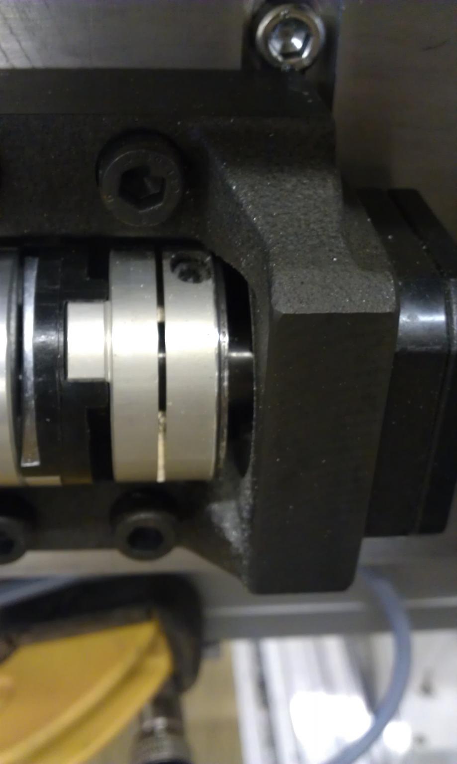

    I have been cutting two new spindle mounts this week to reduce the vibration of the spindle motor. After finishing the second one I had sent the machine to the home position which is where I usually leave it when switching it off. On travelling with the X axis I noticed a grinding sound. On further investigation I found this:
    Looks like the shaft I used to join the motor to the pulley had been working its way through the bearings and had the coupling rubbing against the motor mount.
    I need to strip this out and make two locking collers for the shaft to stop it moving.
    At least it hasnt done any real damage.
    Ian
  12. #100
    Ian there's a big gap between the worn coupling and the bearing mount has it been floating.?
    Sorry but I'm not familiar with your setup and can't tell from this close up pic but that looks like it's an FK bearing in the mount so it shouldn't float at all.?
    Edit: Ok I stopped being lazy and went back and looked thru the thread I understand now, they are FK bearings but also fixed at the other end.!. . . . Still looks like float thou.?
