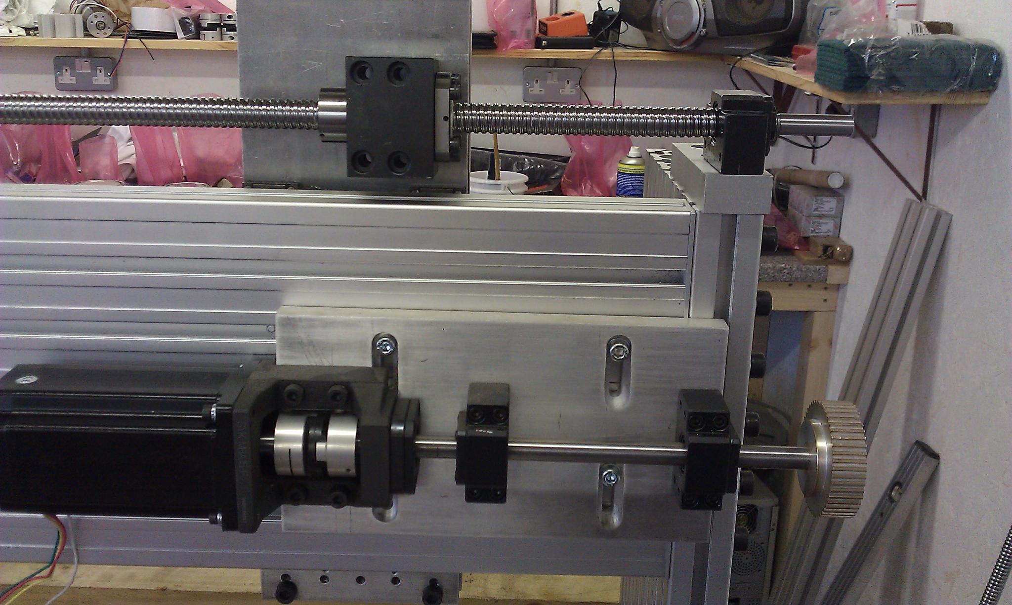

    I read it as the shaft has moved through the bearing block, which in turn has pulled the lovejoy into contact with the housing...
    Ye but what shaft.? Motor shaft.? or Screw shaft.? Either way neither should be floating.? . . .something seems strange.!
    Lives in East Lothian, United Kingdom. Last Activity: 22 Hours Ago Forum Superstar, has done so much to help others, they deserve a medal. Has a total post count of 2,994. Received thanks 376 times, giving thanks to others 9 times.
    This pic from earlier in the thread reveals all.
    The motor coupling would have enough movement in it to allow the pulley shaft to hit the mount without losing drive.
    The shaft that connects the motor to the x axis pulley is the one which has managed to move through the bearings so that the coupling was rubbing against the motor mount.

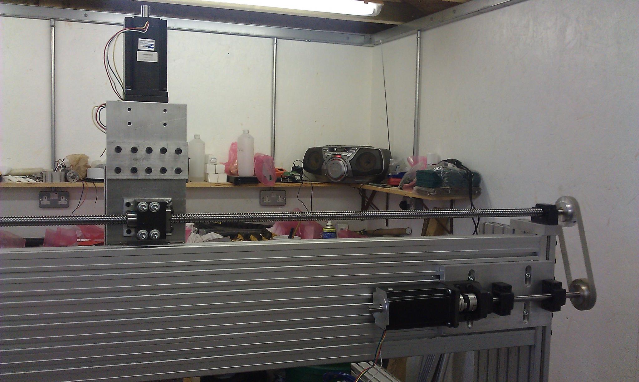

    A picture of the complete motor mount. I didnt think that the shaft would travel through the bearings so I didnt fit any locking collars. I will make them and fit them on the motor side of the last BK mount before the pulley. This will stop any further movement.
    I suspect this has been caused by the pull on the shaft from the tension on the pulley belt but this is a guess. Seeing as I had to hammer the shaft through the bearings I really didnt think it would move.

    Argh I see now but I would call this the Y axis and the earlier post said X axis thats what's thrown me.!!
