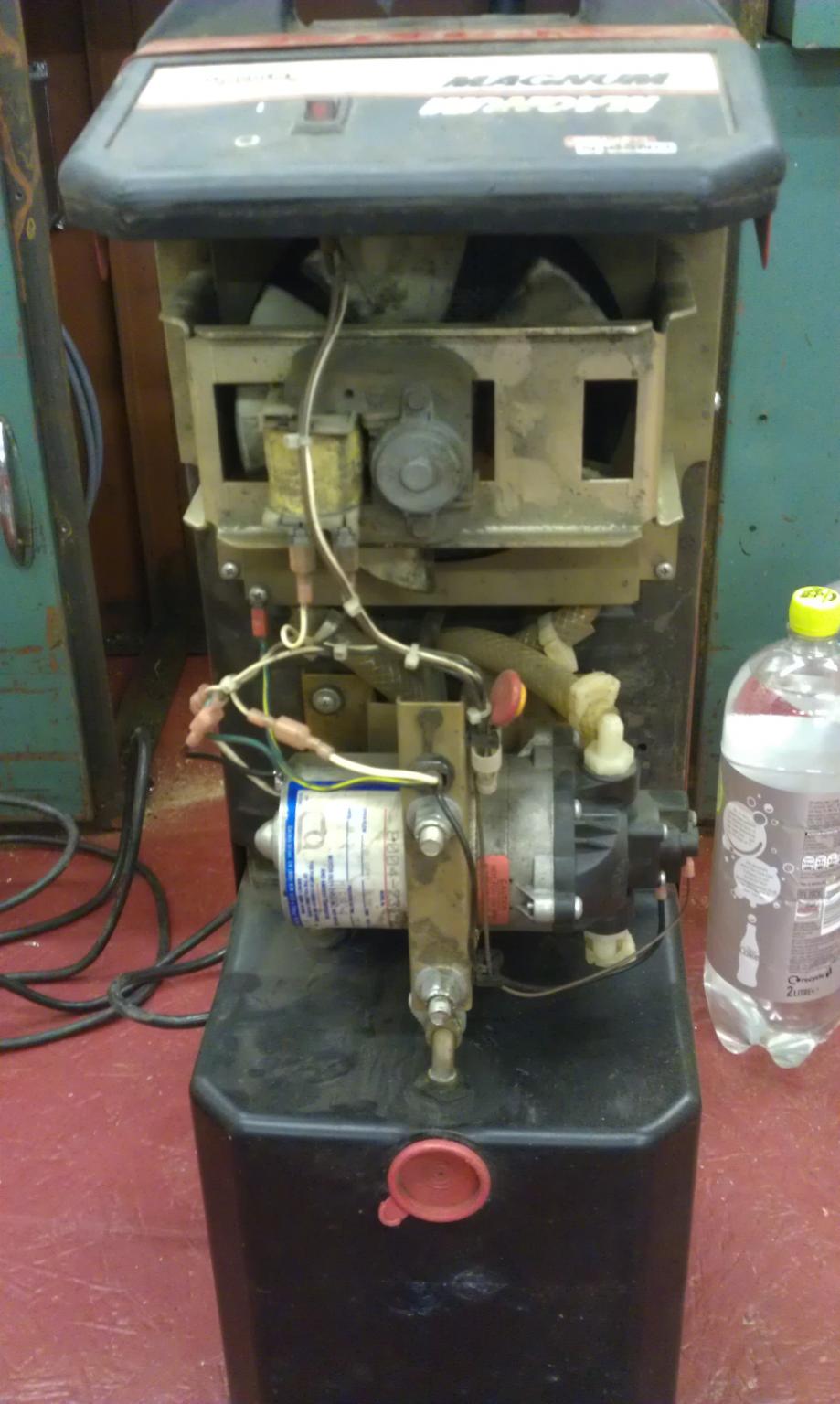

    A picture of the lincoln cooler is below.

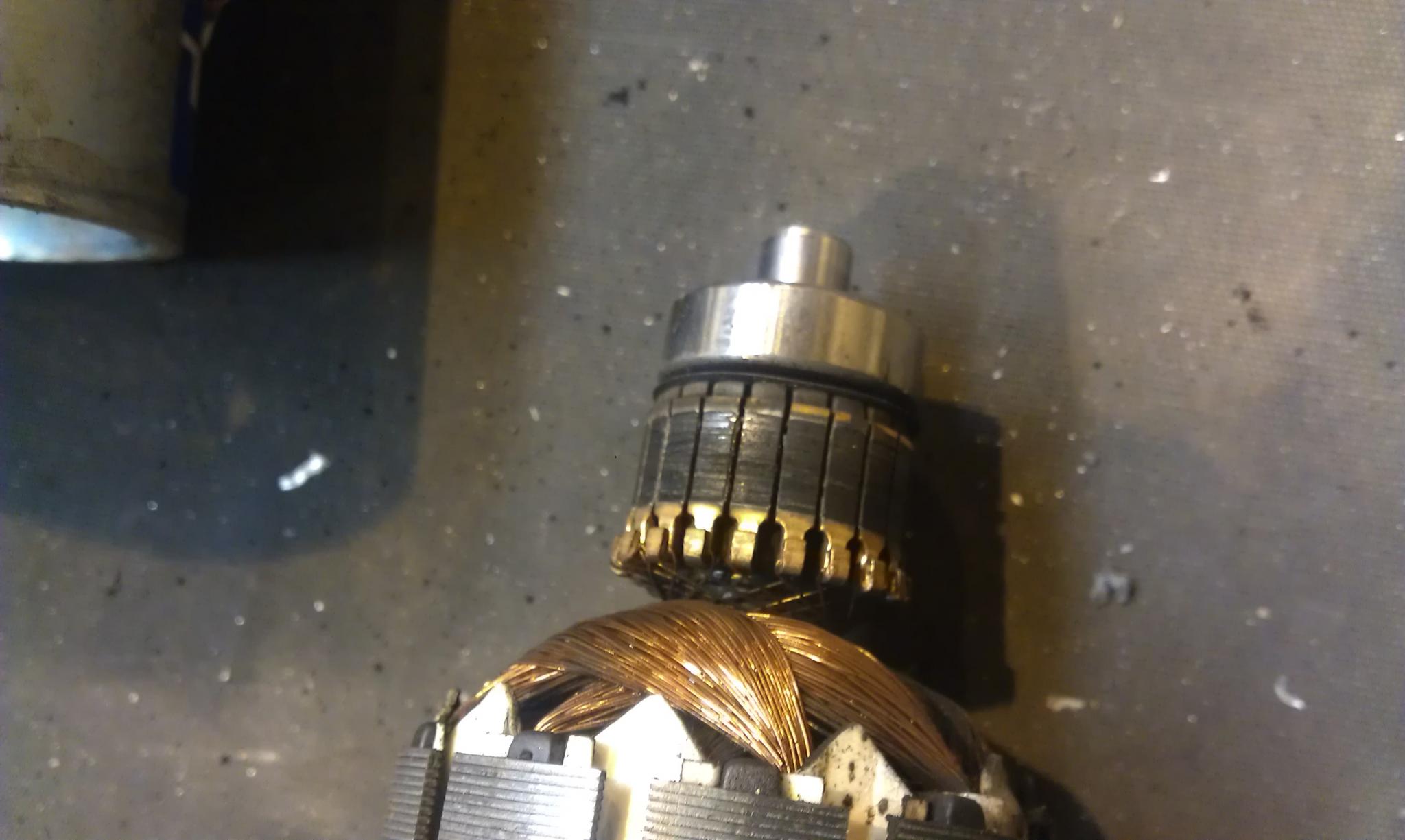

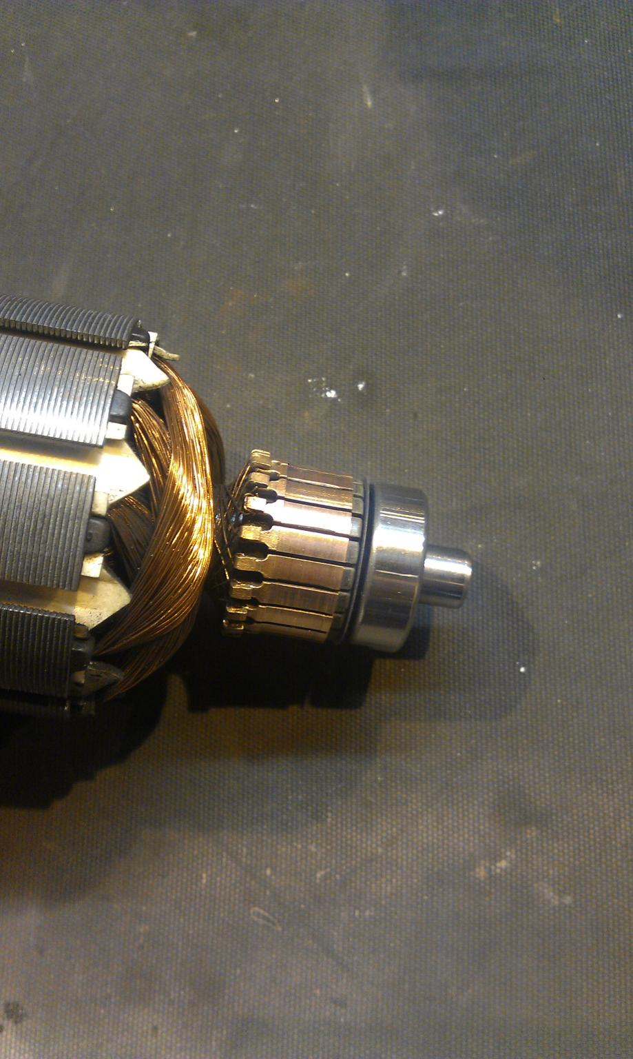

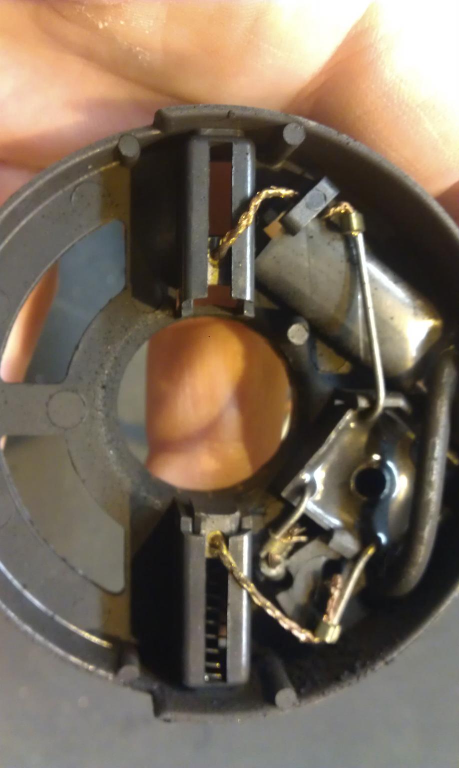

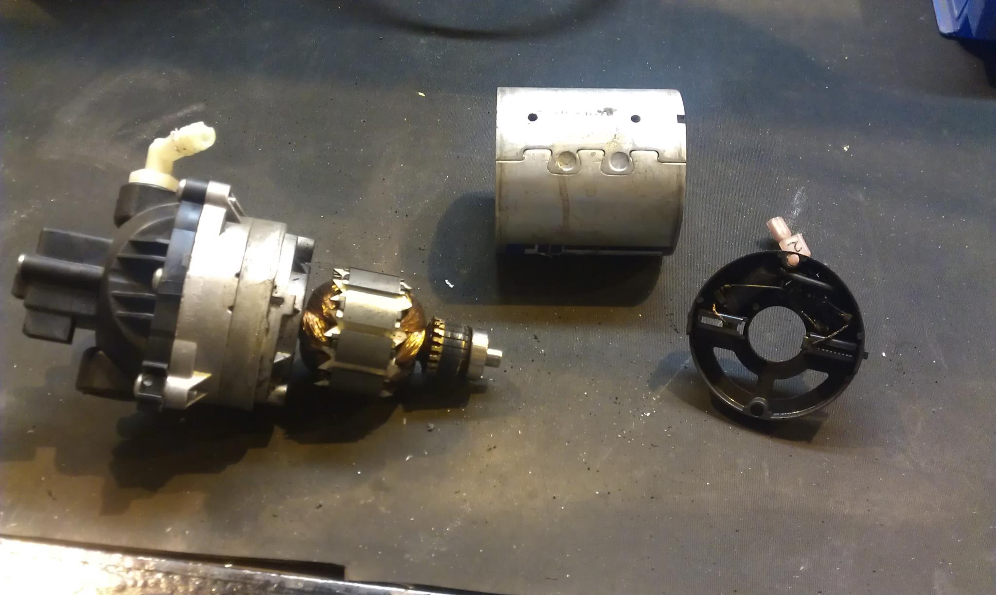

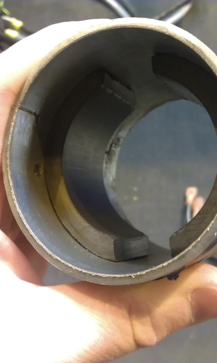

    After powering this unit up I found the motor only ran for a few seconds then died.
    I stripped the motor down to find the brush gear had collapsed and part of the brush holder had vanished.

    The comm is badly carboned up and needed a good clean.
ID:	4421Click image for larger version.
    It turned out fine after a good clean up as did the motor casing and permanent magnet.
    The motor was re-assembled with new brushes and springs and seems to be running ok.

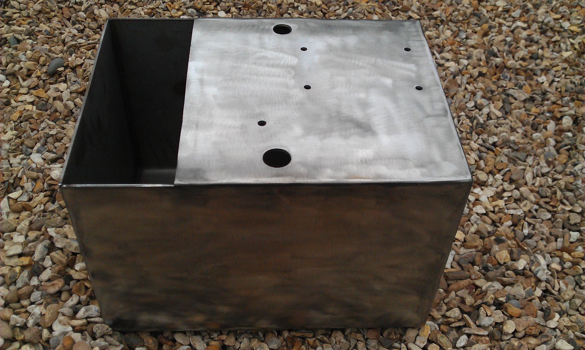

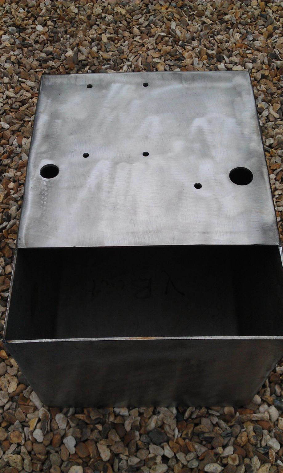

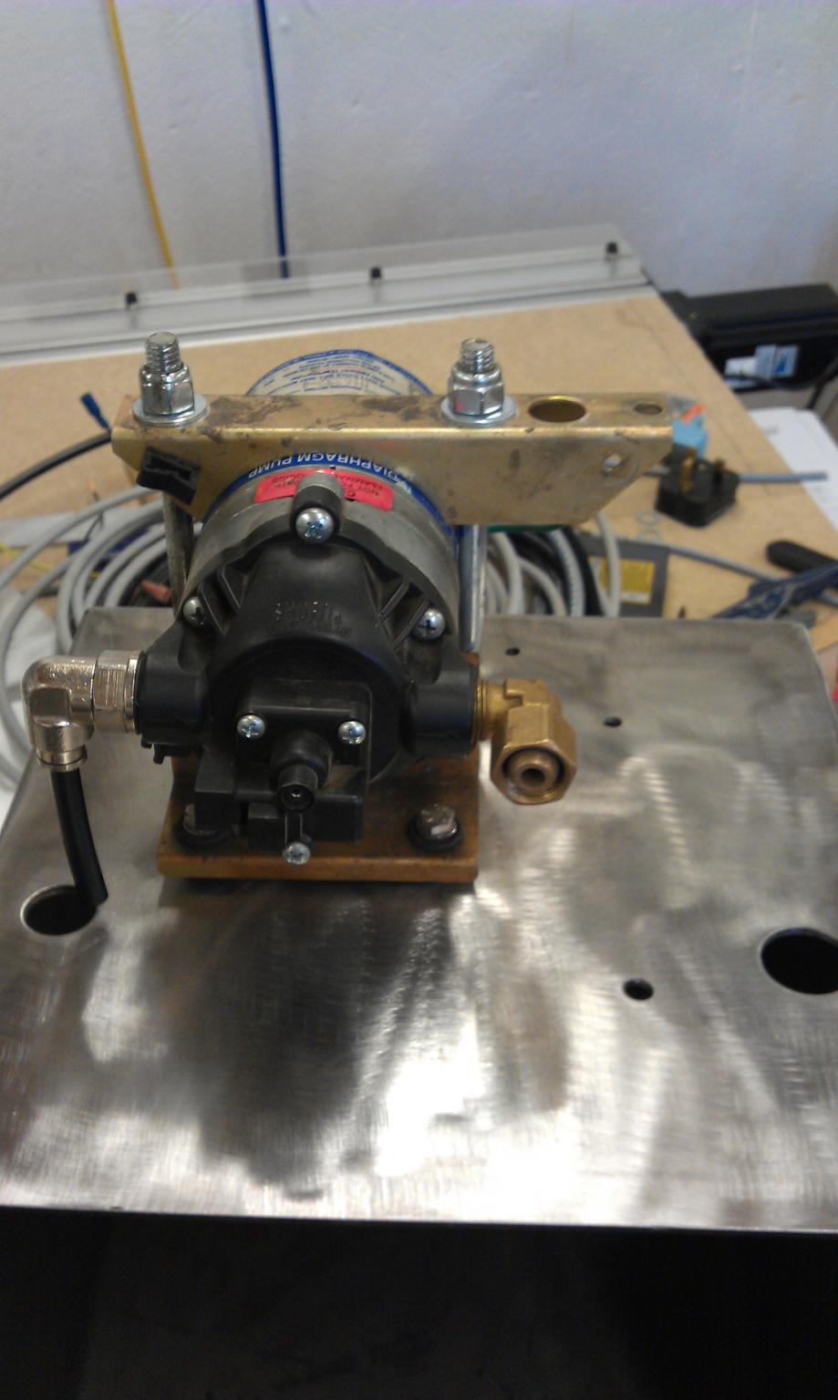

    I have decided to make a new cooler unit from scratch using some of the parts from the old cooler.
    I have fabricated a new tank from 3mm stainless steel. Then fitted the pump.
ID:	4423Click image for larger version.
ID:	4422Click image for larger version.
    As usual just need some more time to get it finished and tested now.
    Ian
