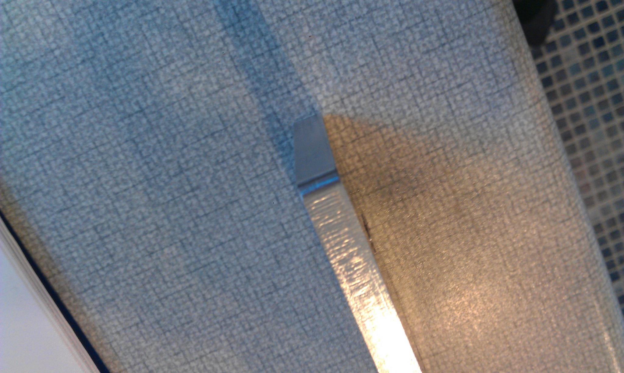

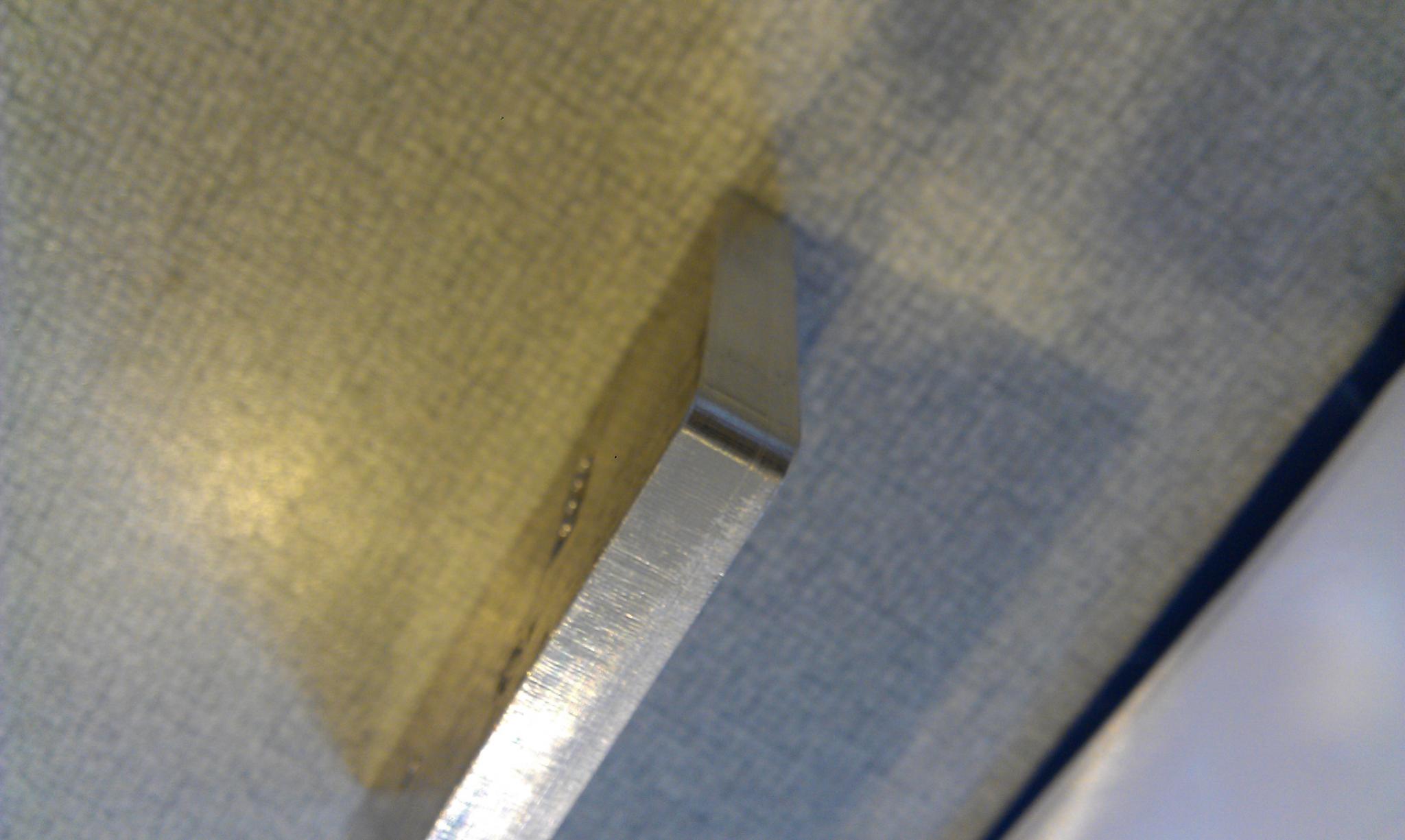

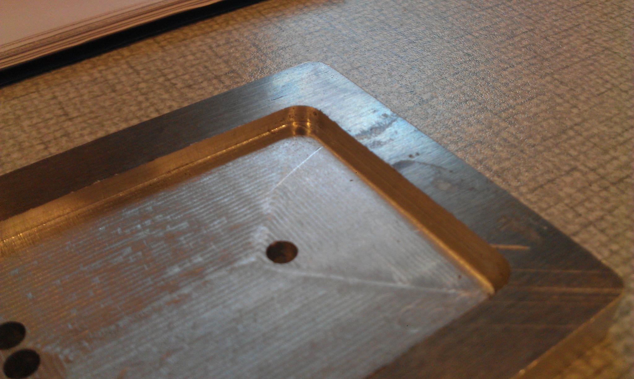

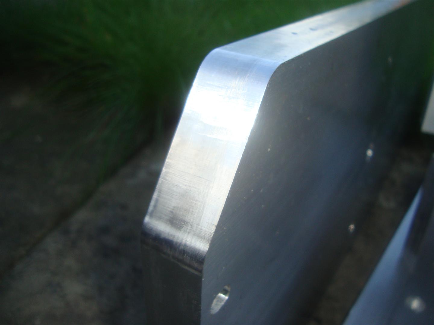

    I did take it very easy with that cut. Depth of cut was only 0.5mm, step over was 20% which would be just under 1mm and feed speed was 10mm/sec for that cutter was 10mm/sec. The only cutter I was was not new so I did go slowly with it. The alu also has some hard sections in it so that was why the cutting fluid was generously applied. The starting point was a mistake, I for got to set my dxf to 0,0 in cad and I think cut2d picked that up.
    I have had a look at the program file and cant see any G64 codes in it. Youll need to excuse my ignorance in G codes at the moment, I havent got round to learning them yet!!
    Some photos are attched of the cut edge. Quality looks good for an old cutter.

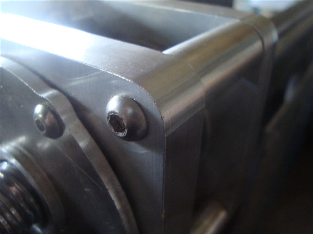

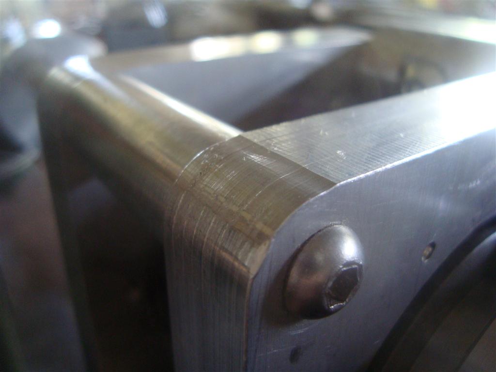

    Whether or not you get a wavy line/arc depends on the direction of cut (climb/conventional), the cutting force and the friction of the slides. Either way you will get a 'blip' on the corners, or wherever any axis changes direction. Here's an example:
Name:	DSC08512 (Medium).JPG
Name:	DSC08514 (Medium).JPG
    The corners should be smooth, but as you can see each corner has a line/offset portion where the axis changed direction. For that part it doesn't really matter - it's still shiny
    That was on my milling machine which currently has more than it's fair share of backlash.

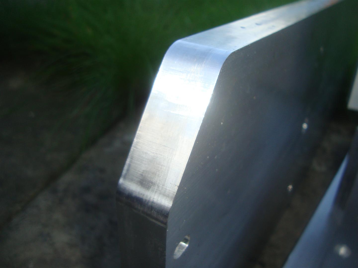

    This part was made on my router which has very little backlash, so the corners are smooth with no 'blips':
    Hi Ian,
    Congrats on your first Hot Chip's. . . . . . . (Now the BUT.:lol:)
    I think your single spindle mount is causing chatter/resonance looking at the edges I can see chatter lines.!
    I know you say the cutter was old but that does look more like flex chatter..? Also when cutting it sounded ringy more like a resonate ring not a blunt cutter.
    Too little DOC, too slow spend n feed or more importantly wrong chip load can be just as bad for cutter than too much, esp in sticky Ali. Don't be shy give the cutter some work to do as your going far too conservative. . . .Heat is the enemy so send it away with the chip.!!
    Just what I was thinking - the vertical lines are a bit of a give-away.
    Definately too low feed and stepover - with only 20% stepover you need to feed much faster to attain the same chipload, look up chip thinning. This explains some of it, though it is aimed at making you buy the program...
    http://www.cnccookbook.com/GWCalcFeedsSpeeds.htm
