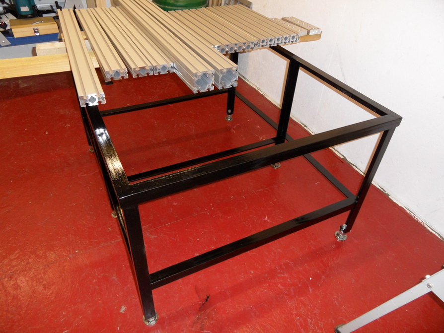

    Some of my parts have arrived so its time to get the build started. The bed frame is 1250mm long by 1065 mm wide. It will be running on linear rails and bearings with ball screws driven by NEMA 34 motors.
    The whole assembly will sit on a purpose built angle iron frame with adjustable feet to level it.

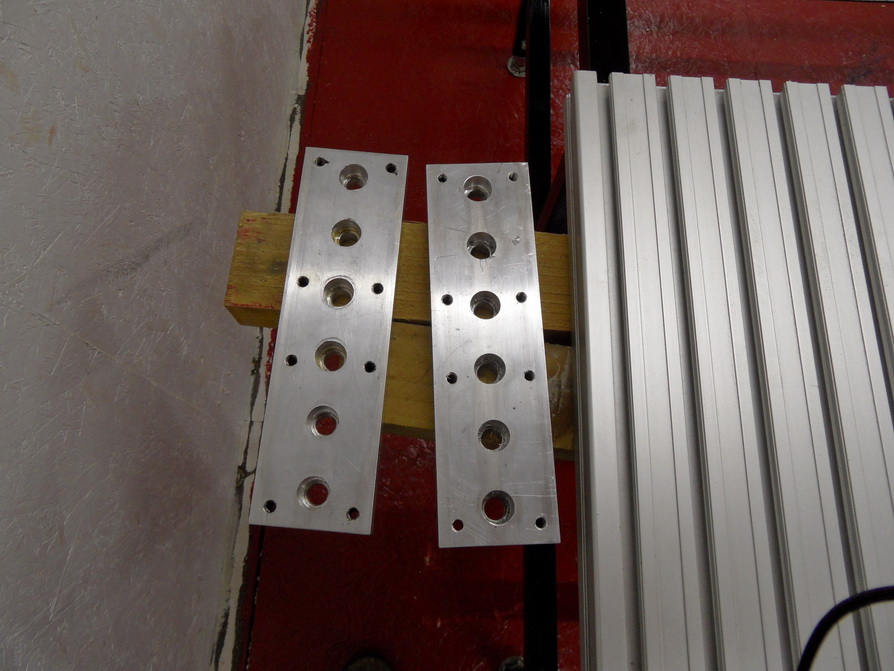

    Pics 25, 28, 29, 30 show the extrusion and the built base frame with part of the linear rail attached. 26,27 show the bearing riser plates and the y-axis risers. 14 shows the bearing mount plates and the risers and 16 shows how they fit together.

    Hopefully tomorrow I will finish fitting rails for the x-axis and get the bearings and mount plates fitted. Then I have to work out the mounting plate for the frame to fit to the base which will also mount the motors and the ballscrews. If I can get that done tomorrow I can get them cut out on the Laser at work Monday.

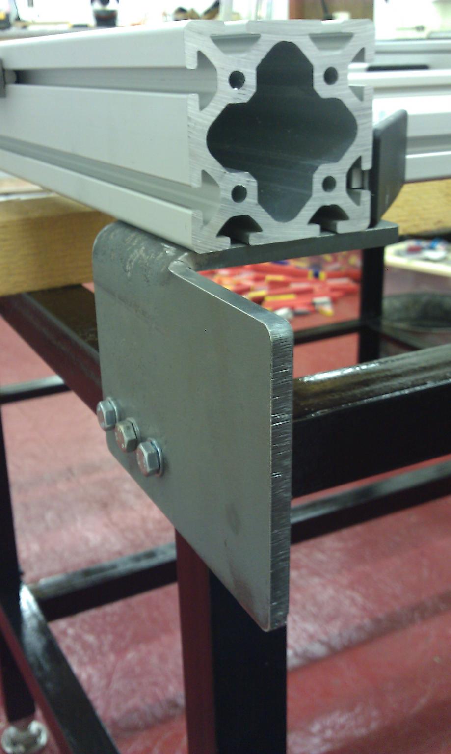

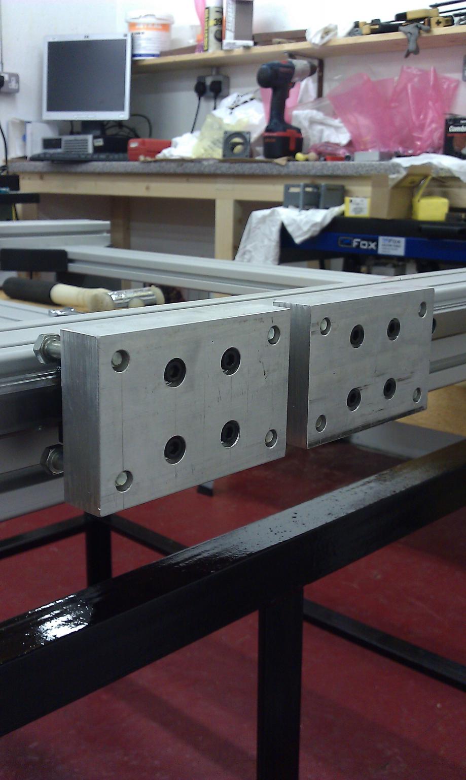

    I managed to get my motor and bearing mounts drawn up and cut out and flanged. They have been fitted and are ok. On the first photo the top flat part of the mount is lying slightly at an angle. I know that the brackets are accurately flanged so I can only think that the angle iron of the frame is slightly twisted. I have gone round all sections of the base frame with a level and it matches the frame so it appears to be level.

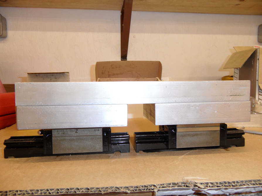

    I also got the chance to mount the y-axis risers as well so that I could get an accurate measure to get the y-axis bars cut. First photo shows the bearing blocks mounted on ther bearings.

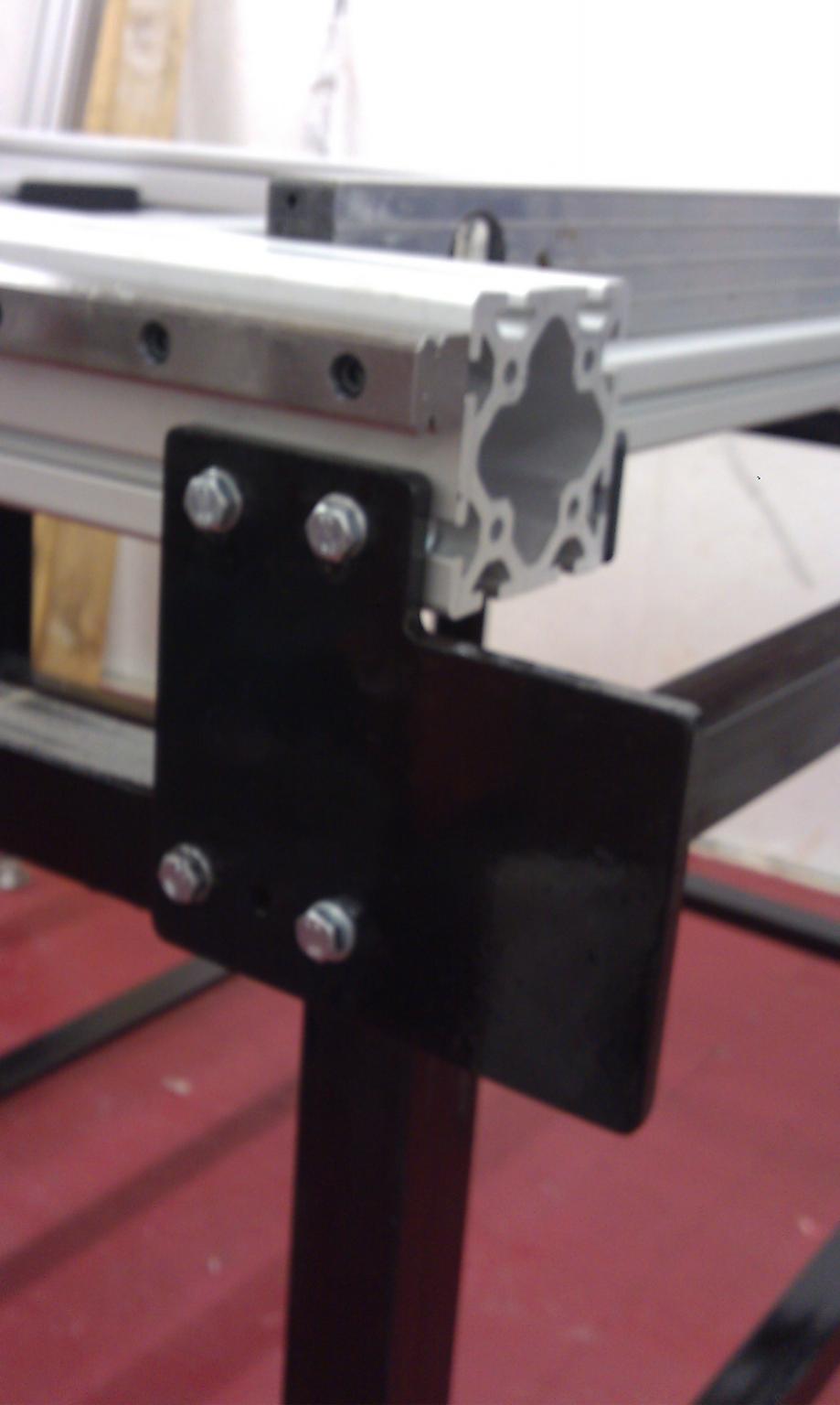

    I decided to change to motor and bearing mounts to straight plates. Got them made and fitted and levelled the frame up again.

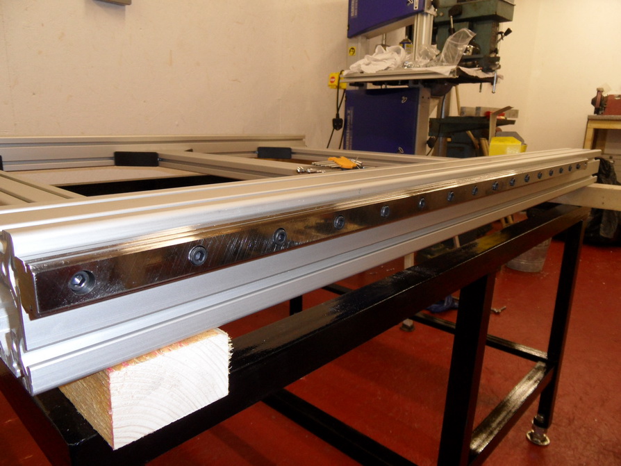

    Also managed to cut and fit the rest of the X-axis linear rail.

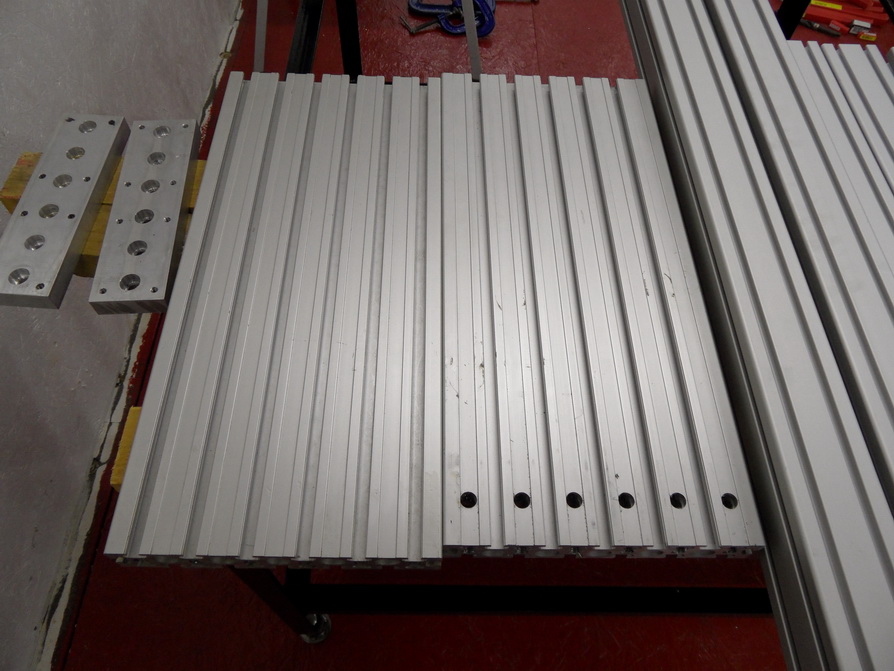

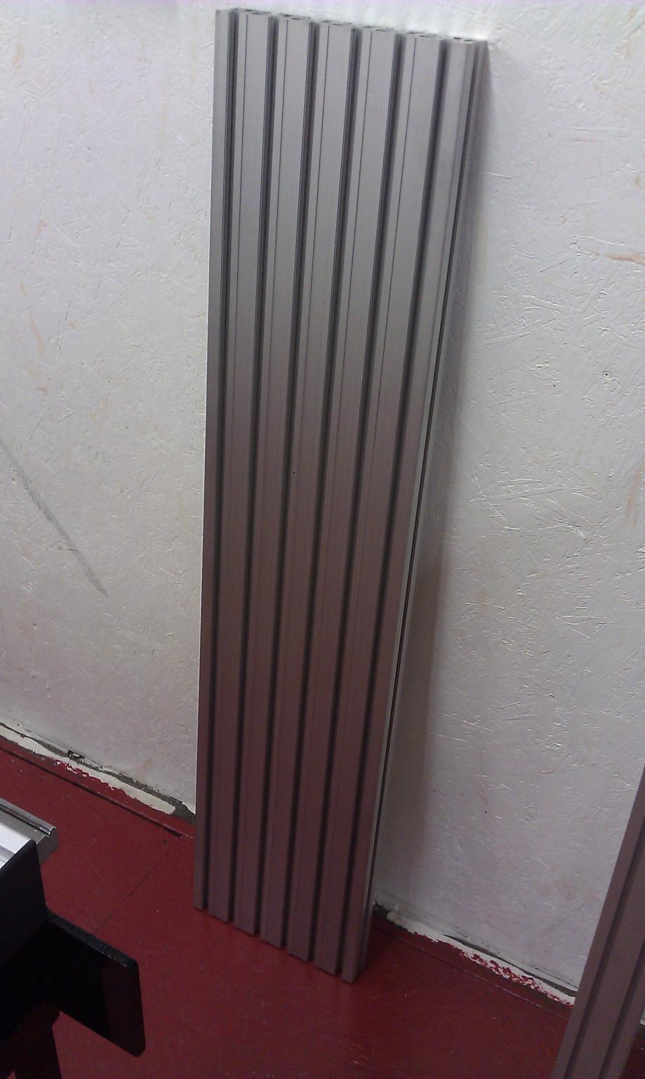

    The Y-axis extrusion arrived this week as well.
    I need to set up the Y-axis on the floor of the workshop to see where to drill the riser plates to take the Y-axis extrusion. I also need to see where I am going to fit the motor mount and then see where, if anywhere, I need to cut out a notch from one side to take the ballscrew. When I get that done I can get them fitted and it will start to look like a machine then. I also picked up my steel enclosure today to take all the electrics so I suppose I can get that started while I wait on the ballscrews to get machined.

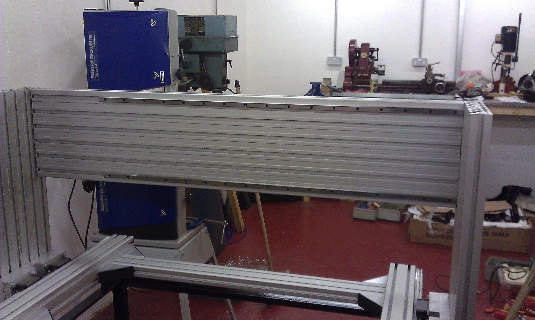

    I managed to drill and tap the Y-axis riser plates and the Y-axis beam.
    Have them refitted to the machine and have also fitted two sections of the linear rail.
    Tomorrow I need to thread some of my 12mm setscrews to make the thread longer and I need to make a 3mm spacer for the Y-axis beam.
    After that the next job is the Y-axis motor mount.

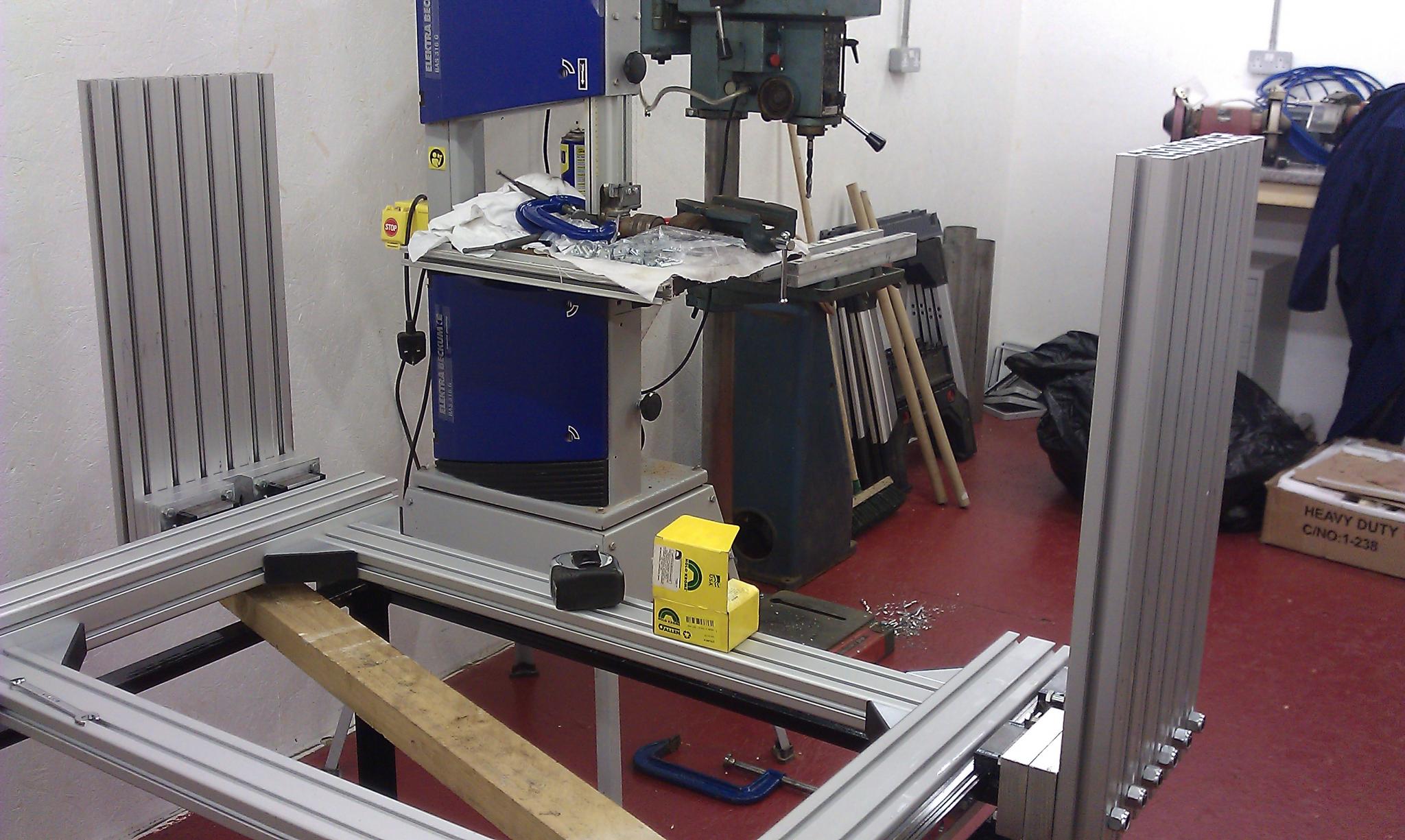

    Ian,
    Interested to know what facilities you need to put something like this together. I see from the last pic that you seem to have access to a bandsaw, small vertical mill, and an ML7, but somewhere you also mentioned access to a "laser" at work! What do you reckon the minimum set of kit is to start a build like this? Something to cleanly cut the long sections to length squarely, then relatively small turning and milling jobs?
    Thanks,
    Brian
    Brian,
    I ordered the aluminium extrusin already cut to the lengths I needed. The best way to cut ali is a cold cut with a slow cutting saw similar to a wood chop saw. This leaves a nice finish. If you get everything cut to size them you just need tools for assembly. My bandsaw is only used for cutting timber before going on the wood lathe. Whats behind it in the picture is my old Meddings floor standing drilling machine. Its old and a bit noisy but does a very good job. My ML7 I class as a toy lathe. I'm sure I will probably upset a few people with that comment but thats my opinion. I have access to a colchester student at work which is much better but a bit worn and also a bridgeport milling machine. I look after a 3KW cO2 laser at work so I can usually manage to get some small jobs done like my motor and bearing mounts.
    If you are looking for a lathe I would recommend trying to pick up and old one in good condition. Not too sure about the smaller milling machines but I believe the Warco ones are good. Add a decent socket and spanner set and a good quality set of allen keys and various drill and taps.
