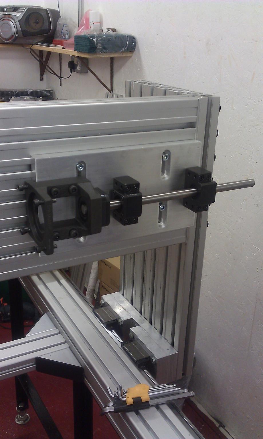

    I have the ballscrew for the Y axis and have fitted the ballnut and mounting nut and the end bearings and it is just sitting on top of the frame at the moment for me to get some measurements. Next job on Monday is to mill a spacer block of aluminium 95mm x 75mm x 16mm thick to go between the ballnut mount and the Z axis frame.
    The Z axis took quite a bit of work to get right. After it was made and assembled I ended up with about 1.5mm of movement in the screw from end to end so it had to be taken apart and a new spacer ring made to suit. Once this was done and re-assembled there is no movement at all that I can see so I`m happy with it now. :dance:
    Ian

    I have assembled the X axis ballscrews, nuts and mounts. Made up the spacer blocks and got them all fitted and set up.

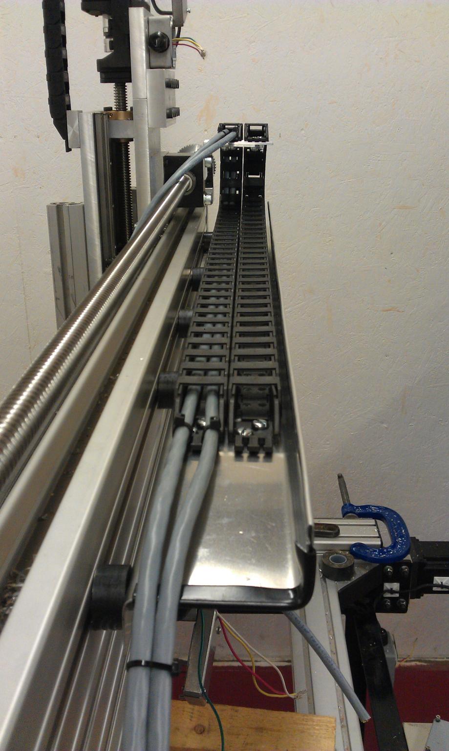

    Update time. I havent had much time again in the last few weeks but I am getting there slowly. I have managed to get some work done on the electrics now.

    I have fitted the limit switches and have most of the wiring in place with just some tidying to do. All motor have been connected up.

    Drag chains and supports are fitted with wiring in place and the cables are glanded into the panel.
