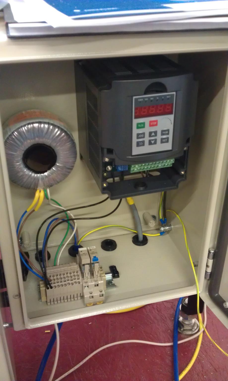

    Again I have not had much time on my build lately but I have managed to get afew things done. My workshop pc died a couple of weeks ago but I have now managed to get another one up and running. I have had the machine moving about with it again. I have started to get some work done on the spindle wiring.

    I need to get this finished and get the interlock from my cooler done as well before I try to run it.
