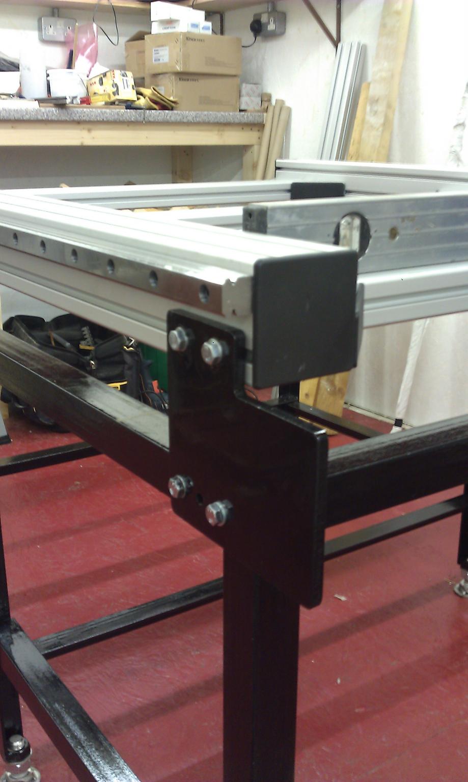

    I managed to get my motor and bearing mounts drawn up and cut out and flanged. They have been fitted and are ok. On the first photo the top flat part of the mount is lying slightly at an angle. I know that the brackets are accurately flanged so I can only think that the angle iron of the frame is slightly twisted. I have gone round all sections of the base frame with a level and it matches the frame so it appears to be level.

    I also got the chance to mount the y-axis risers as well so that I could get an accurate measure to get the y-axis bars cut. First photo shows the bearing blocks mounted on ther bearings.

    Unfortunately I havent gotten much work done on my build over the last week.
    I decided to change to motor and bearing mounts to straight plates. Got them made and fitted and levelled the frame up again.

    Also managed to cut and fit the rest of the X-axis linear rail.
    The Y-axis extrusion arrived this week as well.

    I need to set up the Y-axis on the floor of the workshop to see where to drill the riser plates to take the Y-axis extrusion. I also need to see where I am going to fit the motor mount and then see where, if anywhere, I need to cut out a notch from one side to take the ballscrew. When I get that done I can get them fitted and it will start to look like a machine then. I also picked up my steel enclosure today to take all the electrics so I suppose I can get that started while I wait on the ballscrews to get machined.
