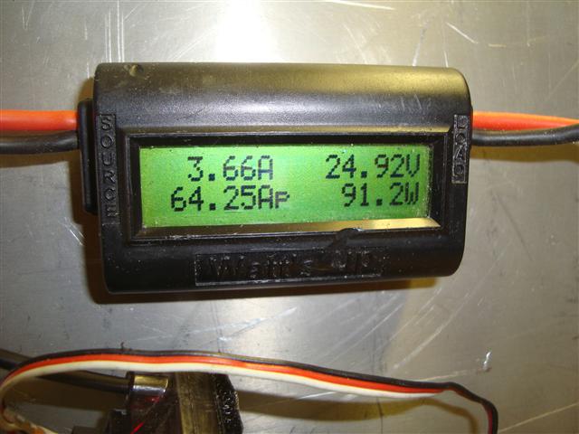

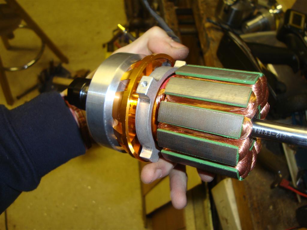

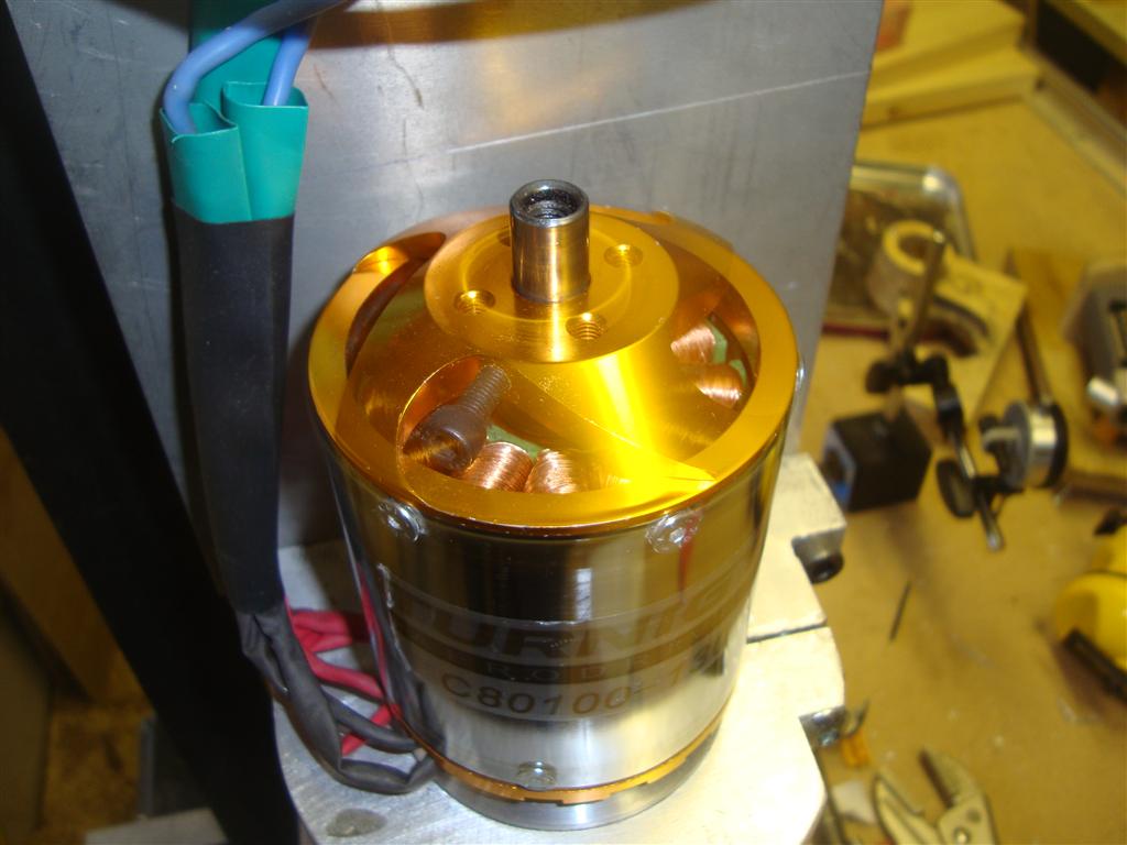

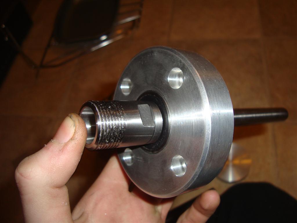

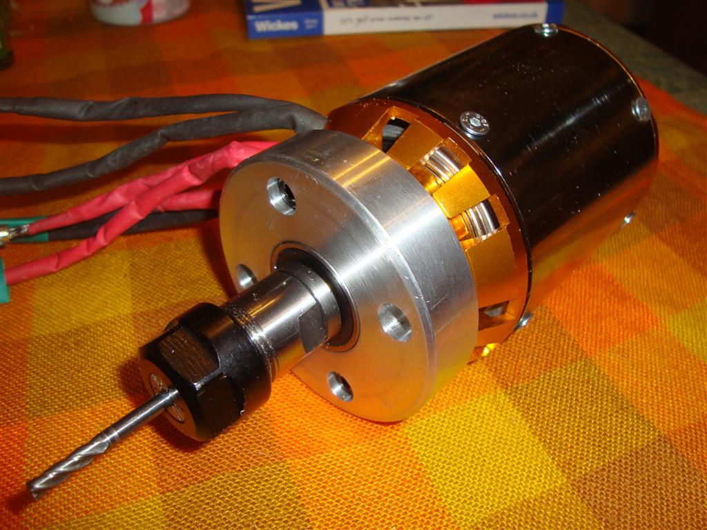

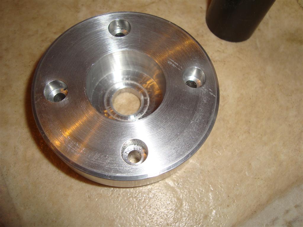

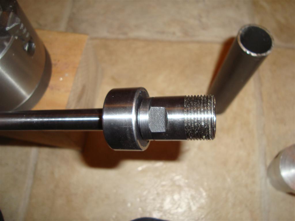

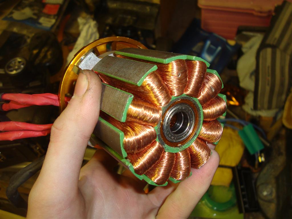

    Heated the angular contact bearing in oven, cooled the shaft and it dropped straight on.
    Bit of a fiddle to get the rest together, but it went ok.
    I've run it up to 3100rpm (24v) and it sounds fine. Slight noise from the bearing but I don't think that's significant.
    I also measured the runout and it's less than 0.01mm.
    Will post some more pics in a minute.

    It's alive!
    Will post some pics in a minute.

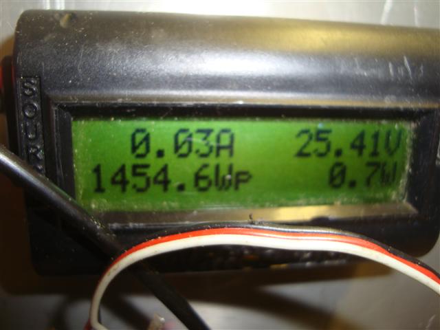

    Make a walnut what?! But yeah, running it off two 12v 92Ah batteries for the moment. Not got a power supply which would supply anything like enough for this. Idling at 3100rpm it consumes 94w. 45w ish at 1500 rpm... that implies almost 200w just to spin the thing at full speed let alone cutting!

    94w
    owch, but as M250cnc phil said to me not to long ago"give your bearing a chance to run in at low (ish) speed before you start flapping about heat" or "drag" in your case
    im getting on fine using 350w 12v on my 1700w motor, i dont think you will need to throw 6000w at yours if your using it on your router

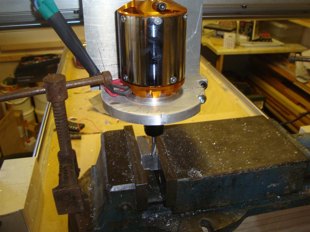

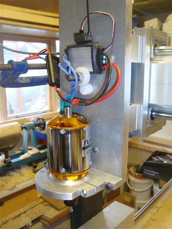

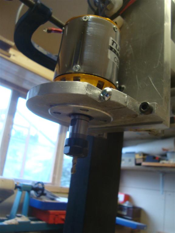

    I did the mount today, not the neatest of things I've made with the rotary table but it works:

    Spinning...nice effect:

    I ran the motor in for about 5 mins on 12v, soon got bored of that (I'll leave it running properly tomorrow). So I tried carefully grasping the motor body with some kitchen roll to protect my fingers - couldn't stall it, not even close . It merely drew 550w and about 53 amps. I'll have to think of a safer way of testing the power at higher voltages.
    (Picture tomorrow)
    I was under the impression your mill was under cnc control why the RT ?
    Its a temperature thing if it doesn't get hot just keep increasing the speed in increments.

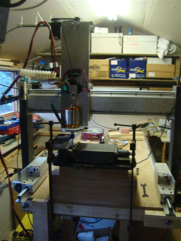

    I took the steppers off the milling machine and put them on the router. Didn't want to put them back just for one part. Rotary table was also the most accurate way I could make the hole for the spindle, not having a boring head.

    That's good, the bearing didn't get hot at all. ESC warmed up a little but that's all. I'll leave it running on 3100rpm for a while today and see what happens.

    I measured the runout again now it's mounted properly. I put a 10mm cutter in and measured 0.03mm about 10mm from the collet. If I put the DTI on the collet chuck itself it reads 0.01mm.
    i wouldnt worry about it jonathan, just use it as you would and keep tabs on how hot the bearing housing gets, i still check mine now and again as im using them, its ony my high speed spindle that shows any signs of struggling and thats only if i push it to 30000/40000 rpm
    phils point is confirmed as all three spindles produce less bearing heat as time goes by

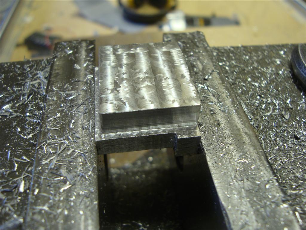

    Just tried cutting with it. 7mm two flute cutter and some scrap aluminium. Using 0.5mm depth/width of cut it was happy. Sometimes 1mm, machine is a bit too wobbly to do more at the moment. I'll post pictures in a minute to save a thousand words...

    The motor drew 30w extra whilst cutting, 100w idle.
