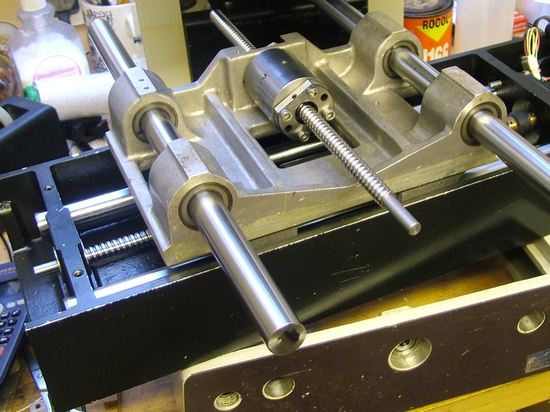

    Me again
    I replaced the 20mm linear shafting and it certainly tightened it up.
    Replaced the X, Y ball screws and doubled up on the nuts to add a 1kN preload :naughty:
    The ebay M8x.75 half nuts I bought on Monday haven't arrived. Can't thread the ballscrews 'til I have the nuts or it suddenly becomes guesswork for the length and die closure.
    A very nice man at bellevillesprings.com gave me half a dozen washers to preload the thrust bearings. Their £15 minimum order translated in to 150 pcs :whistling:
    The metal for the splash guards did arrive so I will probably start on that.
    Pic is the bed and saddle upside down.

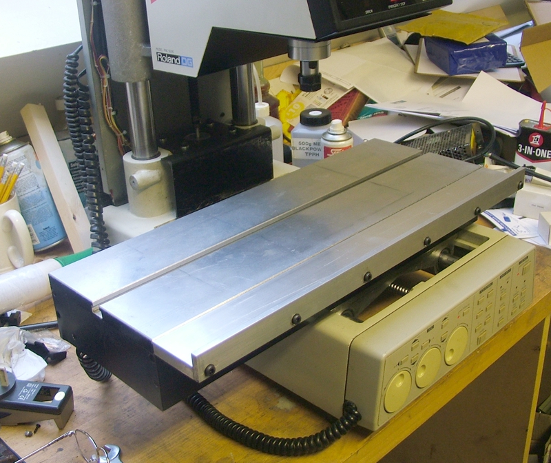

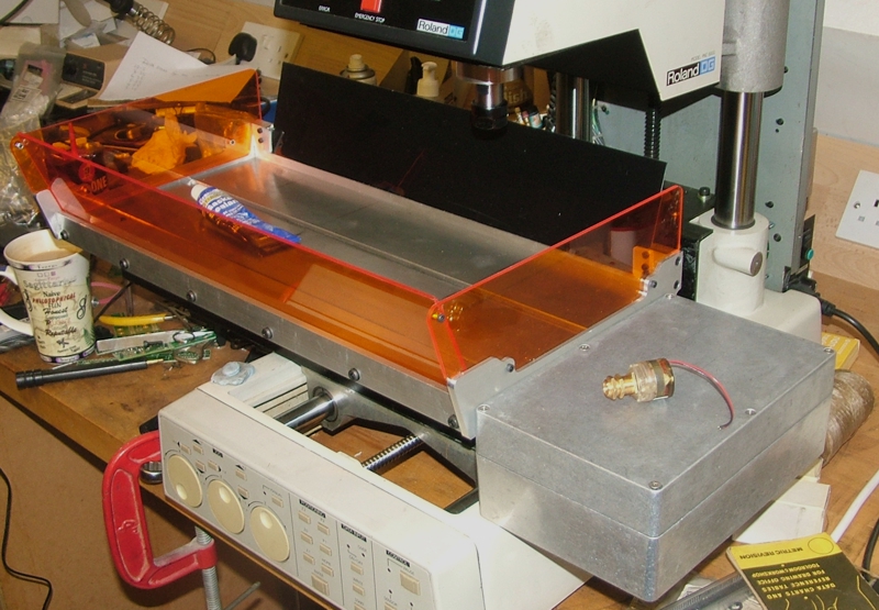

  4. #24
    Me again
    Splash guards fitted and looking a bit '70s retro.
    An IP65 sealed box bolted to the right hand end is the suds tank, I'm using the Tee slot as a gutter.
    Next, sealing it with gasket compound and cutting some slots in the bed so I can fit tee nuts from above and improve the drainage.
    Robin
