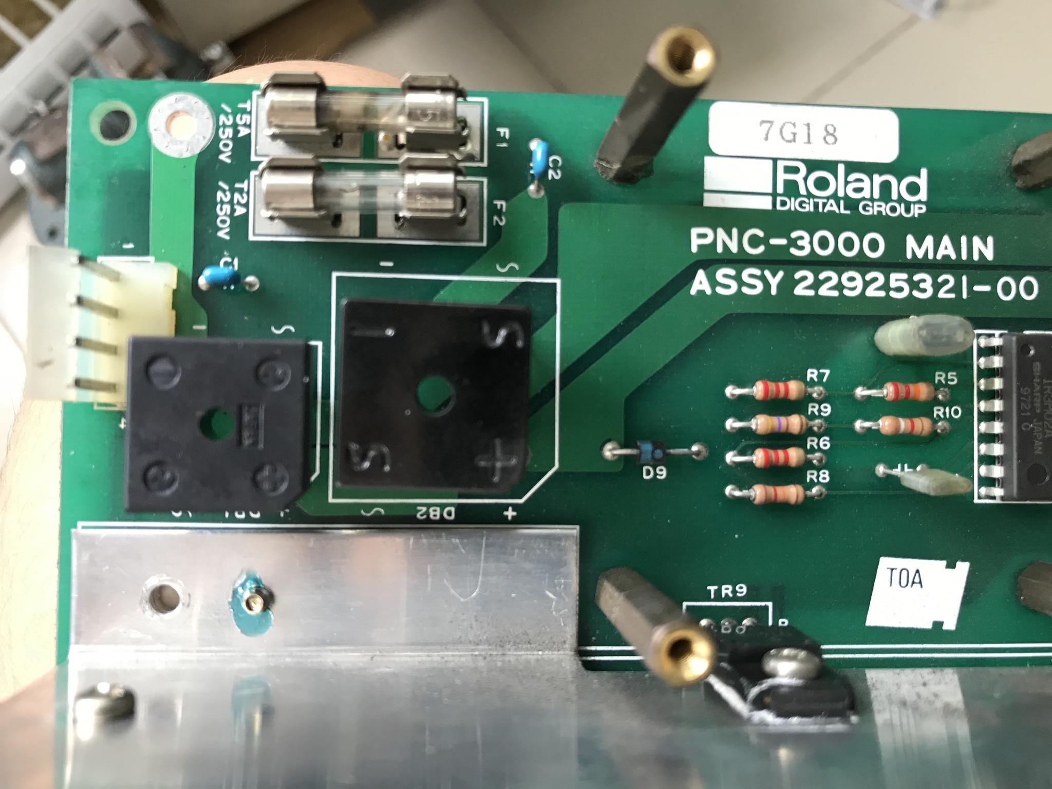

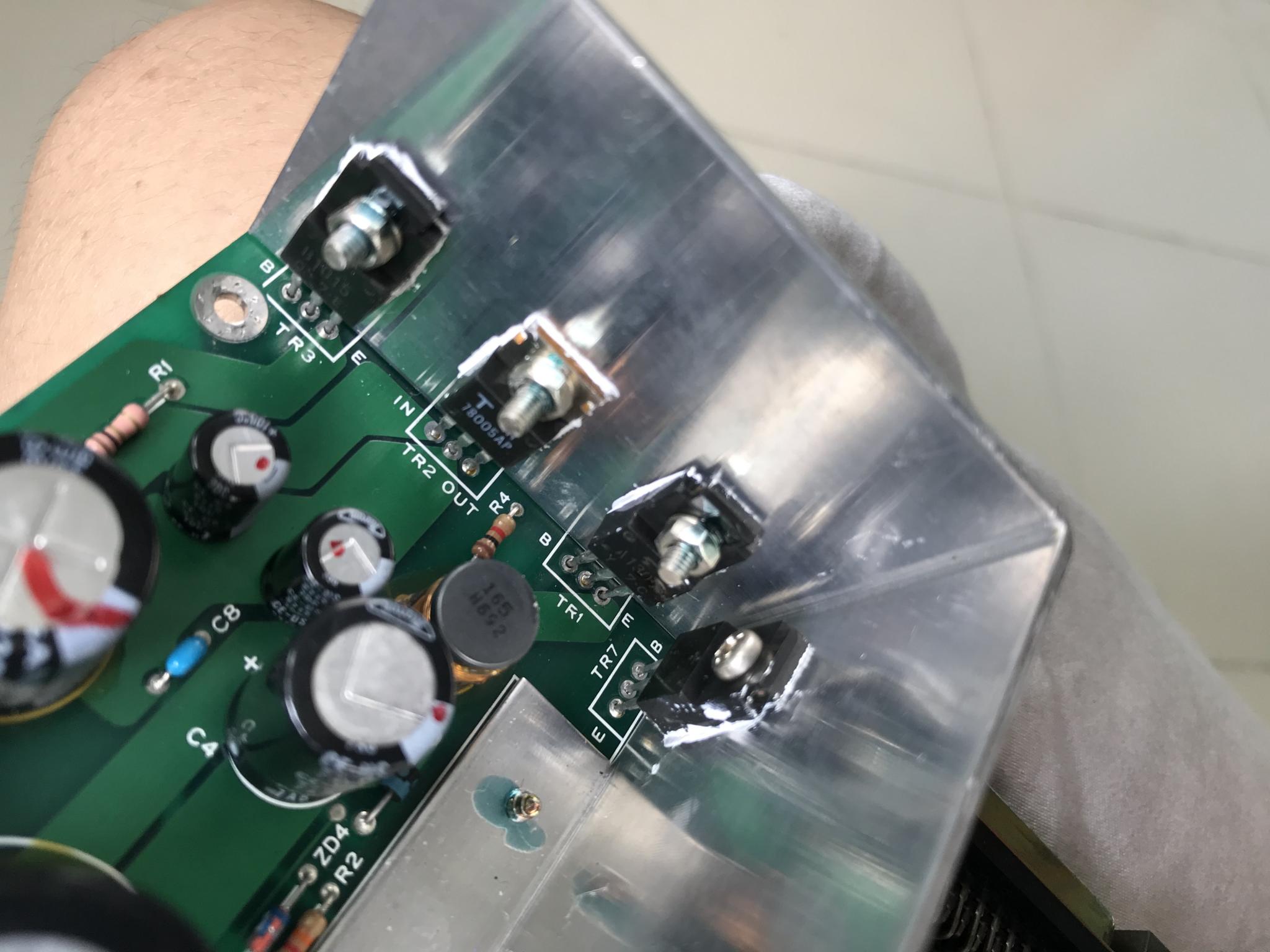

    [I have a more important problem now. I removed 2 Roland pcn-3000 chips on board and reassembled them wrong. Exploding fuse and exploding mosfer . I'm very sad and don't know if I can fix it
  3. #53
    the fuse has blown

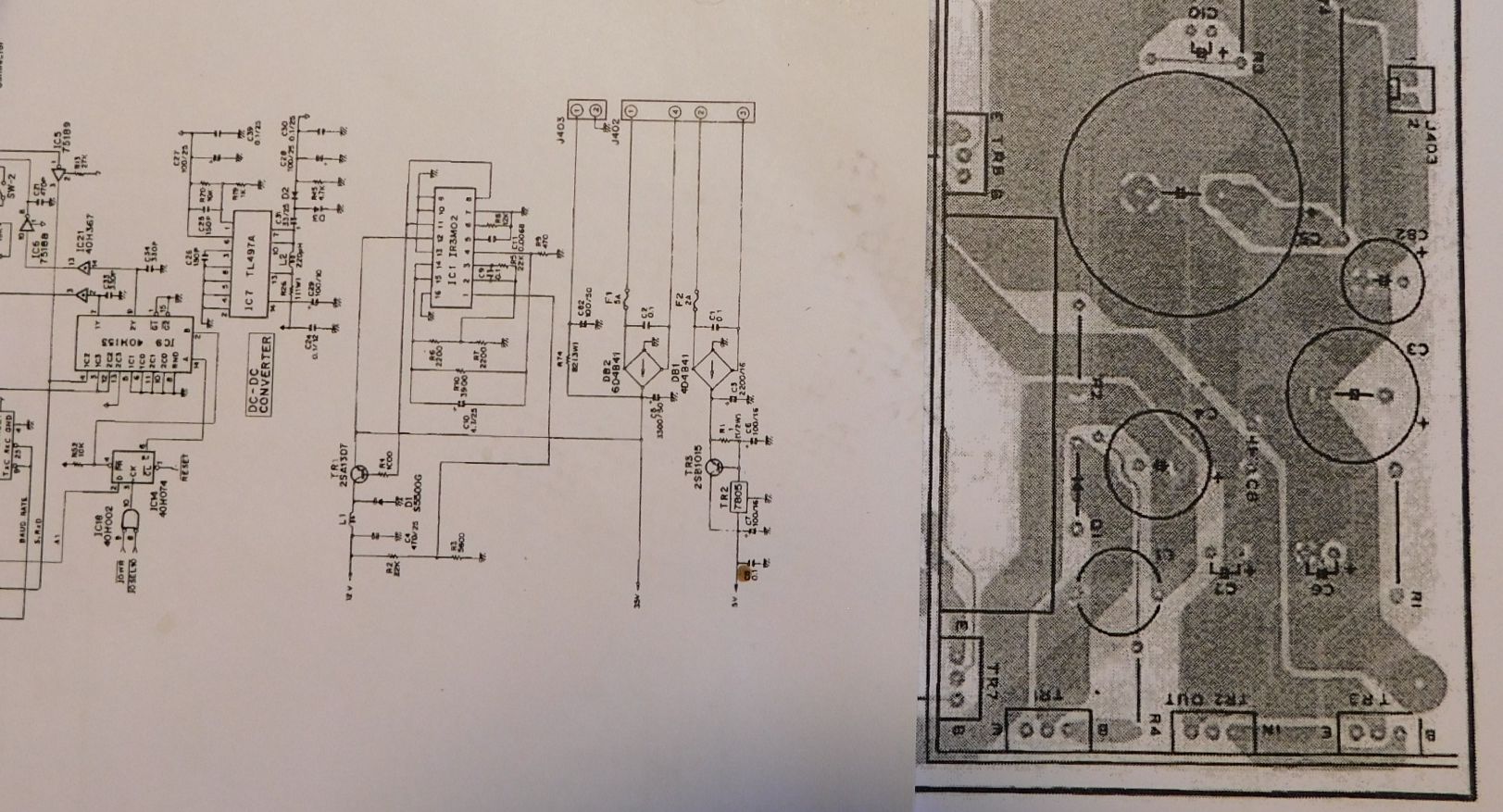

    Does this help?

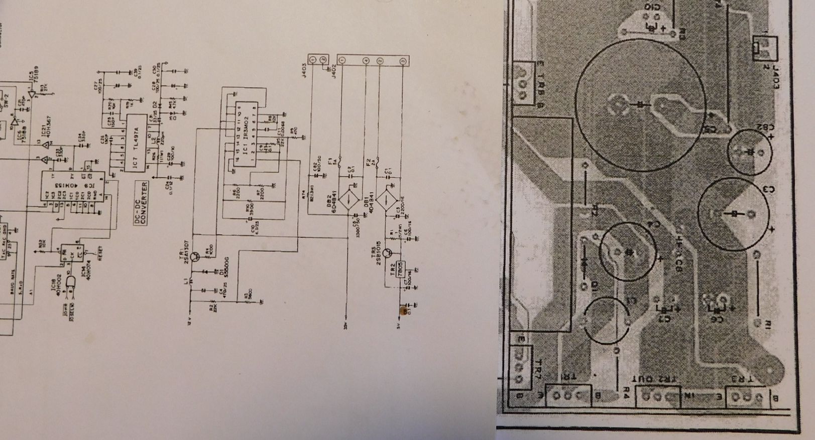

  5. #55
    Does this help?

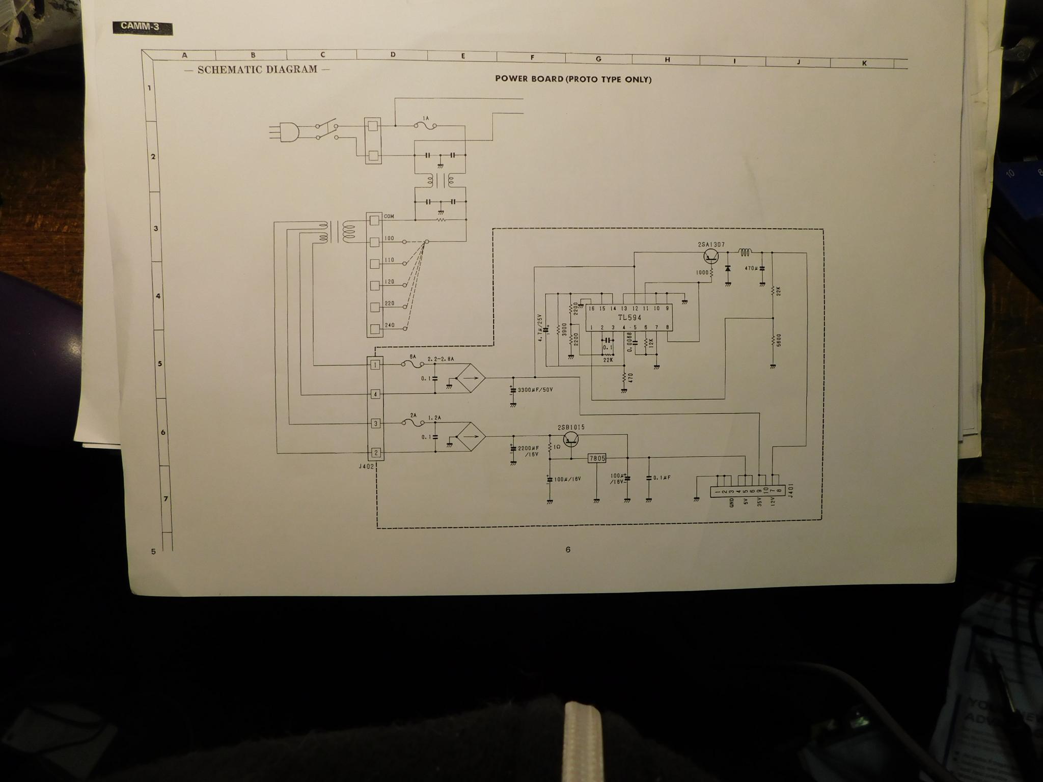

    Hi Robin, I have a Roland PNC-3000 machine, and I am working on trouble shooting some issues with it. Currently, the motor PCB is not receiving the necessary 12V supply voltage. When I supply the 12V using an external supply, the motor can be switched on, but I have been unable to figure out why the motor PCB isn't getting 12V. Another issue I am having is the spindle speed display is not working. Could you please send me a picture of the relevant circuit diagrams? Are the manuals and circuit diagrams available online somewhere?
  6. #56
    This is the PSU, the rest would need some considerable finding and sorting out.
    The spindle speed starts with a reflective sensor looking up at the bottom of the front pulley and connects to the PCB behind the speed control knob and to a rather primitive bar graph on the display panel.
