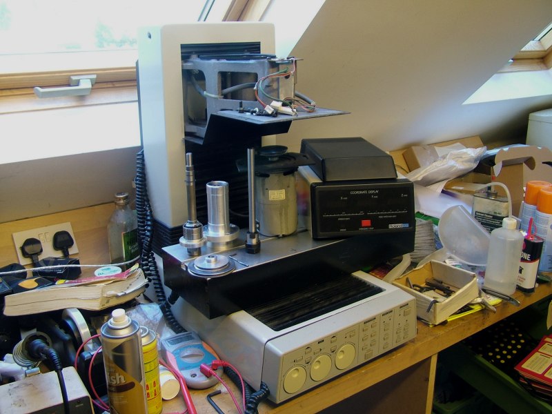

    Still waiting for bits to do the new spindle. Bought the Ampflow E-150 DC motor and it looks delighful. Slightly concerned about how much heat it can dump into the metalwork without overheating, may need an extra fan. It's rather apart at the moment, you can see the 35mm round rails supporting the head. Feels fairly solid

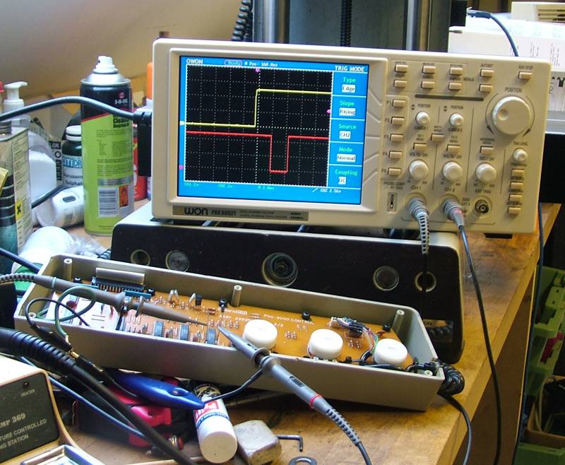

    It's been driving me spotty, but I think I am now convinced that it's the X,Y,Z position display that is wrong not the steppers. Time to give up on the displays and do some CNC type moving.
    With my harum-scarum step sequence the counter stays 100% in synch with the steppers.
    With my everyone moves together routine the displays are out one count per shift.
    Makes not a lick of sense to me.
    Pic is the encoder output. When you turn the dial one click you get a 1.25mS pulse. If direction changes you see the direction line (yellow) go 1.25mS before the pulse. This is surprisingly convenient when you are sampling at 1KHz to get 5mm/s at 200steps/mm. The motor will happily slam in to reverse at 5mm/s. Another clue that their 500Hz double step was a ghastly bodge to overcome a problem with the display :naughty:

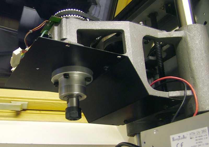

    New motor and ER-16 chuck fitted. Used cheap bearings which are running noisy and a tadge warm, I'll give them a few hours and if they don't settle down and start behaving I'll have to shell out for something more up-market :whistling:
